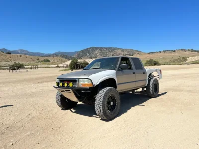

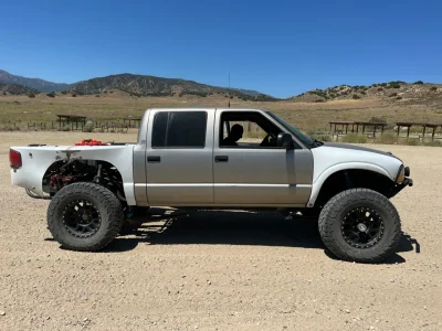

I made my own mounts for the 4.3L and they are on the ford part of the frame. So I'm anticipating having to make new mounts that will also be on the ford part of the frame lol.
Nope, no firewall cutting is required. The 6.0 is only a few inches longer than the current motor. the core supports on these trucks are pretty deep, so I'll be hollowing it out to move the radiator into the core support, and probably going to electric fans.
