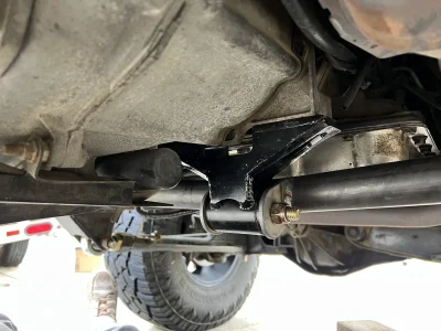

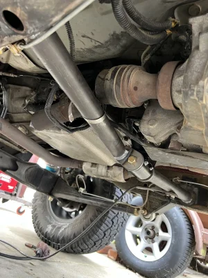

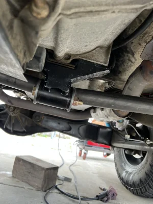

Spent the morning welding up a solid trans mount and trans cross member. Drained the trans oil and popped a new oem filter in while I had some room.
Tomorrow I’ll set up an ez-up and rewire the bumper lights, get a slightly longer serpentine belt (new 220amp alternator has a larger pulley), load up all my tools, and I should be ready to rock for the Mojave Rd run this weekend. Stoked!

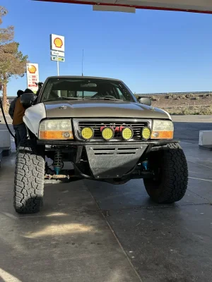

Ran the Mojave Rd trail this past weekend and laid down 215 dirt miles, about 700 miles in total round trip. Truck worked flawlessly the entire time, but it's time for an LS and 4l80. Hopefully I'll find one and drop it in over summer. Some 3.0x14" IBP for the rear would be cool, too.

You're going to do you...
But I would ask this question. What is going to make your truck faster. A better shock package or a bigger motor.
I'd always choose shocks and get that dialed in first.
I absolutely LOVED watching this thing work the dirt! So much fun following 20ft behind you through the Joshua tree forest and the 12 mile whoop section at 50-56mph.
Super stoked for you and how cool this truck is!
I'm focused more on what's going to make the truck more reliable. This motor was rebuilt by the south of the border family I purchased it from, and it leaks quite a bit from the timing cover and oil pan (oil pan is an easier fix). Rather than pulling the front end apart and fixing the valve cover leak, I'd rather just pull the motor and put something better in.
The trans has always given me issues since the rebuild in terms of the torque converter always wanting to lock up, but then quickly unlocking. I'm always modulating the throttle to get the right RPM and load on it to get it to stay unlocked. Holding the brake slightly works, so it might be a brake switch, which I have sitting in the garage. Regardless, the 4l60 trans sucks overall. I'm not necessarily looking to make truck faster via the v8, but to make it easier to drive. The looooong sandy uphills sucked. I was stuck either wringing out second to maintain speed (ran out of gearing) or shifting to third for it to bog and lose speed.
Thanks Ryan! It was a great time! Can't wait to keep refining it as you all have done over the years
