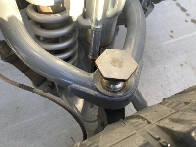

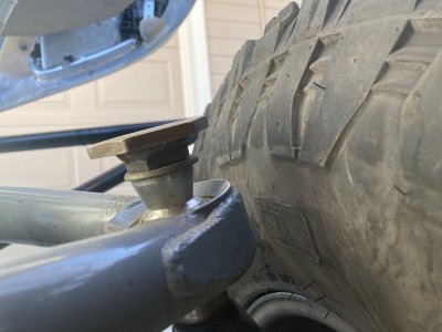

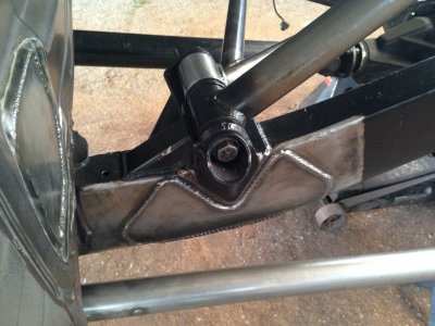

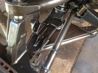

It’s just a pice of 1/4 plate that I drilled a hole in the middle and spot/rosette welded to the top of the bolt head
BUT I was using it to tighten the bolt and it kept breaking the weld so now I cut a hex pad that is spot welded to the head of the bolt and welded on the bottom side and no problems since

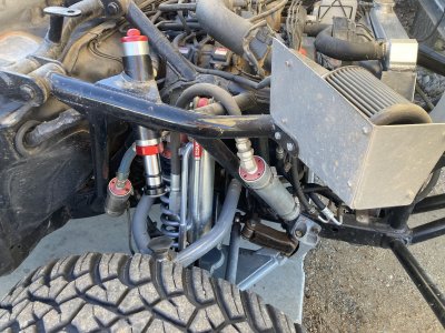

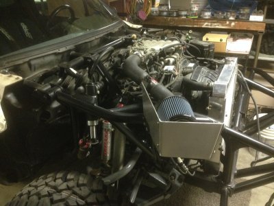

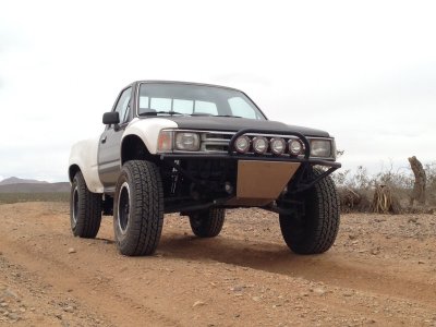

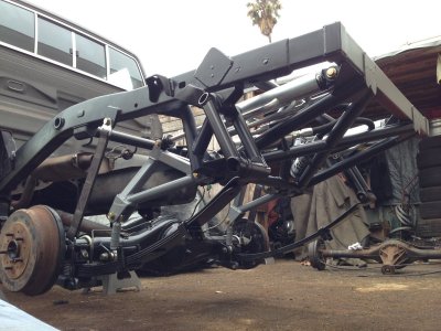

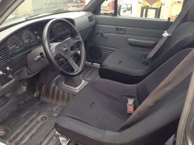

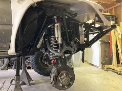

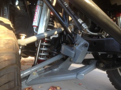

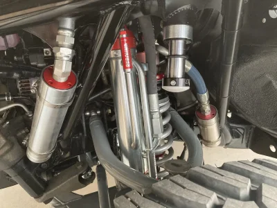

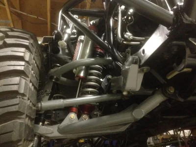

Thanks, yeah that 4runner worked so good for the amount of shock and wheel travel it had
Did a lot of work making all the suspension pivots super strong front and rear and a lot of time on shock valving
The V8 and weight over the back end was a magic combo
Inside it was completely stock and quiet, prob should have had a roll cage for safety though
May post a build of it, had a build thread but photobucket links got hijacked
