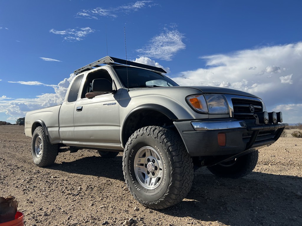

Or go complete sleeper and build a little tacoma like @Camper shell fun did can just make them all sad...

Yeah I went to Baja with my friend Trevor and his 3rd gen taco with TC +2 Kit and rear shock setup and it worked awesome and looks like a lifted truck is all.

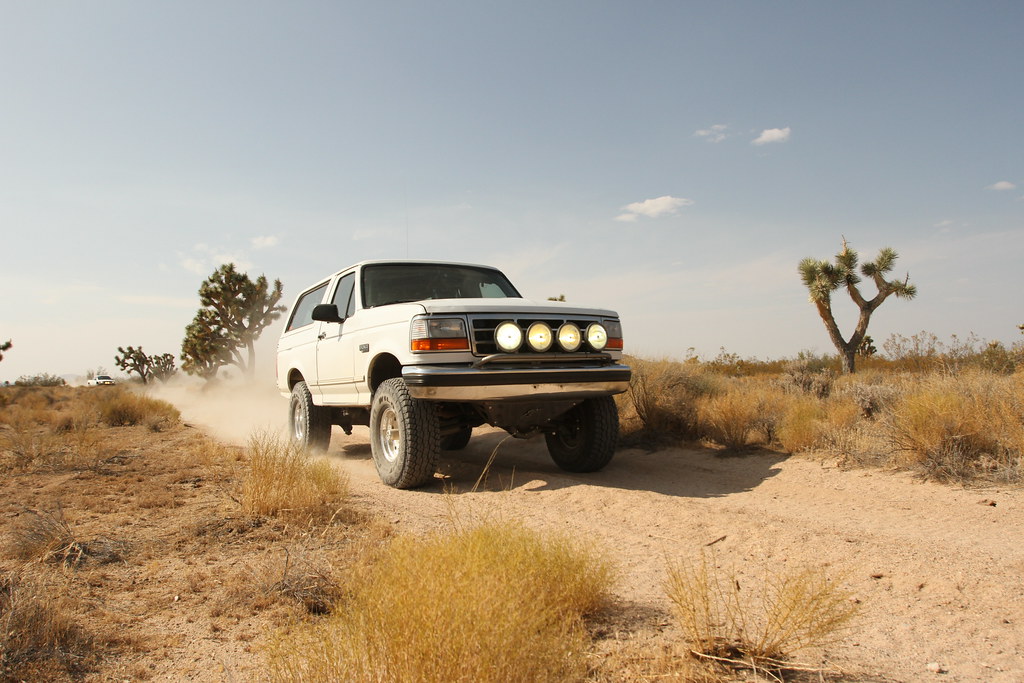

90's Bronco's RIP! We beat the living shit out of these and stock width we are getting 18" of travel.
