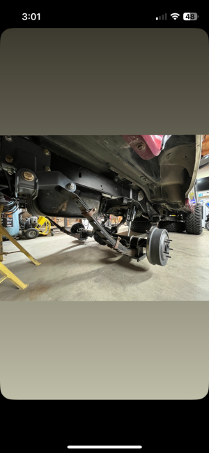

I vote bronco, explorer or OBS f150. I did +2" beams and have 18" of usable wheel travel with working 4x4. Out back is @Giant Geoff spring under kit on a stock width rear axle and 12" shocks cycling about 16" (more if I notched the frame). The best part is it looks completely stock to the untrained eye. Also our stock Bronco prices are criminal over here as well.
Have just been exploring these options a little bit more and starting to seriously consider an OBS F150, what does your front ens setup consist of? That's a good looking Bronco mate!

Just some home built beams and radius arms and a single Fox 3.0 with a 2.5" bump. Very basic
