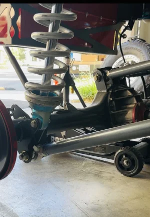

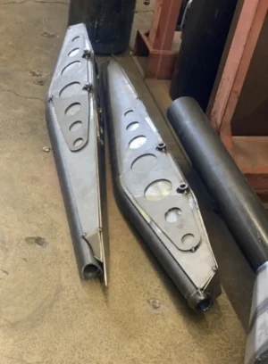

I can post up my numbers later today but what I do know is a 1400 ranger I worked a bunch on had the upper link mounts INSIDE the factory boxed frame rails. First test it taco’d a 1.75”x.120 4130 upper link. Rebuilt them out of 2” .250wall but it would kill 1.25” Heims every 200miles and was peeling the top of pro-am housing off. Pocketed the link mounts into the frame and solved all the issues for 6k race miles. Still manged to destroy a 2” .250 wall upper link in a rollover. I was impressed the 3/4” RPI bolt didnt bend

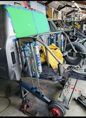

I've only built Toyotas and mounted the lowers to the outside of the frame and the uppers to the inside of the frame which is about a spread of 44in lower and 36in upper spread. Never had an issue with 1.2 heims wearing out or 1.75x.120 DOM links bending but also haven't raced or rolled yet. My latest redo moved both to around 39in for better lower link clearance and upper link mount strength. Long upper links with the front upper mounted low make the rear end feel numb and un-responsive to power inputs which is nice for a comfortable cruiser. Short uppers mounted high in the chassis give you the ability to lift the front and carry over bumps.
Short course deviant styles are used for cornering traction and tight roll center control while the classic desert style has proven itself as king of durability.
I view all this dumber than a lot of people, I’ve done so many that I’ve found more important aspects to focus on that makes a bigger difference and gives me more success.
8 important points to focus
on when doing a 4-link to make setting up easier:
  1. never mount the shocks forward of centerline on the overall length of the link
  2. Always Mount lower Link directly below the housing to relieve and take out Torsional load applied to the uppers so it’s more relaxed
  3. Shocks mounted in the center of the arm gives you proper leverage for comfort, or you can move the shocks closer to the axle for a more nimble feel.
  4. Mount Lowerly closest to the brakes before tire bulge gets into the link arm to reduce sway and create more shock clearance from the frame
  5. Make the upper and lower frame pivot points close to each other for best geometry
  6. Mount as much weight behind the axle to balance overall chassis

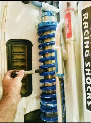

  7. Spring rate is determined on complete truck weight based off how much the springs compress at ride height, you want to have 9/16 between each coil instead of weighing the vehicle
  8. Size and valve shocks for how fast do you want to go
With how long these arms are and the proper weight behind the axle, these technical aspects start to disappear heavily, and the set up becomes dumb
When arms are short and the vehicle is light then it is technical and little things make a big difference.
