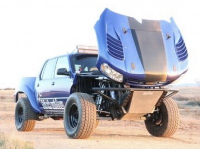

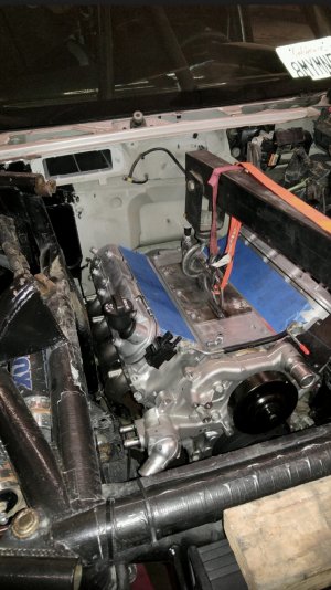

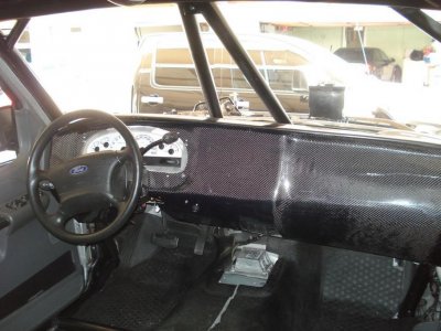

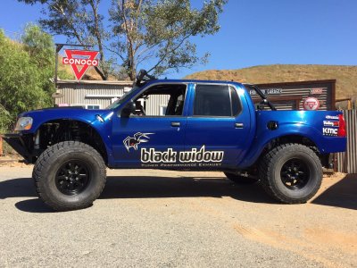

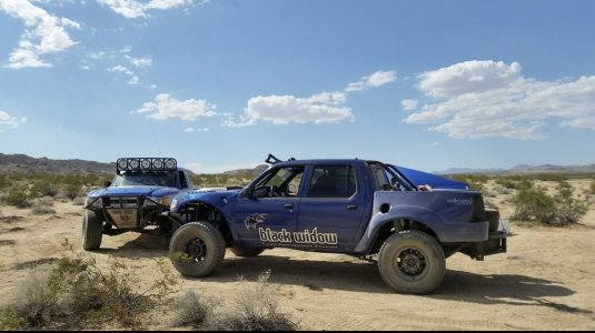

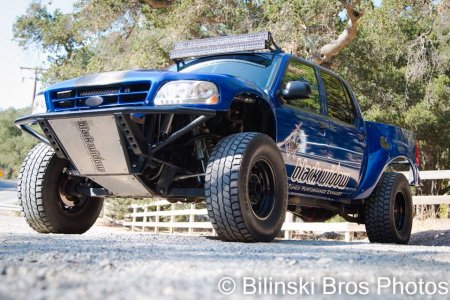

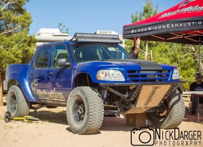

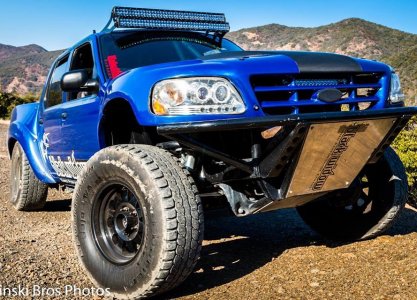

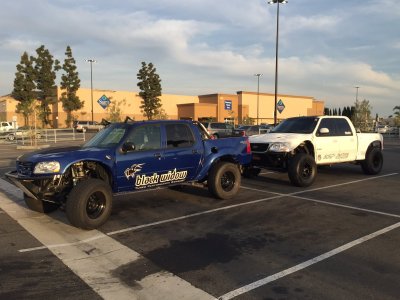

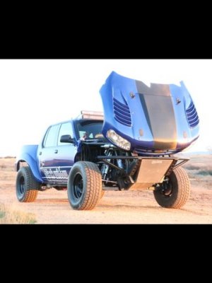

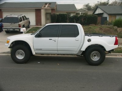

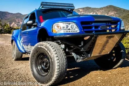

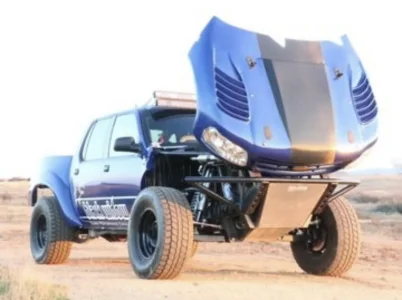

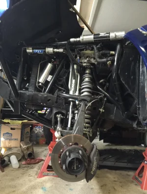

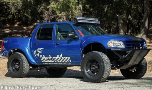

This will be a short build thread as it was started 15 years ago and I don’t have access to most build photos anymore.
•••2004 Ford Sport Trac•••
*6.2L LS3 Crate Engine(336hp to the wheels)
*4 speed 4L85e GM Trans w/Gate Shifter
*CBR Aluminum Radiator
*B-Cool Overflow bottle
*Camburg Race Kit with Camburg hubs

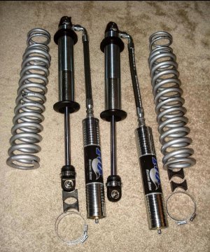

*2.5”x10 Fox Coil Over/2.5”x10” Fox bipasses(17” of Front wheel Travel)
*Rear has C-notched frame,
*Custom shackle/Hanger for Deaver 64” Spring Under Leaf Springs
with 18”x3.0” Fox Bipasses 20” of Travel
*GMR Racing custom 9” rear ended 5.00 gears
  • 2 piece Drivelines unlimited driveshaft
*1350 U-joints
*2-40” Rigid LED bars on roof
*1- 20” Rigid bar behind grill
*2- Rigid dust lights
*2- Rigid dome lights
*Fiberwerx Carbon Fiber Dash
*Lowerance GPS
*Kenwood Race Radio
*Dual battery Kill Switch

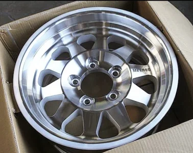

*6 17” Method Race wheels with 6 39” Triace tires( also have with 6 KMC torque wheels).
*Sparco wheel w/quick disconnect

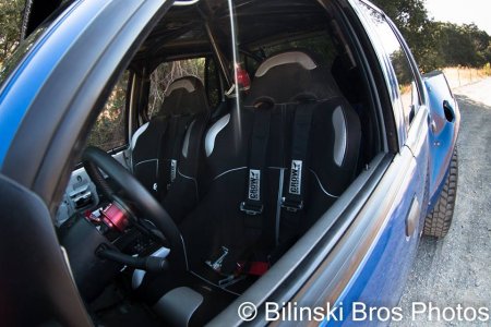

*4 Beard Race Seats with Crow Harnesses
*2 BLACK WIDOW Race Venom mufflers

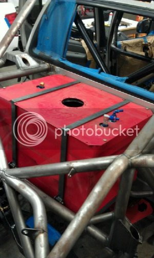

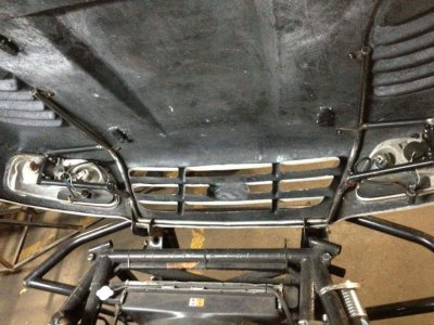

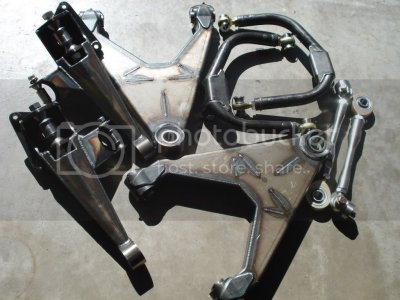

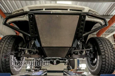

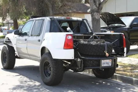

*Complete FiTech fuel injection system installed/Maintained by FiTech EFI CD982C89-32BD-4AAE-A7A8-257BC6449284.jpegB46B8977-F63C-4C89-AB5B-F56A772669D1.jpegCDEAA7F3-7712-4AC8-9C7C-61FB937E3F7D.jpeg8C2D8DB4-4CB6-44F3-B0A2-A6AF2F7CA308.jpeg617DF578-F508-4D15-A299-A14F41F601CD.jpeg

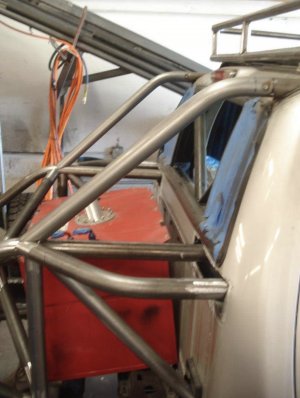

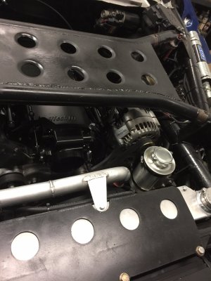

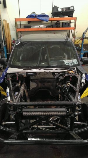

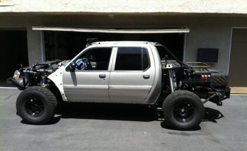

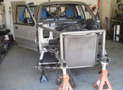

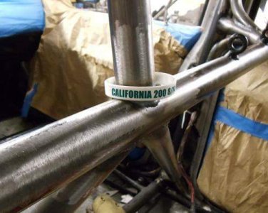

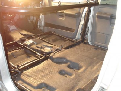

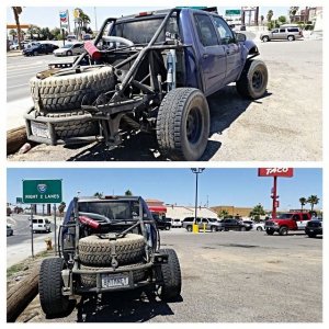

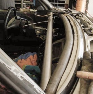

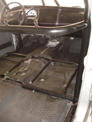

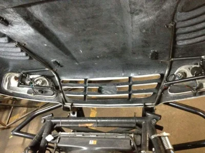

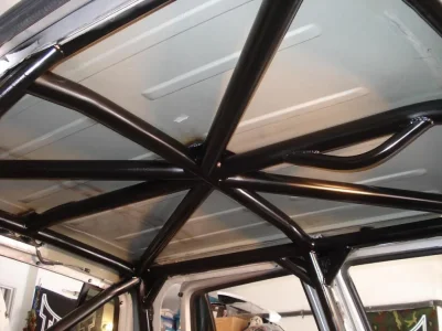

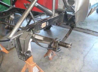

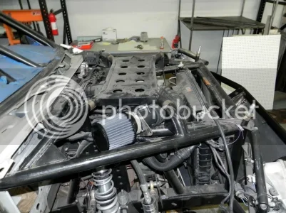

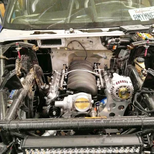

Sloppy did the C pillar forward and then I brought the truck home and did a bunch of things till I toook it to Jason at GMR where we did the back half and finished off the tube work that Sloppy had started. E22FC400-8E5F-4AA0-A4C4-1406147C3603.jpegEE254E59-FC4A-4F01-937C-725DDF622D5D.jpeg57F2F37D-9D7B-4B14-AA06-3A8FD91ADAB6.jpegC09865E1-FE0F-4044-8455-3E6AAAFA7F32.jpeg612A10C2-8ABB-4A62-9833-55CC729C4F98.jpeg

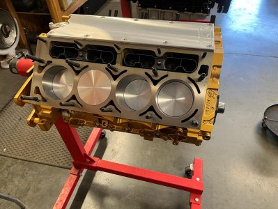

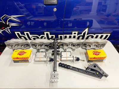

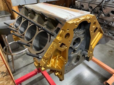

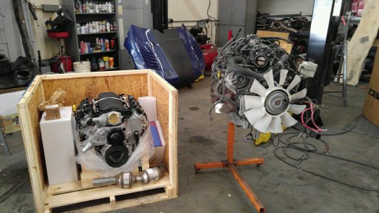

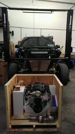

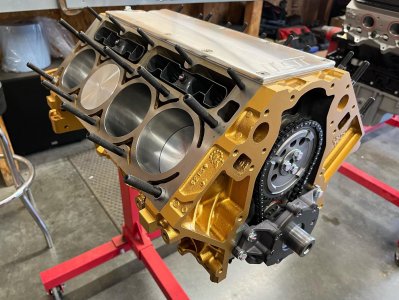

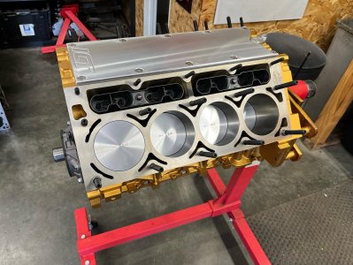

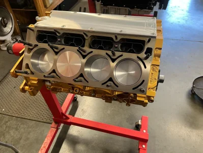

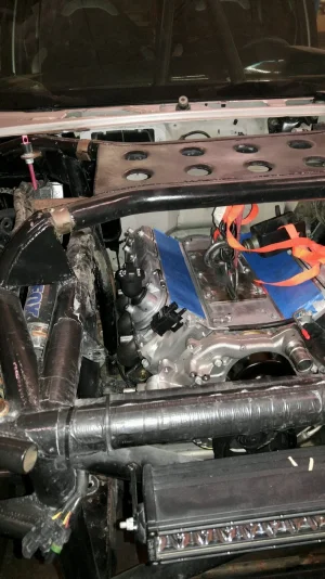

Wilwood sent me a bunch of new parts to get my build going again, and to get it running I got with Moruzzi to have him build me a Moruzzi special. The current LS3 in the truck will also go out to Robert and he’ll build me an engine for my Suburban or F100. Now I have to find a shop who’s actually willing to take on some work to get this truck back in the dirt. 3C4F483F-E8EB-4E2E-9F71-CE44023BB25A.jpeg

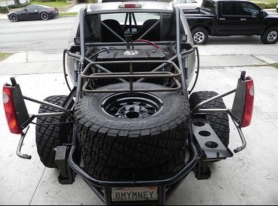

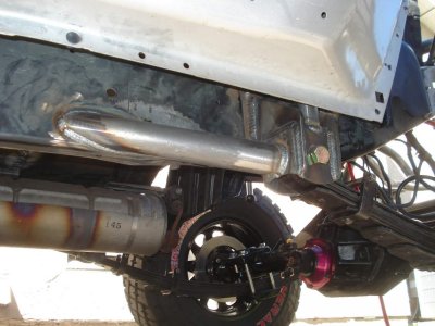

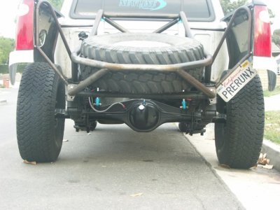

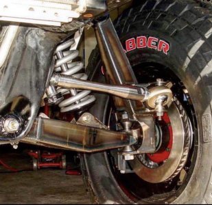

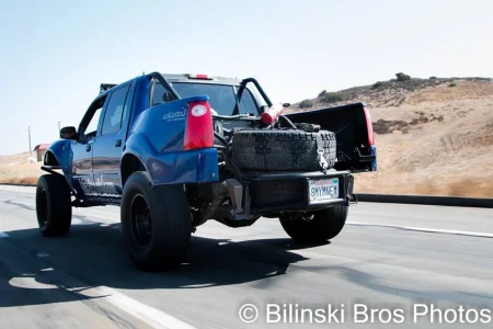

Love the sport trac build! Can you tell us more about the rear suspension? What's your track width? Did you move the axle location?
It’s got a 64” Spring under from Deaver and I had Jason(DIY) design hangers and shackles to keep the rear end as low as possible with 18” 3.0 Fox bi passed. I wanna say the rear was moved back 2”.
With the current wheel/tire combo I believe it’s at 84” track width out back368B9E7D-7BAC-4AD0-BFB2-4FE98A1A165B.jpeg
