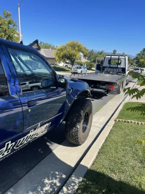

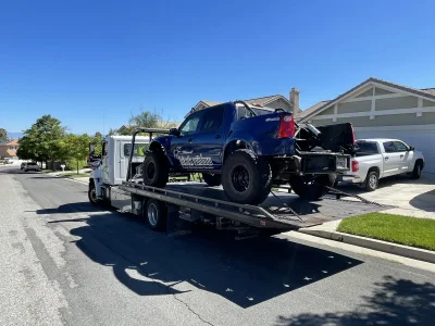

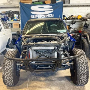

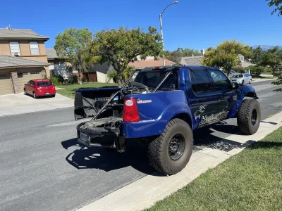

So, somehow/someway the truck made 340hp on FiTech’s Dyno back in 2018, and I felt the truck was way underpowered and no responsive at all since the day we picked it up from them, so before pulling the engine Anthony wanted to see what was wrong with it, turns out 1 injector was never plugged in and the gas pedal was only using 31% of its throw. After making the needed adjustments, it’ll light up 39” tires with no problem. Since it’s not needing a new engine just yet, I’m having him do a bunch of things I’ve neglected since 2017, as well a few upgrades 078116BF-6D8B-4AE6-8CD1-550B56965C16.jpeg
