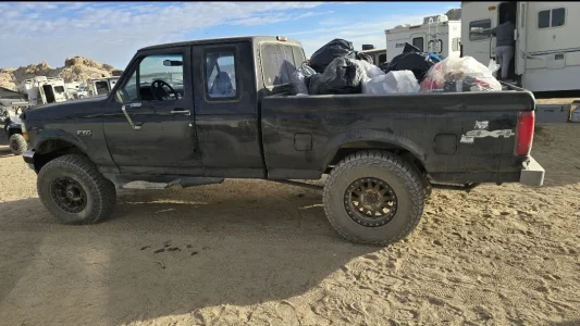

OK got some miles on this thing today st the prerun scouting mission for the clean desert nov 2 cleanup. Drove from Apple Valley Speedway via dirt up to start finish in Barstow. Then took some dirt along outlet center drive to get some Barstow del taco. After Barstow del we went up to the college hills to scout for more trash. Marked some spots on Son's of Smokey app for people to pickup. Also found a nice pile or clean nail free wood so we loaded it into my truck to bring for the Saturday night trunk or treat bonfire on Nov 2nd.
Video of the run from start finish to outlets. Was going 55-65 and hit the drop offs withiut lifting. Worked awesome with the revalve I did yesterday and added 3/8" preload to the rear.

Successful Thanksgiving trip. Didn't take any photos. Camper shell rear window and frame around it deleted itself, luckily it fell off and landed in the bed and glass didn't break. Truck worked awesome, super smooth when cruising, it's like my offroad couch. Shit mpg I need to get used to, 8 mpg. Water temp would randomly climb so gonna flush coolant system, since it's brown full of rust and changed the heater core since it's plugged and not flowing any water through it. Once those are done the truck will have a full new coolant system so I shouldn't have anymore problems. Also living 45 min from camp some of the friends dropped off their rigs RV and trailer at my home so it's closer to drive to get out to the hammers for gambler cleanup next weekend. I now really want to get a beater crawler to have fun with the boys going slow too. Saw the petroglifs and Checked out lava lubes as well on our run from Cougar Buttes out to Newberry Springs and back on Friday.

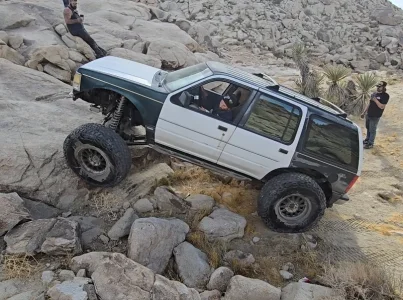

just rebuild La Tortuga.
you guys made quite the rock crawling pair.

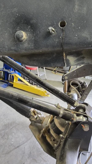

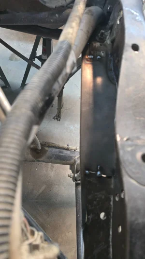

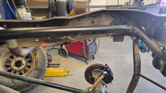

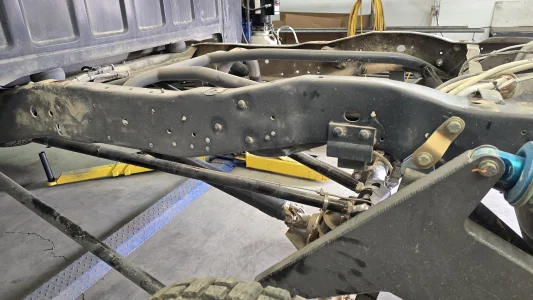

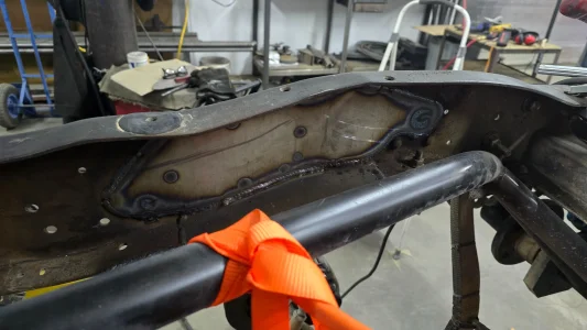

Ok took the truck out a few times now and over Thanksgiving for some more miles. Truck works really well but the rear frame started flopping around more than originally did. I then noticed where the factory frame bottom C channel is rolled down for shock clearance it started to crack on both sides. So I put on lift and then into stands and frame and bed gap went back to stock. I then started the tear down to cut bottom roll off frame and plate that in along with adding a few tubes to that area to keep it all solid. We'll when I was unbolting the parts I had my finger in the wrong spot and hit the impact and it aucked my finger between the wrench and metal pinching off the skin and finger nail, and fracturing off the last 1/8" of my bone. So progress stopped immediately when I went to emergency room. They got it cleaned up and referred me to an orthopedic surgeon to final dress it and get it so it'll heal correctly as it can. Of course this was Saturday between Xmas and new years so no appointments are open and now waiting die my appointment next week. Then back to progress on this truck to finish it up and then the more on the double cab tacoma to get that fab work closer to being done.
Well here's the cracks on the frame. Pass side had a small crack I welded up from stock a bags and overloaded.
I also need to get with @ADSRACINGSHOCKS to calculate correct spring rate for the rear since now with my 300/450 springs I have like 2 or so inches of preload and it is still sitting a little lower than I want.
I like the bracing you have keeping the structure under the bed, I would not of thought the frame would crack that way with the structure you added. what do you plan to add to prevent future cracking?
Update. Truck worked awesome over Thanksgiving and gambler 500 cleanup at Johnson valley weekend after. A few small problems with the truck. I fixed the overheating from unbled cooling system and alternator charging wire coming off. Big issue I'm working on now is the factory frame cracked where the bottom frame rail was rolled down to clear shocks. I cut out that portion and am plating it back in and gusseting the frame a little more in that spot to keep it all stiff. Also camper shell rear window blew out and then the corners of camper shell started to crack so I removed it to fiberglass that and build a tube frame to keep it all stiff for future. But for now running no camper shell until I get my bed platform drawers in and needed for sleeping in when camping. Also still looking for some 12" 2.5 or 3.0 bypasses or smooth bodies.
Also when working in the rear i smashed and de gloved my middle finger breaking end of the bone as well. So now waiting for that to get better to finish this job. Also my friend Mikey @the_fablab_ is gonna come out and help me get it done before KOH this year since I'm 45 min from lakebed and need a truck to spectate.
I was using my impact and a wrench. Finger got slammed between wrench and frame. Like an Idiot I had finger in bad spot didn't think it would've slammed wrench at all but it did.

Well finger is healing. Basically a callous on the end so I'm not 100 healed but it's not slowing me down much anymore. So back on the f150 project today

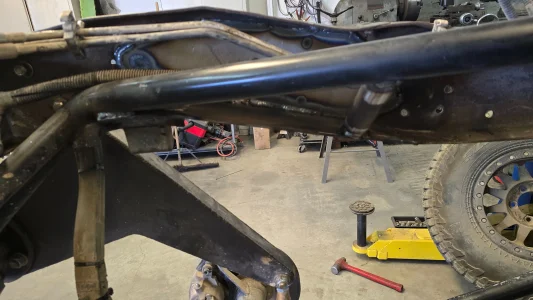

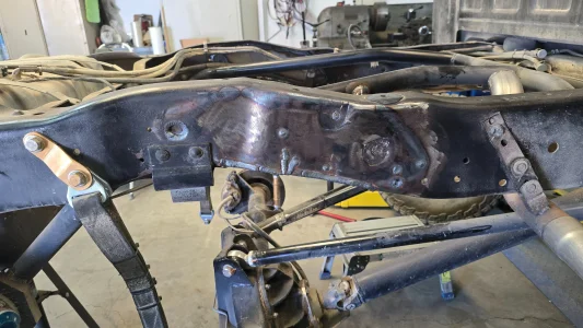

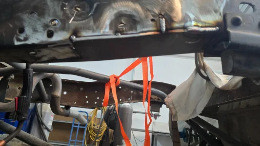

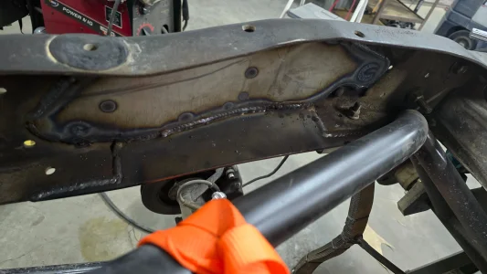

Bottom of frame was cut out and cracks welded. Got a new bottom plate made and it goes back towards and welds to my tube inner plates. I also ran some 1/8" plate in inside of the frame as well. I'm going to add a couple tubes from frame to inner tube structure i made. I should have it all back together tomorrow.
