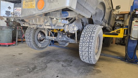

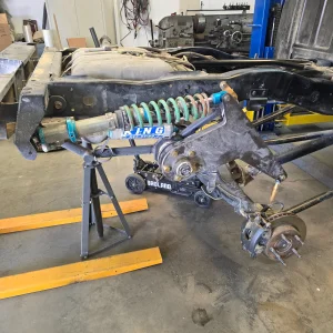

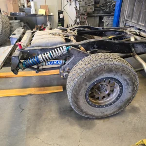

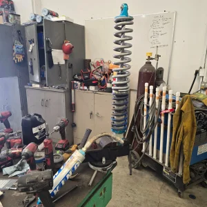

Haven't figured that out yes but I have 1700 lb spring rate per corner on my 12" shocks. Ride height is 7" shaft showing
quick math, I would shoot for a 12 inch 450lb over a 14 inch 550lb with roughly two inches of preload

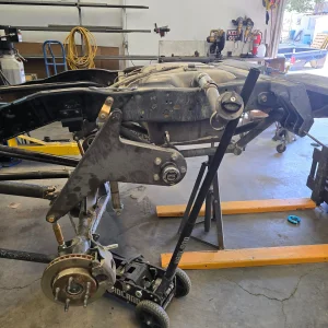

Rad truck, I love a good sleeper. I am doing this same rear shock setup on a bagged 56 GMC right now. The math is so fun..... haha
Yup cantilever isn't super complicated but calculating spring rates wasn't easy until I had it done and could use spring as a scale.

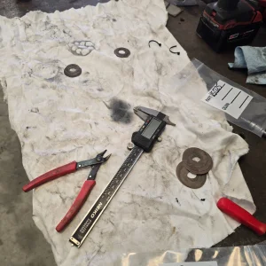

Ok got my rear springs swapped to 10" 550 over 16" 550. Also stiffened up rebound a bit from full .010 to 3 smallest shims .012 now.

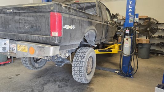

Gonna do a front end prep on this truck tomorrow after work. Then drive it everyday to make sure it's running and driving good before taking to laserfest this weekend to put some more miles on this thing.

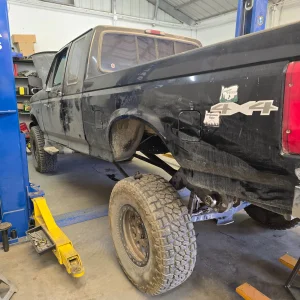

Yes they're grooved for traction. I bought them like that from a short course guy at leduc swapmeet.
I used to sell Van alstine tire groover to a lot of race guys but vevor sells China one of them now.

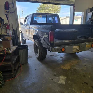

Also I changed the truck lights in the rear bumper for some amber lights. Not sure how bright they will be but better than nothing I'm hoping, just don't like them being as low as they are but I'm gonna rock them till I fix the camper shell and i'll do a flush mount into that when that's back on the truck.

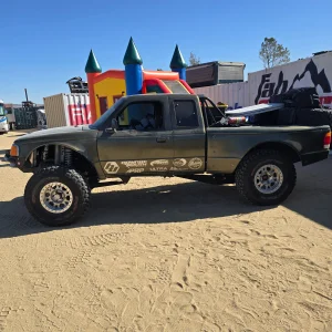

Truck worked amazing. Mind is blown at how comfortable this truck it. My landscaper truck is my desert couch. Just sit in and relax since it drives so easy.

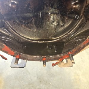

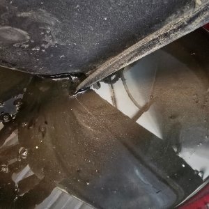

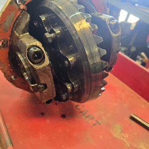

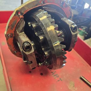

Now the only issue that has showed its face at Dezertfest was the rear end started making some noise when off the gas. Possible pinion bearing going out since gears suck into rin gear when off the gas. Also rubber filler neck has some cracks so when I fill it up some gas slashes and leaks out when I'm off roading till I'm down a little bit in gas
I got some 4.86 gears from @MikeLara for the rear end. Probably gonna go 4.86 in the front to drop rpm on freeway yo make the drives to and from the dirt a little better since 5.13 and 35s the v8 is too high of rpm for my liking to go on the freeway speed constantly. Also the mpg is crap at the higher rpms too.

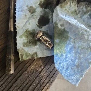

Yeah 3 of the holes for the ring gear bolts had a tiny bit of oval in 1 small spot. Also I cannot find 2 of the bolts so gonna rag/tubing the axle tubes since I gotta clean them out and find those things. Don't want something like that to ruin the new 3rd
