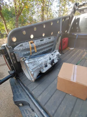

There’s a Culhane C4 on RDC right now. Has all the cool shit for a SOHC 4.0 $3K
Talked to him about this previously, will not work with the factory t case...there is no option for the 5r55e in a 4wd application
Unless you wanna basically redo the whole truck...nope

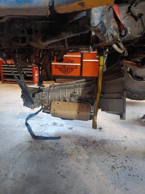

Running, seems to be ok....felt a little sluggish or maybe I just forgot how slow it was, or maybe it's the air filter packed with a couple hundred miles of dirt and no idea how much crap is in the fuel filter/how old it is,or the 4 month old 87 NV gas cause that's all I could get out there in BFE, gunna start there with the simple stuff....but its driving again, no leaks, shifts, etc... so that's a win.
Also.....if you need a redneck trans jack and work on everything solo (without a trans jack of course) the two ratchet strap method mixed with a floor jack works really well and removes the whole "squashing your head or smashing your hand avenue"...

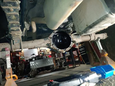

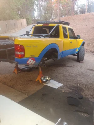

Drove my kid to Kindergarten this morning, soccer mom's look at this thing like WTF is that, why aren't you in a new luxury SUV, and all the kids smile and point at it when they see it, so mission accomplished...that being said, I have some issues to look at.
The rearend (Currie 9" 35 spline, 4.88's with a detroit) seems to have about a 1/4 turn of play in either direction and clunks hard leaving from a stop if it's unloaded. There is no pinion play up/down,side to side, or in/out, and it doesn't make any whining noise at speed....guessing I need to drop the 3rd and look at it. The Detroit is doing its normal noisy clicking sounds while turning....I have done plenty of 8.8's, 10/12 bolts but never messed with setting up a dropout 3rd besides replacing them.
Anybody got an idea of what I am up against or is it just time to rip into it?

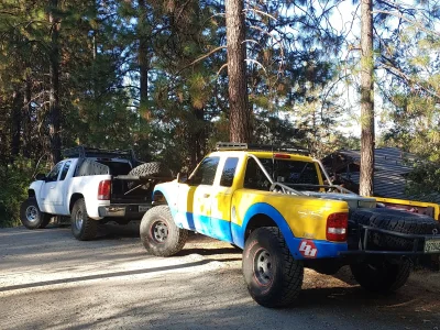

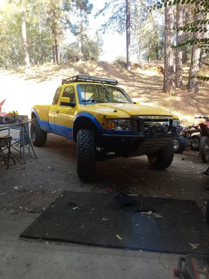

Oh....and a pic because everybody loves pics...we have all the roofracks. Sick bro.
Sounds like the same thing my toyota 8" with a detroit locker does. Lots of slop/play. Been like that for years and many Many MANY thousands of miles w/o a problem. Loud clunks and "pops" leaving from a stop, clicking around turns and corners, its all the things that led me to hate the detroit.

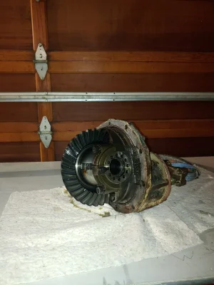

I am starting to hate the Detroit, not just for driveability but the fact that the 5r55e can not take the sudden "jarring" it provides and probably lead to its early demise. I pulled the driveshaft, no substantial play at the t case, no play in the u-joints, pulled the axles, both look great and bearings feel great, pulled the 3rd, inspected everything no broken gears, no damage, then did it again, wear pattern is solid on coast and drive side, no side to side to play in the ring or pinion, no slop really anywhere besides the expected, no chunks in the housing, but lots of metallic goo stuck to the magnetic drainplug... it's all looks good, has to be the detroit, it could be broken or worn out I suppose....I am gunna pull the carrier out tomorrow and see if the Detroit has broken dogs or something......basically, if I had a spool here right now I would just install it.

My diagnosis is to quit being a little bitch and go full spool
I tried finding one locally...no go, time was tight....I have to drive this thing to the city of fags and needles on the sidewalk this week which I am not pumped about, the owner of the GMC is coming home and he's getting that thing back so I put it all back together, dropped a testicle lifting the 3rd into place, and test drove it, she's better with new fluid but still not confidence inspiring....hopefully it lasts long enough with freeway driving until I can get my new work truck and find a solution.
My truck did this before the Detroit blew itself up. I think the Springs in it are the issue but I had to just buy a new one before I could figure it out.
My new Detroit is smooth, hardly does any weird clunks when driving and is actually very street friendly and always locked up offroad.
On a side note - If that is the original 3rd that was in it when Eddie had it... it's not a Detroit. It's something like a Detroit that he bought from a circle track car...
Yeah I asked him about that a week ago or so, he said it's a circle track deal too...I guess it's a non conventional Detroit, keeps the left side locked in and basically regulates/locks the right....I'm over it, put about 300 miles on it everyday last week and it runs fine.

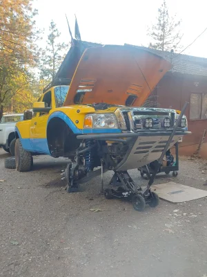

Well...been commuting it about 300 miles a day which is super fun....noticed yesterday it was leaking fluid out of the left front and right front.....rack failed/leaking on drivers side and axle seal on the other.
Racks in these are super dooper fun and not even mildly frustrating but with the dixon kit there's no inner tie rods that get messed with so that eliminated a driveway alignment, she drives pretty straight and steering is tight again, good enough....so now at this point I have replaced the two things I was worried about, the trans and the rack....gunna mount the old used rack in the truck since it still worked and will get me off the trail if needed. The vent hose came off the diff and the little nipple was clogged, guessing it pushed oil out the seal instead....unclogged it, cleaned everything, drove it, not leaking anymore, good enough.
