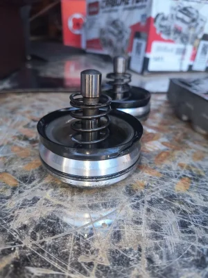

Idk if you've fixed the trans yet or not but pretty sure your overdrive servo shit the bed. You've most likely lost 2nd as well but it is hard to notice. https://www.fordservoboretransmissionfixsolution.com/store/p28/Ford_Ranger,_Explorer_Sport_and_Explorer_Sport_Trac_-_Not_for_6R66_6_Speed_Transmission.html

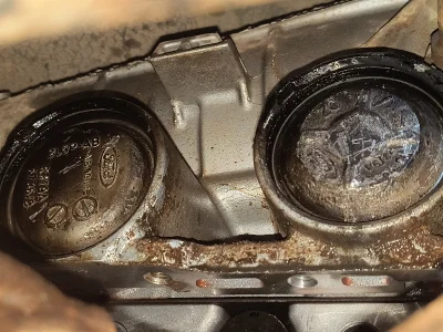

Ok tranny guru's or someone with more intelligence....I went to check both of the servos and I have removed them on these trannies in the past and they came right out....soooo I pushed the cap in, got the snap rings off, and now the servo caps/servos are both stuck in but I can rotate the caps....tried blaster then put some heat to the case, nothing is coming back out, as far as I remember they have spring pressure behind them and should pop out. I would really like to at least verify or check if these are bad.....I also dropped the pan and there is also no glitter or broken stuff in there, fluid smells perfect... I guess my next move is dropping the valve body to see if I can apply air somewhere to push them out i should probably check the separator plate anyways.......
keep in mind I am beyond pissed off at working on a 5r55e in another ranger for the millionth time (hence buying the 5.0 expo), lots of cursing, the dogs are scared, neighbors are walking by staring at me, etc...
Trying to drive it a little more before I start the explorer swap....which has coincidentally become my dd cause the diesel is gunna have the camper left on it until I need it.
Try some CRC freeze off or freeze spray on the cap to see if it will contract. Has worked for a few guys on some explorer forums. Have you tried adjusting the bands?
Freeze spray is a great idea, I can definitely do that, I'll see about trying that tomorrow...I didn't try adjusting the bands yet but that could be something to give a shot.... unfortunately it's under the carport not in the garage so my tolerance for rainy/cold weather is growing low.
Freeze spray was a great idea and got it to move a tiny bit while tapping it then heat then PB then sit then freeze again and so forth....fuckers are stuck, guess I am going after loosening the bands but it started to rain and is supposed to snow.....so I went in the garage to chunk away at a project 66 Continental fuel injection swap.... Apparently the tank was damaged and I found it sealed up with silicone........remove silicone and get pissed in the face by old gas.

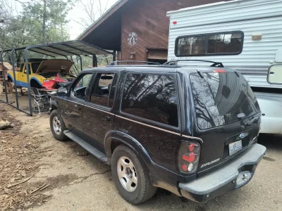

In the meantime I am daily driving the reliable cheap donor beater AWD explorer I bought to swap in the 5.0 to the ranger and totally enjoying it...fits my son, 2 German shepherds, and me comfortably, all while not giving a single fuk about it.

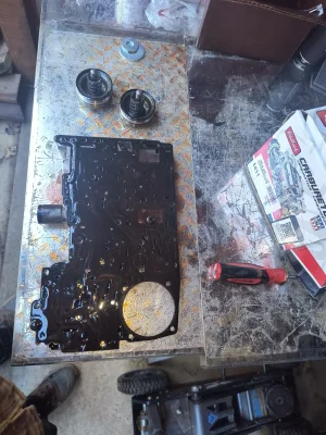

Well I backed the bands off and it did no good to get the servos out so I went ahead and dropped Valve body and it's got spots on the gasket starting to seperate so that's hella cool....but I did get the servos out, they had to be physically pushed out with a good amount of pressure from the inside which makes me wonder if the case is oval'd out from the servos but I dunno, the spring pressure pushing outwards was also doing nothing, the rear one has a split in the seal too.

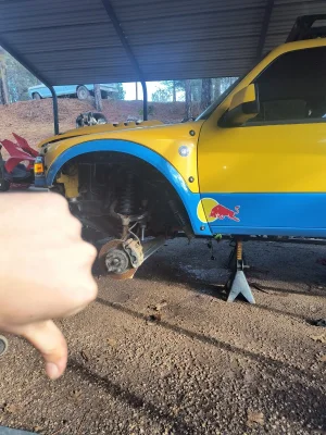

So now I am at a crossroads, either replace the tranny again or try to throw parts at it, both options suck. My other option is to start the swap but I really like the explorer and it's my DD since the dually just isn't feasible to commute with or really use for anything other than it's intended uses. My other option is buying a wrecked 4wd 5speed if I can find one to swap.....all options suck.
Worst possible scenario I sell the damn truck and never ever buy another A-Arm 4wd ranger as long as I live, I have had every known issue happen to me so far besides timing chain issues... more than once.

I think you can probabaly buy a reman from Ford cheaper than fixing it. I would leave it automatic. The case can be worn out too (in the rear) causing issues; in the long run getting a reman from Ford is cheaper.

Probably what I will have to end up doing, just sucks this will be number 3....I would buy a "built 4wd 5r55e" if that was even an option but since basically nobody supports them then I am stuck with a reman timebomb made of glass....this one was rebuilt using the original case so maybe that had something to do with the failure I dunno,kinda makes me think so since the servos were stuck in there and probably caught on a lip in the case..

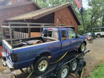

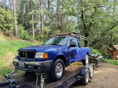

Alright, got sick of this thing staring at me everytime I open the garage and after much overthinking daily I decided I just flat out don't ever wanna deal with the 5r55e ever again....sooooo I found the world's biggest pile of shit 2004 ranger 4wd manual 4.0 that fortunately has everything there and I honestly don't think anybody is gunna miss it not being on the road anymore....so I guess that's progress, haven't even taken it off the trailer yet but the auto transmission is dropped out of the yellow truck so I guess I'm out of excuses here. FWIW if anyone wants this blue truck cheap I would love to get rid of it asap after the swap, it came with extra trans cases, doors, wheels/tires, "running sohc", 8.8, etc ....
