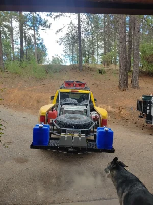

So, we did our trip to black rock with the church, all in all it went famously. 5 hours to camp from my house with my my buddy, did about 200+ dirt miles with the boys when it was all said and done, got back Saturday afternoon and the trans was clunking and felt hurt but still doing its job. Truck ran awesome until Sunday morning, left camp on an uphill got a little aggressive, and she left the chat, lost 3rd, doesn't like 4th, and reverse went on vacation, classic 5r55e. Drove home shifting it from 2 at about 80 to overdrive which was fun going over donner summit. Still very happy, I will either go buy the stuff to rebuild this trans or just buy a built one, trying to figure out the best option. Talking myself out of ruining it with a C6 that I have the means to make work with 4wd. Trying to keep her stocking and strong.

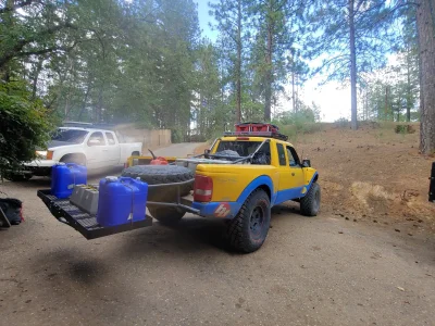

Looks like a cool trip! What are the things in the middle of the hitch rack?

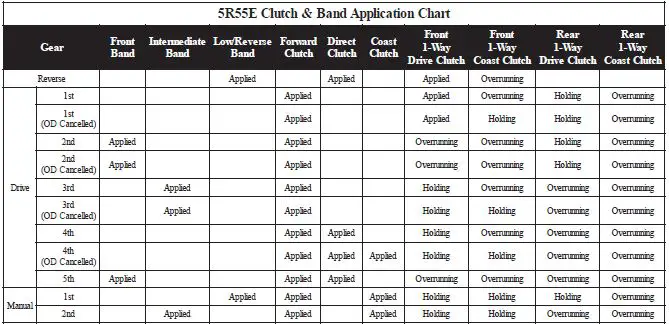

One or a few of these has failed:Trying to figure out what I did and what parts to get here, the fluid isn't burnt and doesn't appear to have any metal in it (yet)...i havnt dropped the pan yet.
What I do know is it lost mainly 3rd and Reverse....it will downshift to 4th from 5th and hold the gear so long as the load isn't too bad.

I blew up my 5r55e a few different ways.
There is definitely a way to swap in a 4wd C6 behind a 4.0sohc. Rare, but doable.Thanks man, good info...I am reading that alot of people have the valve body gasket seperate and the reverse valve servo loses an o-ring and a sleeve. I think i had this same issue about 10 years ago on the same trans/different truck. Gunna drop the pan and valve body... oddly enough I have my ATRA cert, forgot all about it, I have rebuilt probably 4-5 auto trannys personally at my house with success, which means I am due to screw one up.
