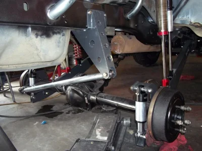

Who has run 12" coilover and 14" bypass on the rear of a linked truck? Any issues? I can't think of anyone who has but I also can't think of any problems except less rear travel than other setups. Probably somewhere around 22"-25" depending on link geometry.

we have a few customers running a 12/14 combo no real issues are present if everything is designed properly in some cases a non traditional spring set up is needed to prevent coil bind, but nothing you wouldn't see with a cantilever design
If you remember that old school “blinger” ranger it’s got 12/14 on the rear. Pulls around 23” I think. My buddy owns it now
Total spring lengths and spring travel can be an issue on a link setup yes.
We just linked a single cab Superduty with a single 12 inch coilover and I wish we would have ordered a 14 inch coilover with a longer shaft spacer inside destroking it to 12 inch travel.
Having extra body length for spring options, etc., is very beneficial. have you considered doing a 14/14 setup and limited the stroke on the coilover so you can take on and off the truck easier?
