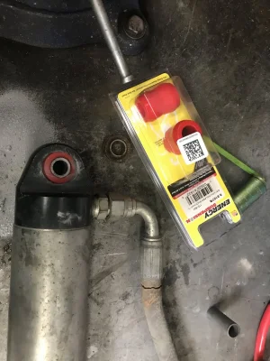

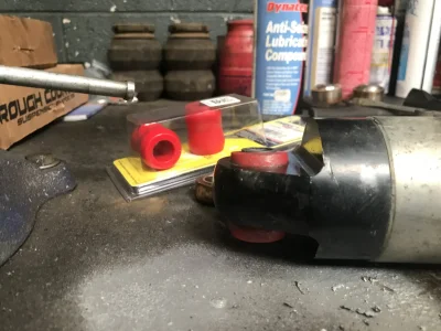

Great thread, Ive been wanting to replace my Com9-T bearings on my FOA smooth body R.R. rear shocks on Daily F-150. The bearings had play and were squeaking and was being transferred into a stock unmolested cab. I used an Energy 9.8107R and a 5/8” OD x 1/2” ID shock bushing sleeves. I want to try it on my bypasses in my fully caged ranger next, if these hold up.image.jpgimage.jpg
