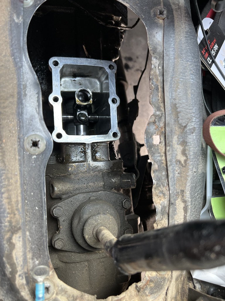

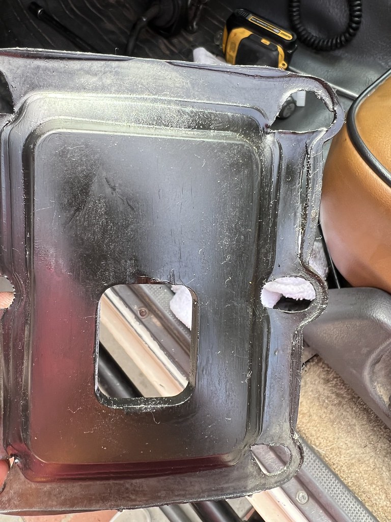

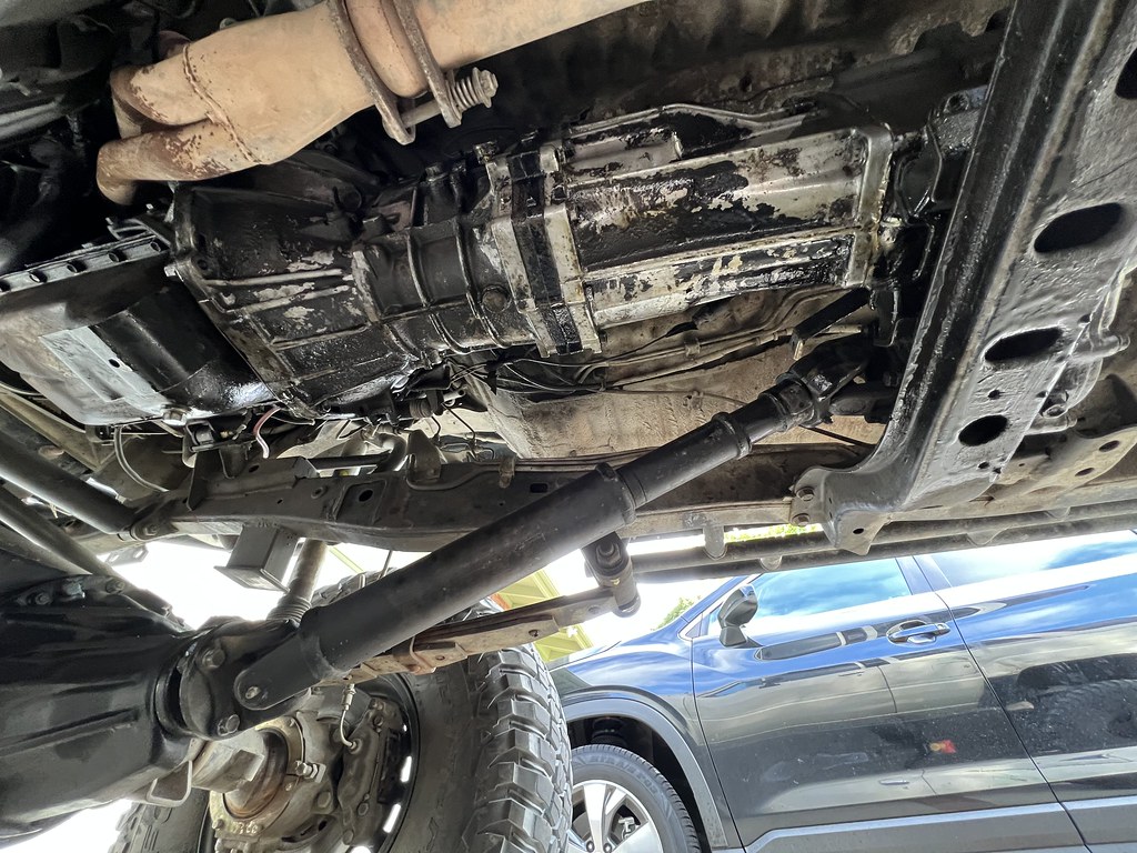

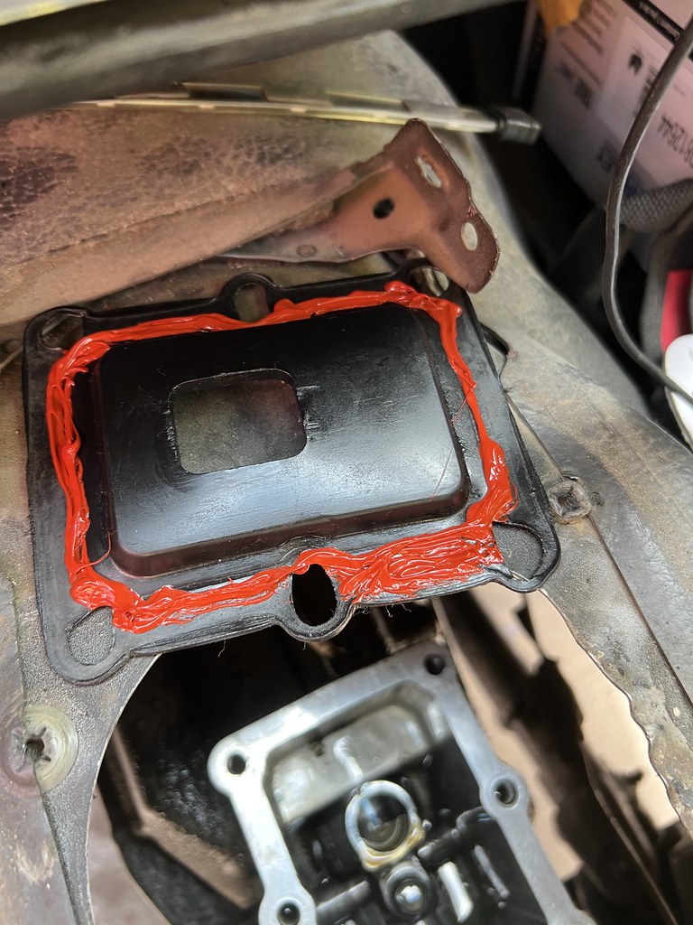

Same day also tried to chase down a trans leak which appeared to be coming from the top of the trans near the shifter
Pulled the shifter to find.
Topped up tranny was only 2 quarts low on gear oil!
Slapped it all back together and load the truck up for its first shake down run...
Trans and Tcase both were still leaking after my RTV attempt...
So at some point i'll be pulling those out.

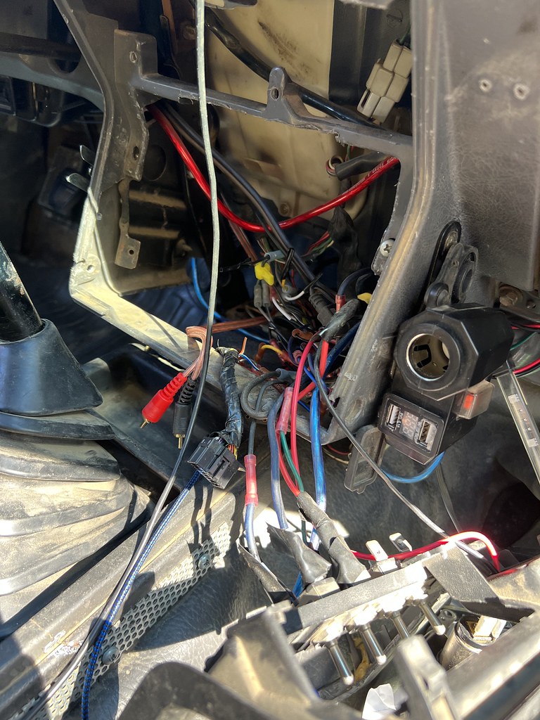

Oh picked up a race radio for this thing... pulled out the existing CB which was mounted under the radio..... only to find....
going to have to get all this clean up too... Good times! for the time being, reinstalled the radio and just pulled the CB out.

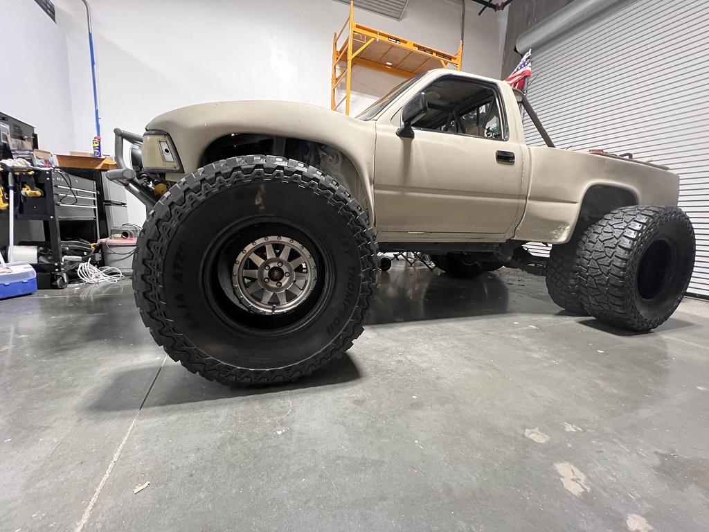

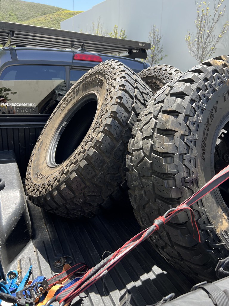

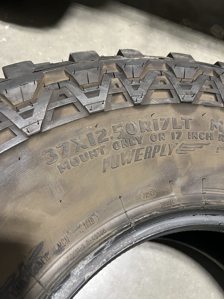

Buddy I ride with had a line on some tires. Truly a deal I couldn't pass up.
37x12.5x17 Mickey Thompson BAJA ATZ
You ves the guy she told you not to worry about...
37's are big!
My powersteering steering box/pump like this..... 🤡🤡🤡🤡🤡🤡
I probably won't throw these on for a while. But like I said the deal was too good to pass up... So they can hang out upstairs in the shop for now.

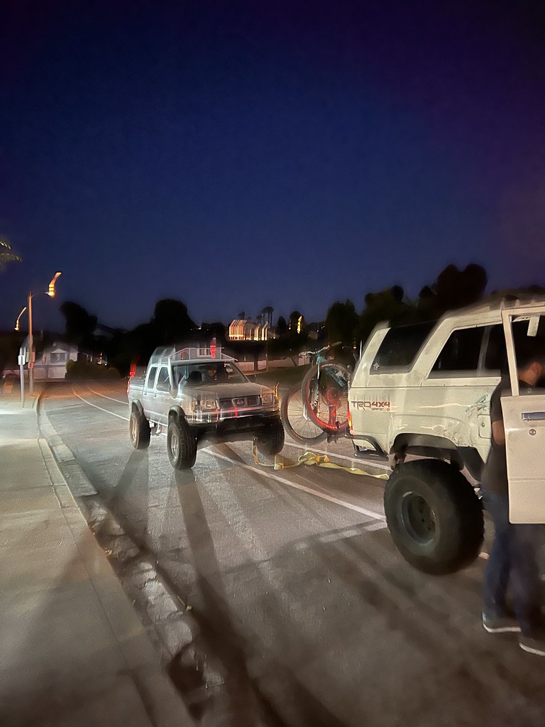

The other night after our group ride. We spotted a gentleman in distress Crew cab frontier, dead in the water.. Dude was out solo trying to push it out of the road. We pulled off, luckily Juan had a tow strap. Need to add one into the trusty shit box.
@the_fablab_ and Juan hooked up the strap to the bumper as the guy just kinda watched with big eyes. @the_fablab_ asks him if he's ever been flat towed before and he says no kinda uneasy. So like tells him look if it's cool with you I'll drive your truck and you ride in the 4runner. Dude is like yea, yea that sounds good! So the guy hops in with me and we take off towing him back to his house that was just up the street maybe a 1/2 mile or so. The guy started asking so you guys do this alot? haha I laugh and tell him yea we have done this a time or 2.
we got to his house. Unhooked the strap and helped him and his dad push the truck into their driveway. They were super appreciative they must have thanked us 8 times, we all shook hands, and the Dad gave Mikey a hug.. haha just people helping people...
We loaded up and headed to meet the rest of the boys at Cronies. Just another Thursday.

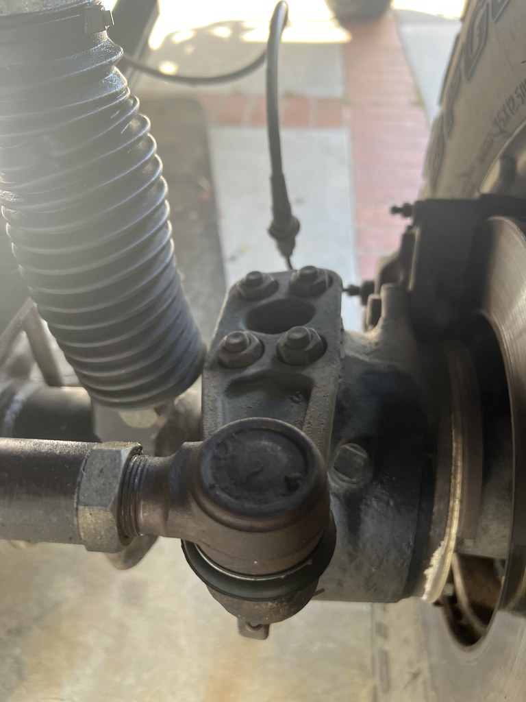

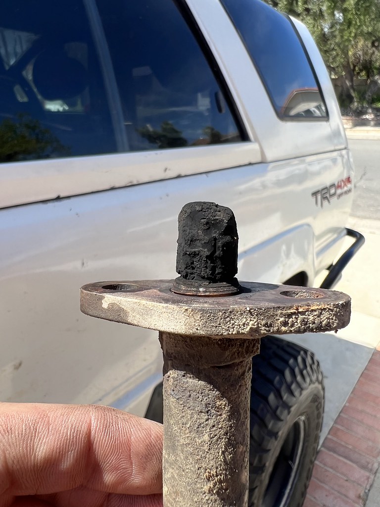

Drove the 4runner out. Made it pretty uneventfully, when I hit Bear Valley Rd I notice I had developed a belt squeal at higher RPM? Trail fix... turned up the music it went away... #science Also discovered a loose Steering Knuckle on the passenger side. Like finger tight. 🤡🤡🤡 that's good right? haha
Figured we'd sort it in the am. Stayed up way too late... In the am was planning on heading over to Cougar Buttes to mess around on the rocks...
Pulled the truck into Tommy's shop

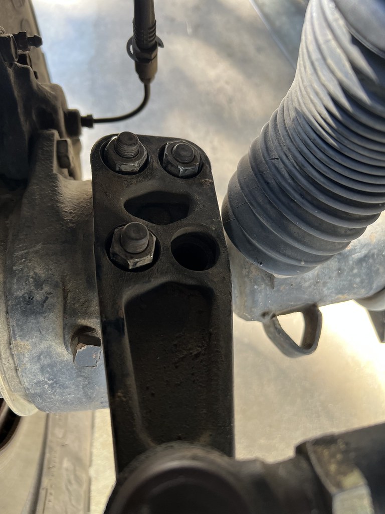

We jacked up the truck and realized that not only was the knuckle loose. One of the 4 studs was sheared off...
Sooo that kinda put a damper on our wheeling for the day. Decided to play it safe instead of chancing it.

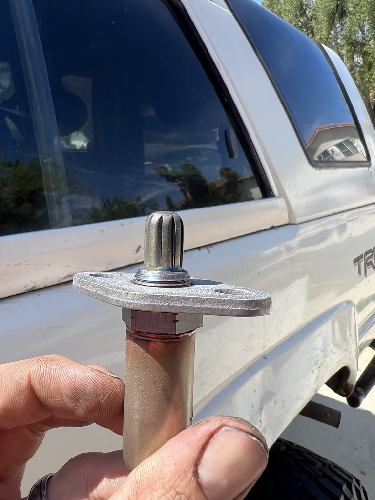

It's supposed to look like this...
instead...

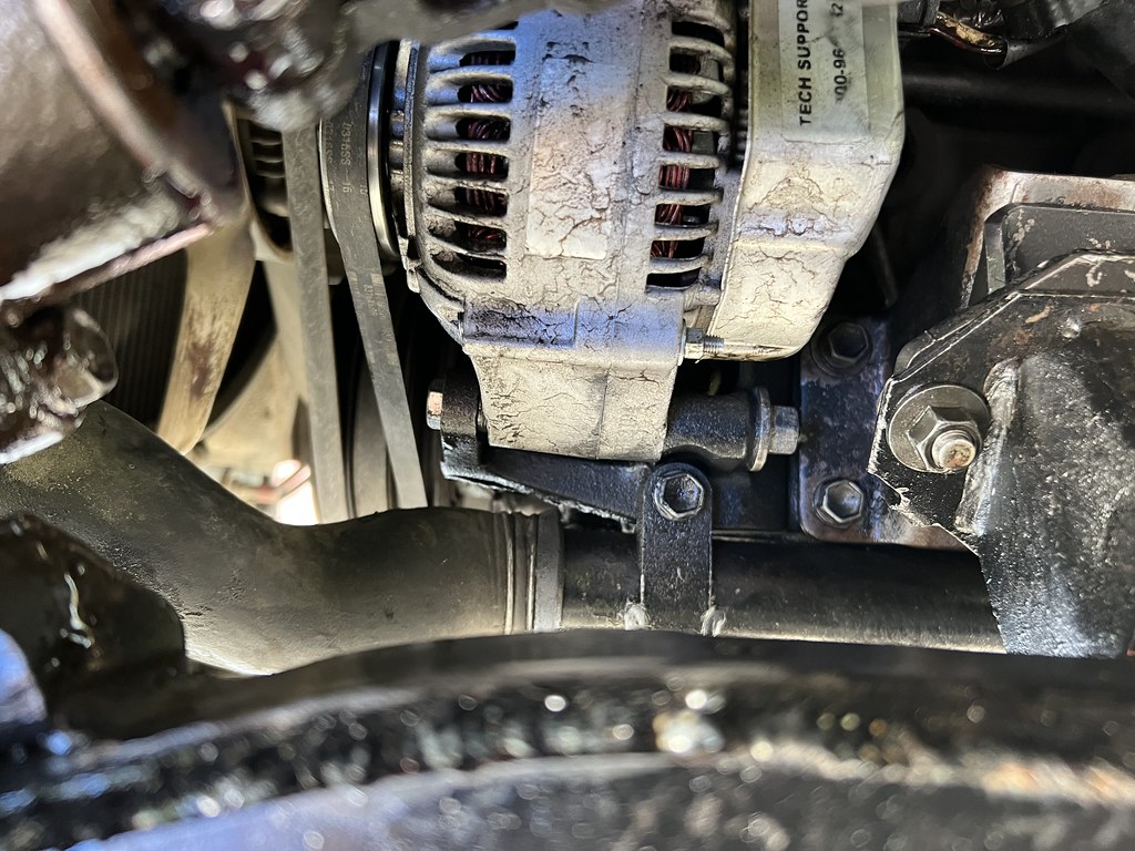

Tightened up the 3 bolts and then started to take a look at the belts. The alternator belt was super loose... upon inspection Scott notice the bottom bolt pivot had left the chat and was not there haha....Prepping properly...
We found a bolt that would do the trick, installed that and the 22re was back to her fire-breathing self.....
Hit the Trail home...
She drove home without any issues. I stopped a few times to check the steering arm never moved.
So now I'm looking at the trail gear 6 shooter knuckles or possibly just upgrading the studs for now and down the road do. https://www.marlincrawler.com/steering/high-steer/25mm-steering-upgrade-kit-w-arms
Either way, I've gotta pull the front axle apart to get the broken stud out of the Knuckle...

https://www.yotamasters.com/shop/ot...seals/w56-transmission-shift-base-oil-baffle/
the shifter gasket is supposed to have some AL spacers allowing you crank down on the bolts, yet still get an even seal.
https://frontrangeoffroadfab.com/arp-steering-arm-knuckle-studs/
ARP knuckle studs are a requirement, ARPs from Front Range Offroad are the way to go.

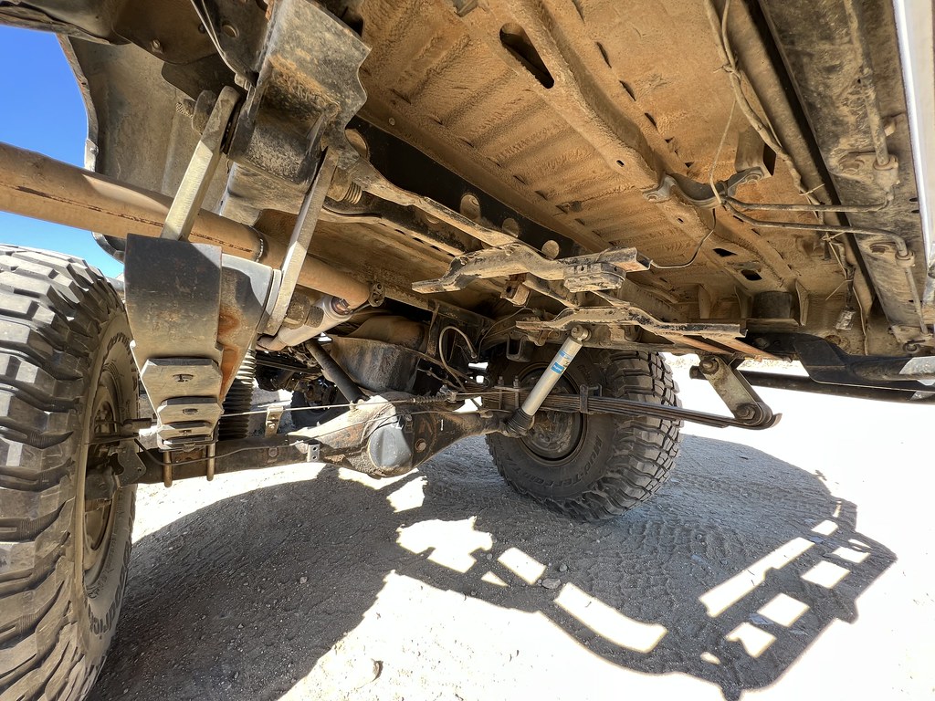

a few more things ive noticed/worth mentioning
- the brake likes with the mini hardline that is unsupported will eventually break, obviously when it is not convenient
- if you ever plan on sleeping in this thing, add a switch to the rear for the window. super annoying when i had my bronco to be climbing over seats to roll the window up and do at night or in the am.
- gusset the backside of the front spring hanger, they are known for cracking and taking the frame out
- since you like going fast, get a gusset kit for the knuckle balls
- look into the tacoma brake upgrade for the front when it comes time for new brakes. you get a slip on rotor, bigger caliper and did i mention a slip on rotor?

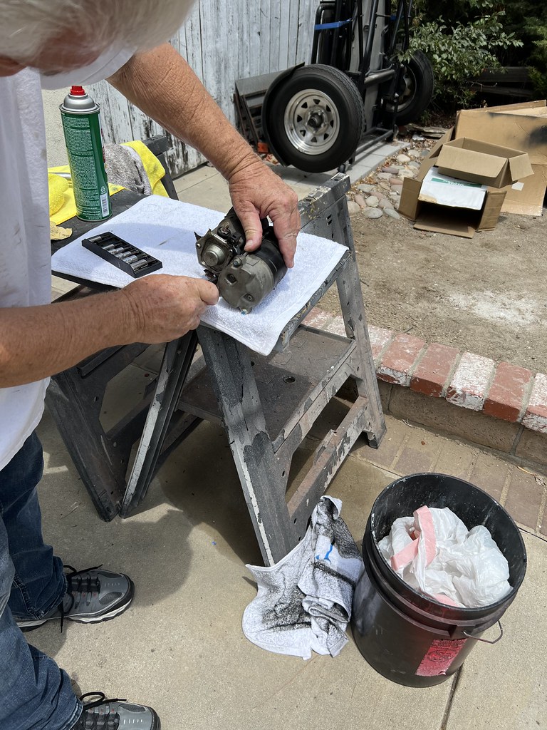

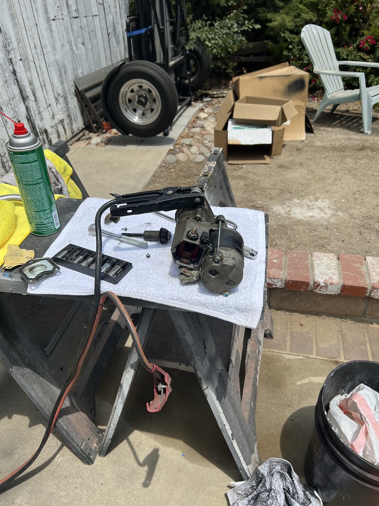

First thing was to get the truck in the garage. Cleaned things up a bit. Hopped in the truck battery was dead. Tried to jump it... Nada.. My neighbor (who is a Harley gearhead) cruised over to see what I was up to. He helped me diagnose it down to the starter..I was all geared up to cruise down to the auto part store. He was like no no pull it and we could bench test it's more than likely just the contacts. Pulled the starter.
This was too good to not stop and take a photo
He was spot on... Contacts were hammered. Clean them up slapped the started back in and Walla!
Back in business!
