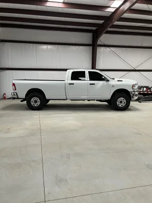

I've have never run balance beads; and very curious to try them. I have beadlocks on all my trucks. I HAD to have Walker Evans on the new truck...and they shake (not terrible) but enough that it bugs me and doesn't feel like stock did ha ha. Tires are brand new 37" Toyo AT3 and the wheels are brand new forged Walkers.IMG_7154.jpg
