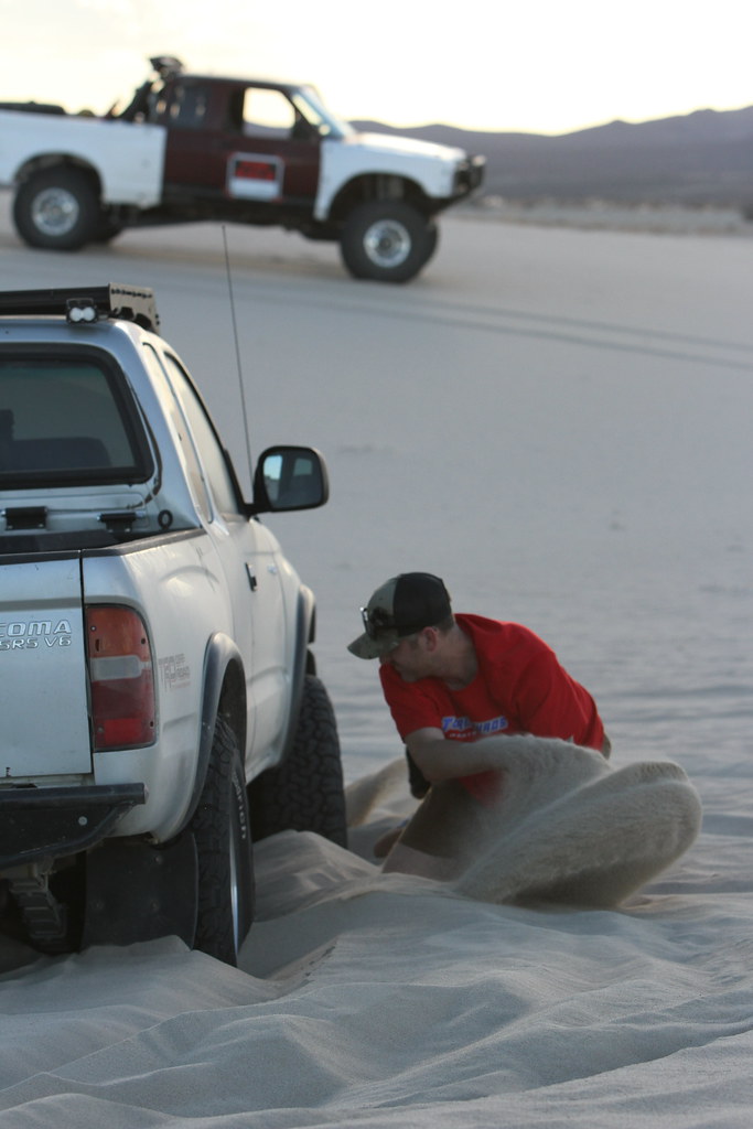

It started with my truck when it was stock width. The outer joints on the Tacoma and Tundra are the same joint so we had summer brothers machine a set of stock width axle shafts that are Tacoma/4-Runner length but use the Tundra inner CV joint. Then when we did the Military job we had them make us 1" axles that used the Tundra inner CV joint.
or stuck in the dunes in barstow...
Sorry to be off topic, but WTF are the dunes in Barstow?
Dunes are on the West of 1-15 off lynwood road. Not East Stoddard wells off-road area.
That’s why I’ve never seen them, I’ve only been on that side of the 15 once for a clean up probably 2007/2008’ish

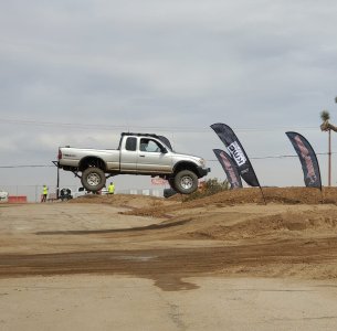

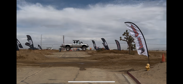

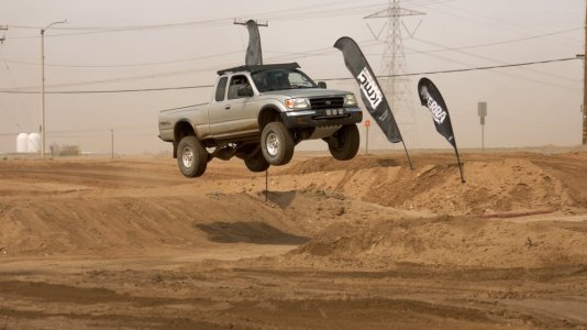

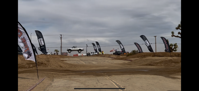

Some images from Speed Metal a few weeks ago. The first time out in the morning I was being a sissy and didn't think I would be jumping any of the jumps, but when I came back to out booth I got a ration of shit from everyone for not jumping. I explained that this is my daily driver, and that I still needed to drive it home. After about 5 minutes of listening to everyone call me a pussy I said "fuck it" and in the second session I pulled out my Tampon and sent it. I would like to say the smooth landing was all because of my shock valving, but a large part of the smooth landing is thanks to the transition. If you hit it at the perfect speed the landing was so smooth you could have done it jumped it in damn near anything and had a good landing. I over jumped it a couple times and it definitely used all of the bump stops.
