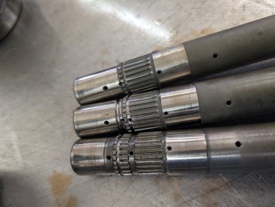

Transmission is the stock A340 2wd Sequoia edition with 5 pinion rear planetary. I modified a 98-01 XJ AW4 output shaft and used the AW4 4wd adapter to mount up the NP231. A pickup VSS fit in the housing and should read the XJ 4 pulse ring but hasn't been tested yet.
This pic has the stock Sequoia on bottom, stock XJ on top and modified XJ in the middle. You can see the new hole drilled in the old clip groove and the groove towards the top.
