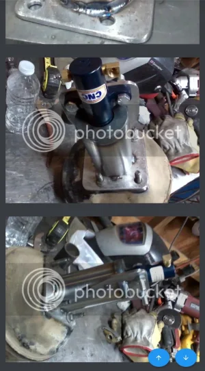

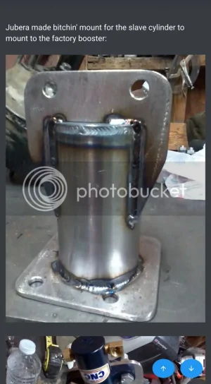

On a serious not we did it to our old ranger that we built for a buddy. He wanted to go to bigger tires which interfeard with the booster and didn't want manual brakes so we opted to move the booster to the back of the truck and run a slave cylinder like a clutch set up. Ran a vacume line to it and it worked pretty damn good. Never had any issues the whole time he owned it. I know Willis fabworks owned it for a while after him. The brakes were more progressive due to the slave cylinder but east to get used to. I will see if I can dig up some photos.
I didn't remember him having a tread on DR. Havent been on dr in a long time. Crazy Jim was his sn I think.
Took some screen shots if anyone was intrested.Crazy to think how long ago that was.
