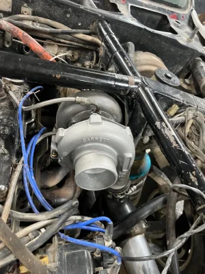

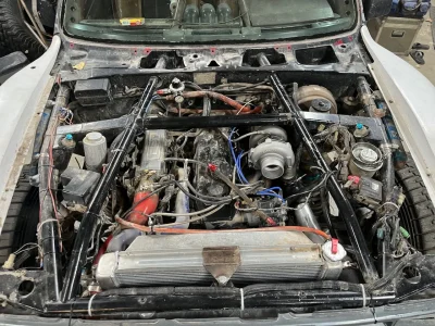

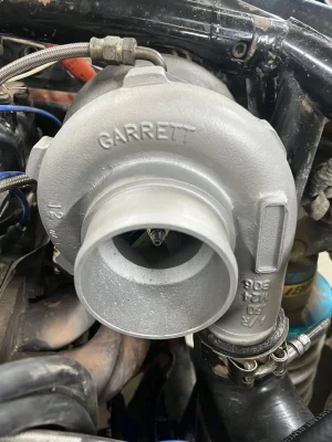

It a Garrett GT2876R atop a custom stainless exhaust manifold.Is the factory turbo top mount? Almost looked like a holset.: I can’t tell ha.. how’s the rebuilt power plant feel!?
Which exhaust housing AR did you go with?It a Garrett GT2876R atop a custom stainless exhaust manifold.
Refreshed motor with a legit dyno tune feels fucking awesome. Ample power, 12+mpg highway, 8-9mpg in the dirt.
The “mystery grind” cam kinda sucks. Horsetorques are completely flat after 4000rpm. I need a better cam, but then I’d have to retune…
MegaSquirt isn’t my tuner’s favorite computer to mess with, but it gets the job done.
A/R: not sure… remind me to check again at some point.Which exhaust housing AR did you go with?
Really only curious because IF the Dyno chart shows HP/TQ flat.. then possibly the turbo isn’t making more power and just pushing hot air..? I know those garret models are good for like 400+ but, just wonder if it’s a factor or not.
I may be way off!… Just a thought
All new spinny bitsNew turbo??!
