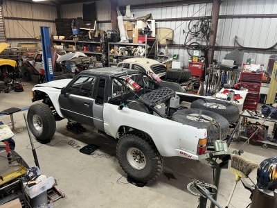

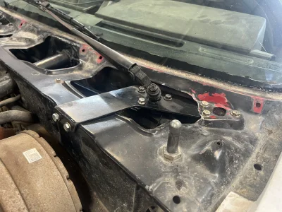

Cool ass truckwhat was the windshield wiper issue? Getting the links to work around the cage?
would love to see some pictures of ur linkage. i gotta eventually get around to doing the same thing. would love to see some inspirationWe wanted to take Clark’s Grade up to Big Bear and eat at the German deli up there, but the fucking gate was locked. The forest service is gay.
Wipers: I have 4 tubes going thru the firewall, and as it turns out, that’s exactly where the wiper linkages want to be. Shortened both long rods, added 69 bends, moved the drivers side inboard by 4”, added a 1/4” heim at the motor arm, and used lots of profanity,
