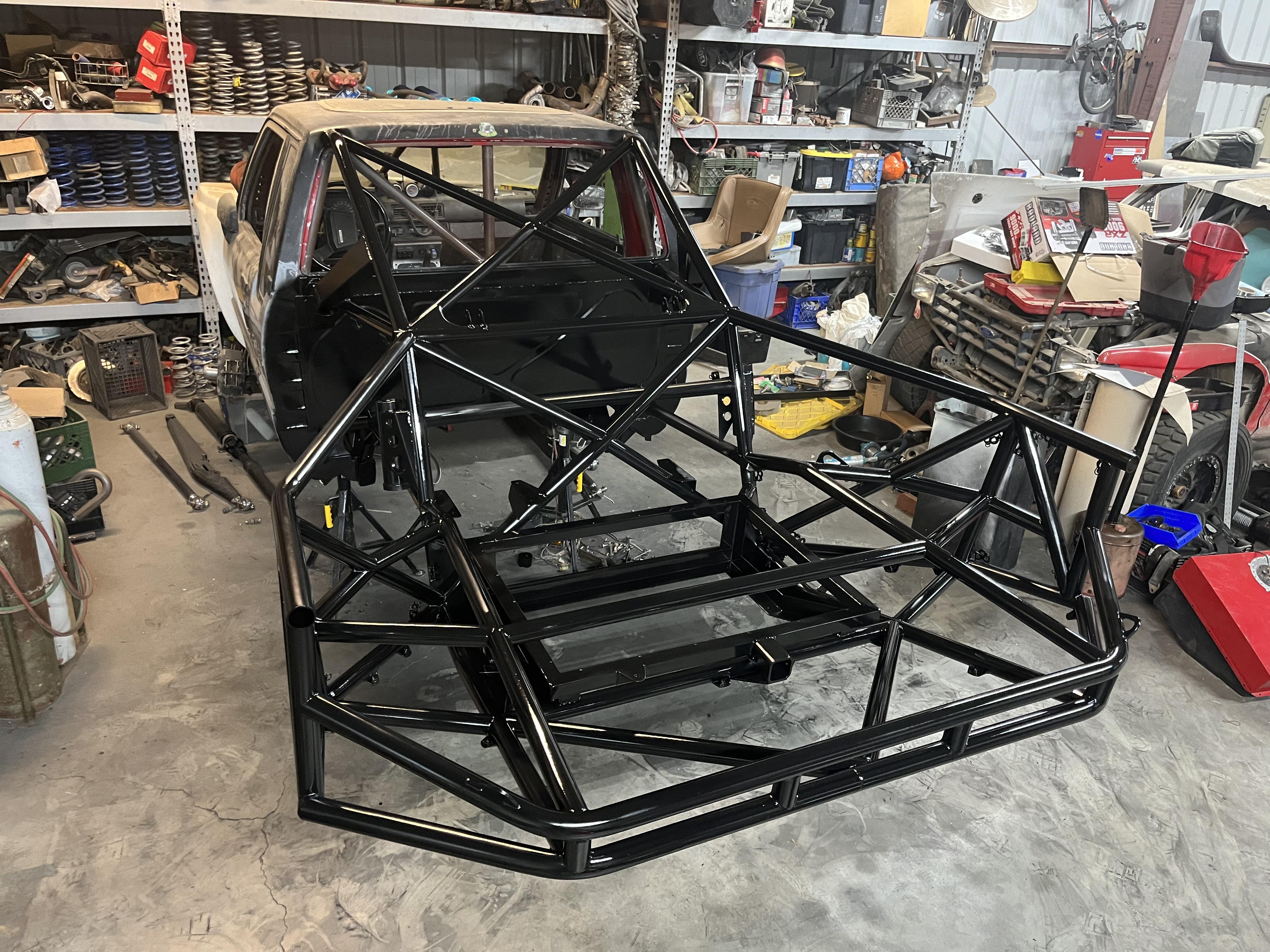

Materials:
2x heavy grey scotchbrite pads
2x medium maroon scotchbrite pads
6X 80 grit Bosch hook and loop discs
1 cup acetone
10x cans of Ace & rustoleum premium paint+primer gloss black
Masking: none
Beers: 2X voodoo ranger tallboys
Black boogers: 420
Percentage of paint wasted onto floor and unmasked equipment and parts: 69
Runs: 4; firewall and rear bumper. Damnit.
Trips to the hardware store to buy paint: 2
Times I muttered: “fuck, I fucking hate painting, fuck.” 666
Tools:
Makita orbital sander
Look at the fucking floor!
That dimpled sheet looks pretty sexy.. but hows that whistle on the freeway going 69mph..?
Also multipurpose with the pretty fucking sick shock cooler vents too.

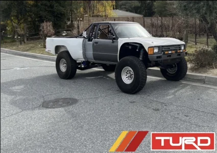

Breaking in the 5.43 gears.
(Motive gears, Strange 3rd, strange 40 spline spool)
Observations after 40 minutes of gentle~ish driving:
-need to put the muffler back on
-route exhaust so it’s not dumped directly under my seat
-windows need to be reinstalled
-aluminum paneling is hellaciously loud
-bypass clicking is louder than before
-37” tensors are nice—don’t feel curbs at all—mostly just “hear” them amplified thru the tin work
-Wilwood 4 piston calipers and race pads on all 4 corners makes for fantastic braking performance
-dick shift knob had uncomfortable ergonomics, so deleted that fucker

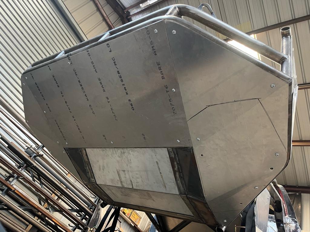

So rad seeing someone that is not scared to use oh 2 thin wall tube for stringers!
And who do I need to talk to for one of those large dimple dies for the formed gussets? I have been wanting one to use on rally car door bar gussets.
