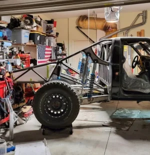

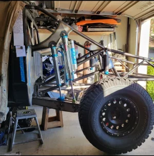

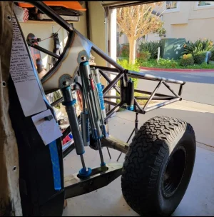

Hey everyone, I'm at the point where I need to get my oil and trans coolers. What are yall running and how do you have them mounted to your bed cage?
Currently I'm just running a stock 5.0 with 4r70w trans. I don't know if it will stay, or get rebuilt. But I want to get something that is adequate for 450hp. I don't want to have to budget new ones when I throw HP at it.

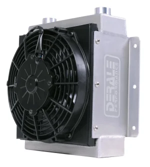

I ended up placing an order through Summit earlier today for 2 Derale Hi Flows. They seem like a new item that they have put out, so maybe untested? I did look at the CBR Large Off Road Cooler, but with a discount it was $300 a piece difference. $600 total is like 3 tanks of gas.. Very well could be a case of buy twice cry trice, but i haven't talked to anyone who's tried them out yet. Figured I'd be the guinea pig. Also ordered a Pyrotect fuel plate for when I build my fuel cell.
Yeah that style derale cooler should be fine for what you're using it for. Worse case, sell them and buy a bigger better one
