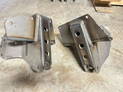

For the shock mount I basically plan on copying this design which is an OEM shock tower off an OBS F-250 tied into the stock coil bucket

The setup you posted will work good! One thing though is 14” shocks will be too long for that style setup with the extended shock mounts raised up off the frame on the front. Likely a 12” shock is what you will be looking for and will cycle well maybe even a 10”. You need to get the beams installed, cycle them and see what you can clear at full bump with the shocks compressed and then you can land the upper mount.
