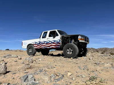

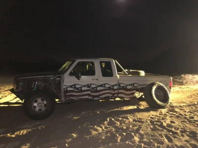

1993 F150
Extend Cab Short Bed
5.8L, 4WD and yes that is paint

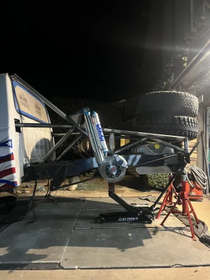

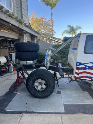

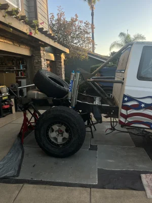

Current front end
- 4.5 Cho Beams - 16" 3.0 Bypass 14" 2.5 Coil 2.5x2.5 Bump - Dual Swing Steer -

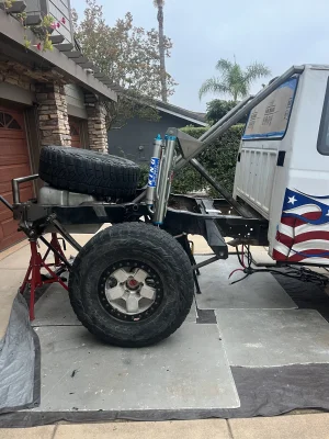

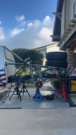

Rear
- Richer Racing Spring Under Kit - 18" 3.0 Bypass - 2.0x4 Bump

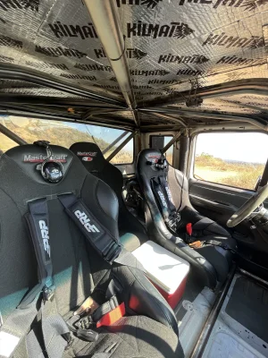

1.75 .120 Cab Cage - 3 full-size seats

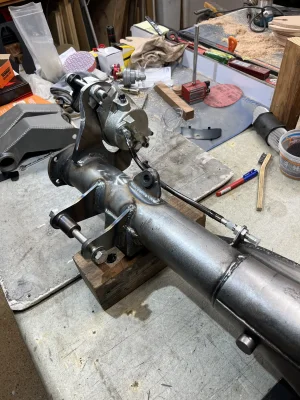

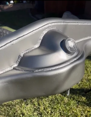

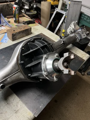

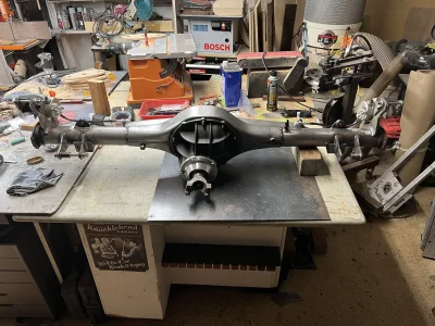

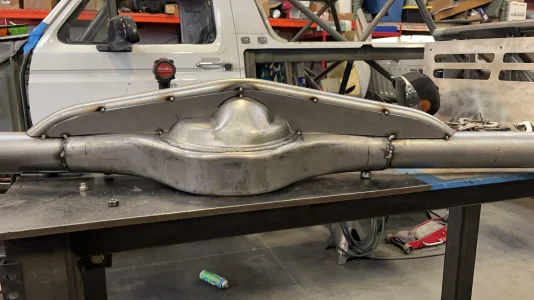

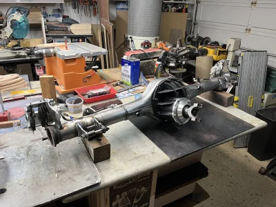

I've had the truck for 4 years now and should be in the desert here soon with a new back half bed cage, a new 9" with 4.88/ Detroit/35spline, and some new 3.5 18" 5 tube kings bypasses to try and make leaf springs fast or something dumb like that.

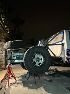

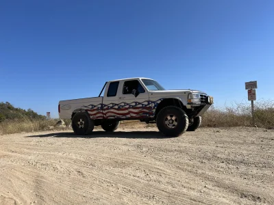

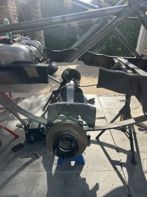

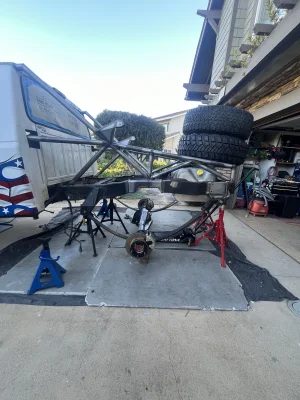

Pics of older iterations of the truck

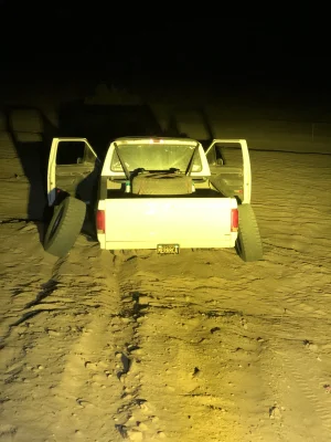

The first time I blew an 8.8 at devils slide- C-clip moment
The second time I blew up an 8.8 at devils slide
