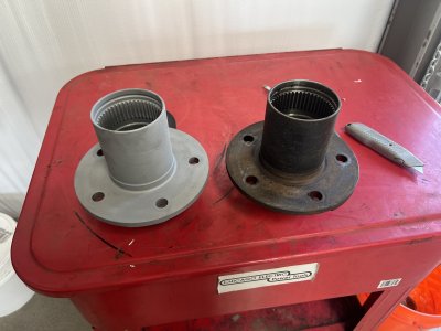

Cleaned up the hubs and spindles, ready for assembly

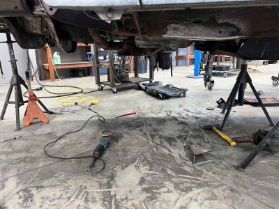

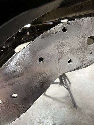

Got the old brackets stripped off the frame. Some jackwagon cut to top web so Im gonna need to fixt that up to move forward. Also have to reattach the mid body mounts, they got sliced off for god knows what reason.

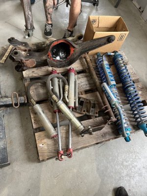

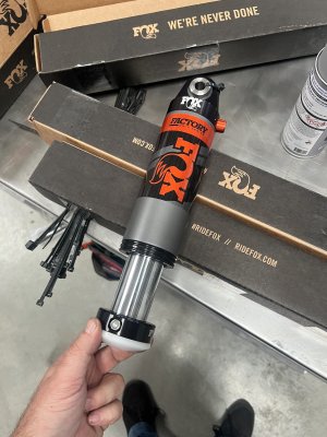

Shocks and bumps showed up, Shoutout to Sunny at Downsouth motorsports for helping me avoid the ridiculous lead times.
Sick welded eyelets to maximize ground clearance. 3.hoes
Can bumps go on the rear
Eyelet bumps go on the front:
3.hoes

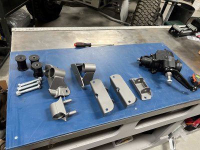

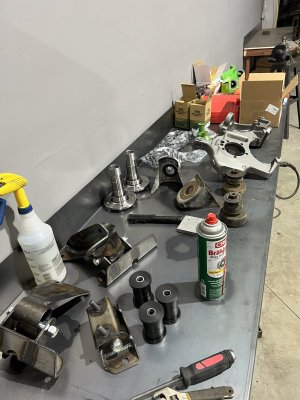

Autofab goodies to replace the clapped out motor/trans mounts and fresh steering components

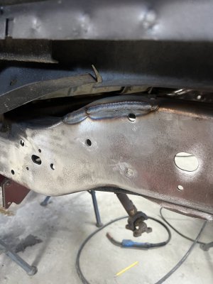

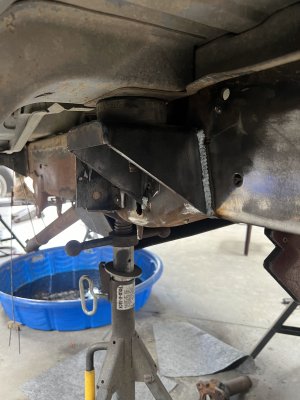

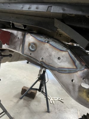

Fixed the chopped frame (dont mind my welding, im a bit rusty)
replaced the chopped off body mounts

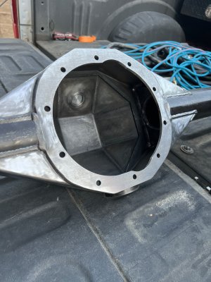

Got the new quick performance axle

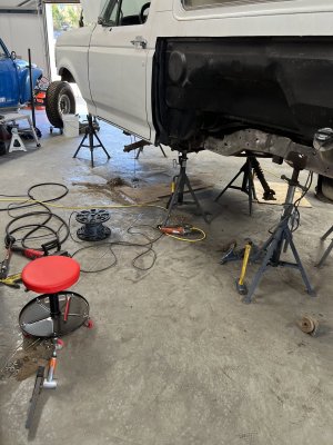

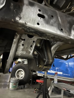

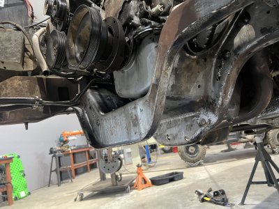

Cut off hopefully the last of the PO's shitty work, radius arm mounts. That sucked.

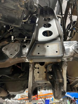

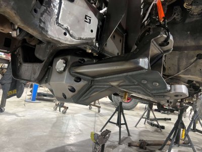

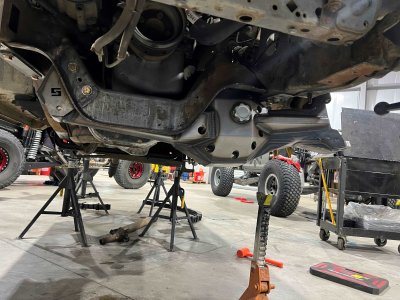

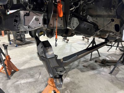

Got the solo beam brackets on, bolted and welded since the crossmember was cracked and wallowed out bolt holes. Got the shock towers hung (more rivets got cut out)
Beams hung and radius arm brackets placed

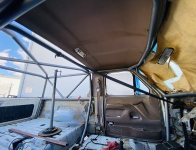

Oocho got around to building out my 3/4 cage

Clean and paint it before you put it in. When I did Andrew‘s cage, I painted each piece before even mocked it up inside the truck and then when I did the front section I was done fitting. I would spray paint the majority of each tube before I tacked it in it makes it easier Than masking it all off later and then not being able to get to some backside areas.
