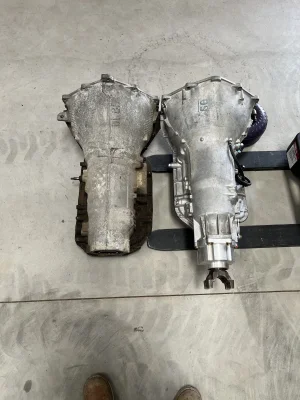

I have the SOHC and M5R01 swapped in currently, I was under the impression that running a TH400 will rob more power then a C4?
My extended cab Ranger has a 4l80e in an unmodified trans tunnel, but it's super tight!! (had to beat down the body pinch seam in a couple spots.)
I thought the 4l80e was same size really, except longer.
But your 4l80 isn't mounted behind a v6 in the factory location, so results may vary. I've done a TH400 swap on a SOHC 6.0L and nothing besides the exhaust (needs tubular headers) needs to be modified.
True... I figured there would be more room to mate to the V6? But now you got me thinking maybe not, because the SOHC could be sitting up higher...
So yea, someone try it and let us know. hahah.
@marcytech was talking about this swap. Maybe he has some info.
Juan says a 4l80 wont fit in the factory trans tunnel on a ranger/explorer. Hell the TH400 is tight, so he might be right. I've never personally tried.
It's basically the same trans (same outside dimensions "roughly")....just a little bit longer.
