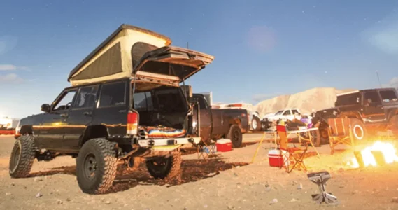

Somewhere between van-life, Jeepspeed, and overland inspired on the 2000 Cherokee build.
More and more it's headed towards a prelander build - keeping things simple and strong.

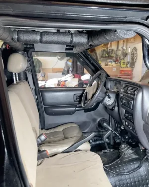

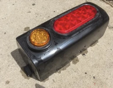

Everything has been one big DIY project - apart from the cage and sliders that were professionally built.

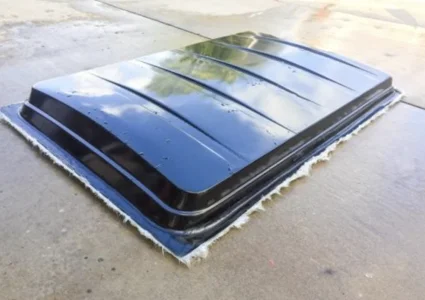

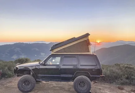

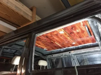

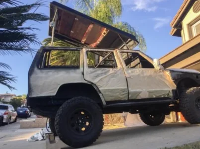

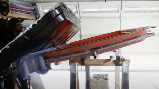

The camper top was the biggest project. What started as a rough retrofitted Westfalia top turned into a full garage fiberglass build.

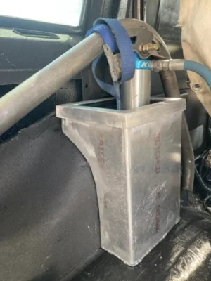

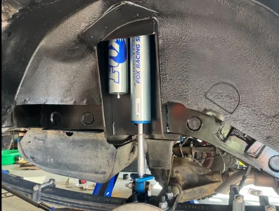

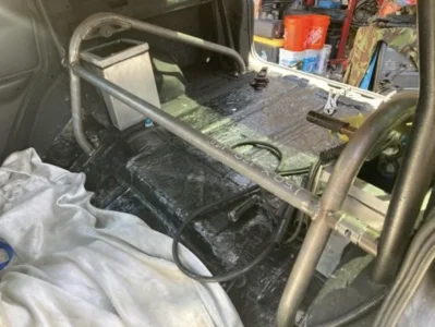

This thing is rad! The fiberglass roof/ tent is something ive never seen on an XJ before. The shift boot idea is badass. When I built the shock towers for the rear of my XJ i went with 1/4” plate that acted as both the mounts and kept the cab sealed.
Whats the front suspension setup?
Appreciate it - this build years ago grafted a westy top onto an XJ, but other than that it's been a first.

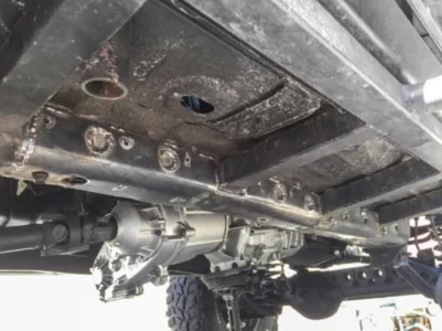

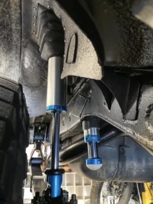

That steel plate job is clean too! In hindsight I've thought about going that route - Boostwerks makes a similar kit.
The tube and aluminum box is all bolt-in though if I change direction on shock size or configuration down the road.

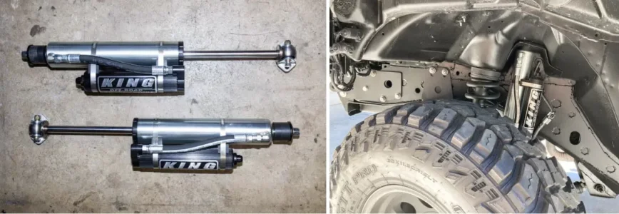

The front has a set of the King 2.5 OEM, IIRC they come out to around 10".
