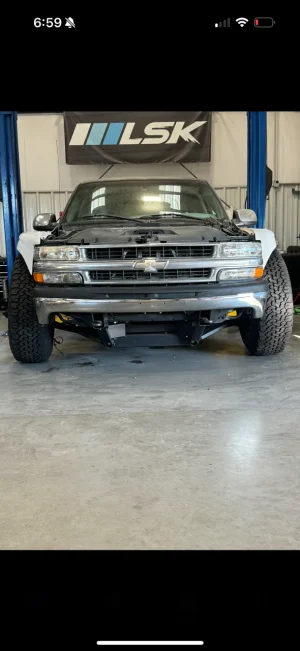

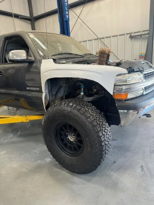

Got the glass, bumper on to do initial trimming. If anybody has any tricks on getting fiberglass cut lines strait Id gladly accept them. Also got my Bronco back from Richer racing. Those guys are awesome.

I make sweeping marks for the cut I want with a pencil. Once I'm satisfied with the shape/smoothness of the curve, I go over it with a marker and use the cut off disk on an angle grinder to cut just short of that line. Then use a flap disk to bring it to the cut line. Once I have it pretty solid, I wrap my sandpaper around a small 2x4 block and use that to hit the lumpy areas. That's been my method I've used on maybe 10 sets of fiberglass now, and it works well.
More pics of the Bronco! Jonny and Andrew and team are cool dudes!
yep, cut off wheel, flap, sand is pretty much the same way I do it. If you do a good enough job with cut off wheel, no need for flapping. Flap moves material super fast, so gotta be careful

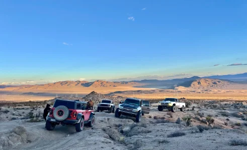

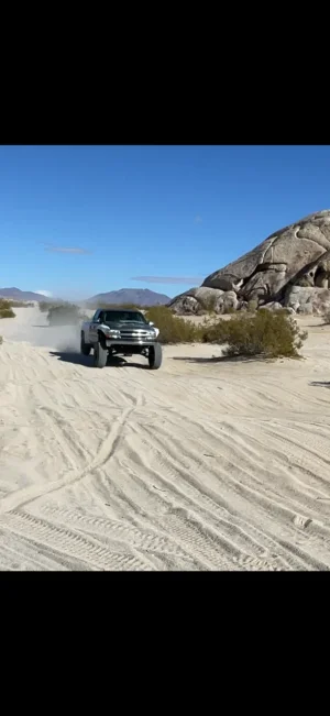

First trip out had typical teething problems but was a ton of fun. Blew the return line off the steering box and the tail lights fell out. Waiting for front axles to get here from RCV, I bought a 14 bolt out of a dually to get the rear the correct width without spacers and added 4:88 gears and a true track. Needs some shock tuning, paint/wrap, bumpers, and the rear springs need another leaf as they settled 2-3 inches. Hoping I can get it all done by KOH. FullSizeRender.webpIMG_7102.webp

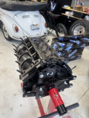

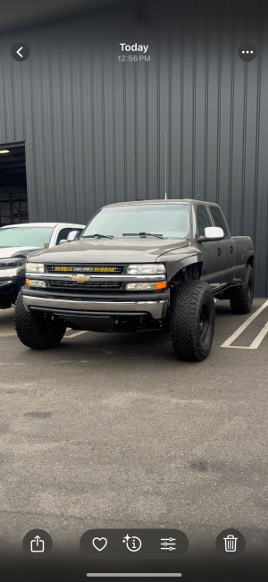

Little update. Got it back from paint and built a clean little front bumper/ skid. Also building a new lq4 with lq9 pistons, cam. ring gapped, studded, ls9 head gaskets and rocker arm trunnion kit for some potential supercharger action.

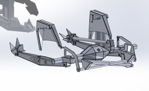

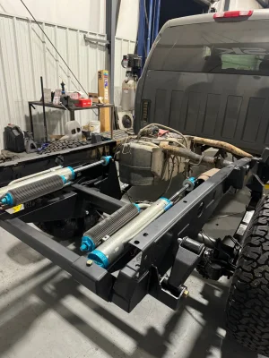

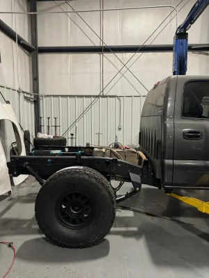

Little update. Got the new engine installed, runs awesome. Designed a rear track bar link kit with 12" shocks. Going to cut all the cantilever/ leaf stuff off. Works ok but lots of chassis flex with this long of a truck and no cage and the 14 bolt is too heavy so building an 8 lug 9" axle.

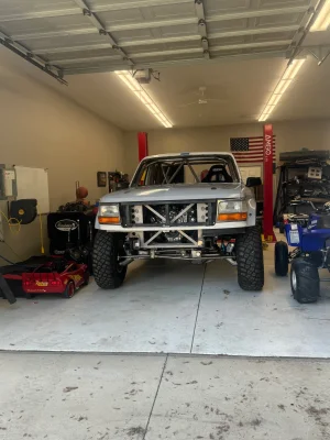

Weight is nothing to write home about. I run the stock axle to cut time and cost. I don't even gear my trucks anymore!
I would have agreed with you when I built this but the dually AAM 11.5 axle is 670lbs with brakes and fluid. It keeps mule kicking even after 300lbs of ballast, and a couple of re valves.. The front works so well and I really want the back to keep up. The 9" is also just more fun to add link pivots to and looks a little cleaner. That ford is awesome I keep telling people to build those old super duties.
