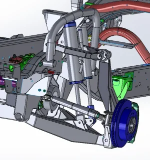

Building a revised version of this kit that should be about 90" wide instead of 94". 16" bumped and strapped should still be possible and stay within RCVs recommendation on the inner CV angle. Got rid of the high clearance lower arms because they're a pain to get a normal jack on. Adding machined tie rods, and machined swingers. Should look a little less ridiculous.
