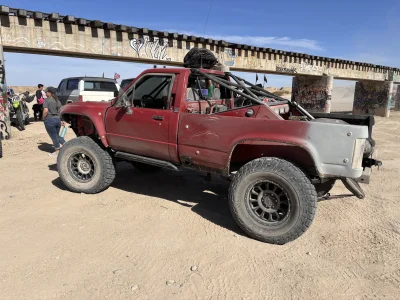

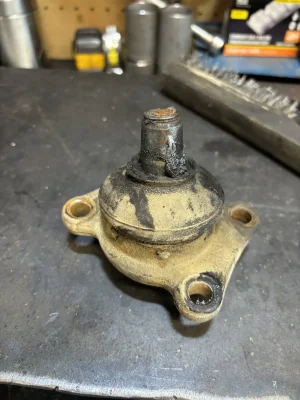

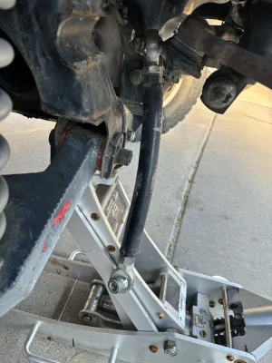

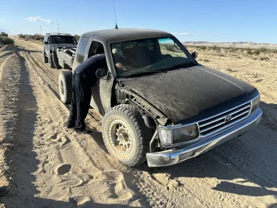

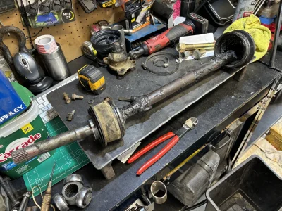

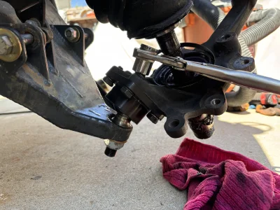

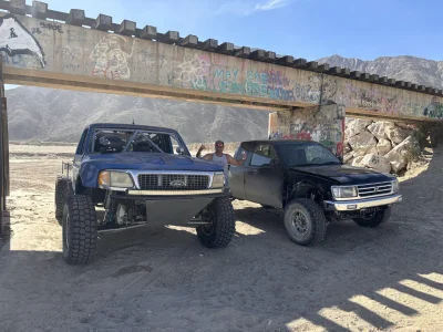

Back at the end of April we went out to Plaster City to take advantage of the relatively cool weather out in the desert. Snapped my lower ball joint and my buddy lost axle. I think I posted some pics in a different thread. But here are a couple of pics just to recap.
Once I got it home, I replaced the ball joint, tie rod, some bolts and fixed the CV boot and bent back a couple of other things.

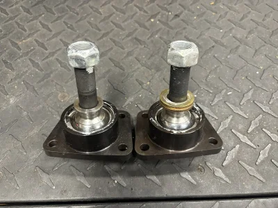

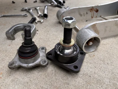

I was able to pick up a set of Total Chaos lower uniball conversion kit off of Race-Dezert. Haven't put them in yet but will soon.

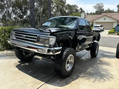

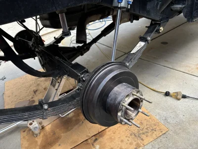

I took out the two smallest leafs out of my Deaver H70HD to see if I could soften up the rear a bit and put it all back together. Stoked to get her back up and running.
Gave her a wash this morning and drove her to work.

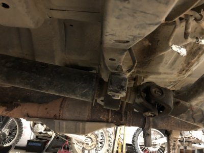

I would plate in the carrier bearing mounts they tend to rip off after some abuse

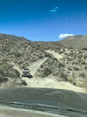

Ran out to the desert for a day trip on Sunday. 98* at 8:30am. 109* at mid-day. I think we were the only idiots driving through the desert that day.
SD > Plaster City > Split Mtn. Road > Fish Creek Trail (had to turnaround because we got lost) > Carrizo Creek Trail > S2 highway > Stagecoach RV Park > SD. 11-hour day.

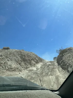

Going up Diablo's Drop

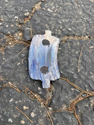

that pad still has some life in it.. I'd reinstall

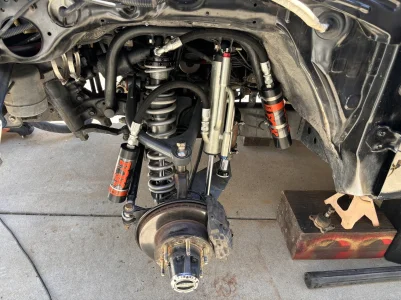

Installed lower uniballs

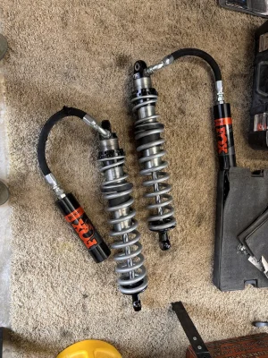

Re-valved my front coilovers to #30 (all .008 valve stack) for both compression and rebound

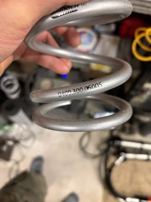

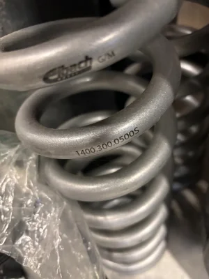

Replaced my 600# 18" spring with a dual rate 500# 4" spring and a 500# 14" spring
Dropping down the valving and the spring weight has helped smooth out the street bumps. No more harsh hits like going over speed bumps. It will be interesting to see how it feels out in the dirt. I'll probably be dropping down a valve stack or two for the rebound in the rear bypasses.

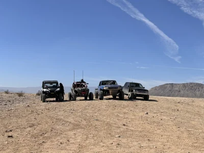

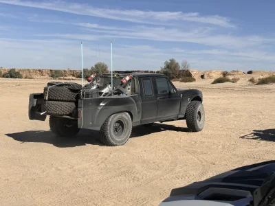

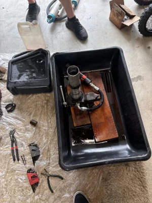

Went out to Plaster City/Superstition area for a day trip with a friend (F150) and his friends (SxSs). Knocked out about 60 miles. Great weather, drank some beers, covered some fun dirt miles. Truck did pretty good with the new shock valving and spring setup. Made it through the whole day up until the last .25 mile. Lost my brakes all the sudden and power to the rear end. Once we got back to camp, I realized that the rear brake hardline fatigued and sprung a leak running into my proportioning valve. So I took a bleeder valve out of one of my drum brakes and screwed it into the leaky line hole and got back brake pressure to the front brakes. Good enough to get me home. Had one more beer and took off for home. Got right around Buckman Springs off the 8 and lost all forward power. The truck was in gear but wasn't going. Finally pulled over and realized that my rear diff shit the bed. Since I didn't want to wait for AAA chase truck to come, I locked my front hubs and put it in 4WD high and drove home. Fuck ya!

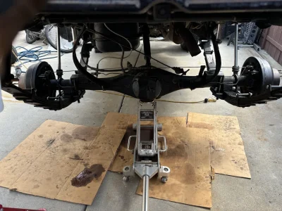

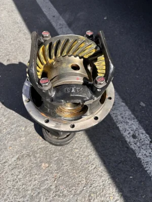

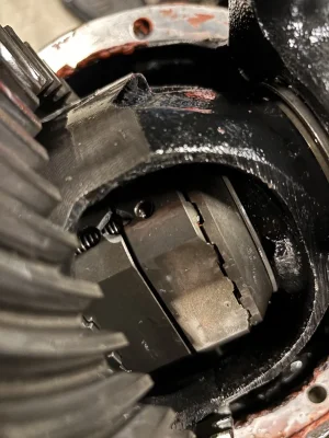

So now I'm on the hunt to replace my rear diff. I replaced my stock, open diff with one of those lunch box lockers. That thing was garbage. I think it last me about 8-months. I'm currently running 4.10 front and rear gears. If I was to go with a 4.88 rear gear and keeping the 4.30 gears in the front, would that put too much strain on my setup when running it in 4WD in the dirt? Trail-gear has a deal going on for a setup 3rd member for my truck but they tallest they go is a 4.88 gear ratio. The 4.10 gear setup works pretty good since I try to daily drive my truck and I'm only rockin' 285 sized tires. I'm planning on going electronic locker this time around.

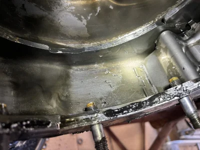

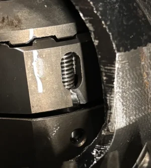

Opened up my diff to assess the damage. Lunchbox locker shit the bed. All the pin/spring slots were cracked and the teeth are rounded off. Spoke with San Diego Gear and Axle (El Cajon). Showed him that locker and he said that is a common issue on those. He said they are junk.

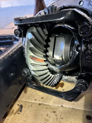

Picked up an Eaton electronic locker from a guy on OfferUp. He put it all together years ago but sold his project and had it laying around. Came already assembled and with wiring harness. Took the new diff and my old ring/pinon to SD Gear and Axle to switch out the 5.29 gears to my stock 4.10. Steve (@SDGA) said I didn't need to break in this new diff because I've already been running it in the past. One day turnaround on the gear and pinion swap. Cost around $470. Super cool guys at SDG&A. Fingers crossed that this new setup holds up (at least longer than 8-months).

Not sure if maybe I installed it wrong but I had my buddy who runs a auto repair shop look over my work and he said it all looked good. I also daily my truck (when it's not on jackstands) and maybe driving on it on the street on the daily just wore it down super quick? Don't know. But it would do some really weird stuff when it would release and re-engage. My buddy was telling me that maybe the way it was made was just dog shit. He says that he believes that parts aren't made all that well nowadays. He's had a handful of parts just break apart because they were produced poorly.

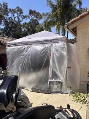

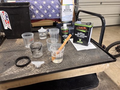

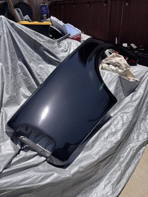

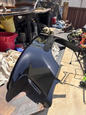

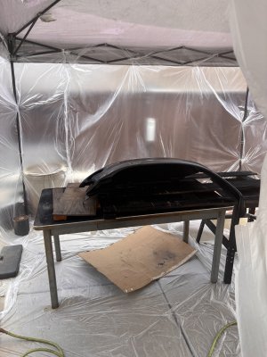

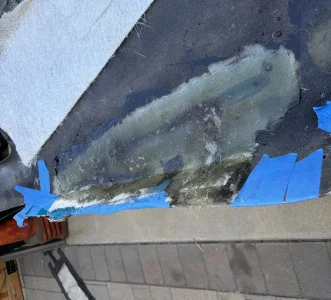

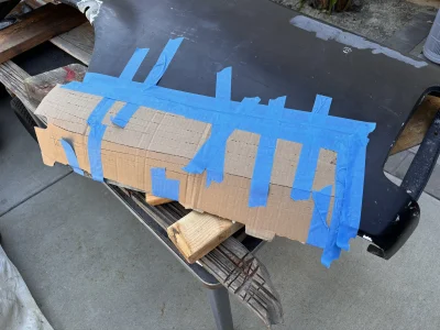

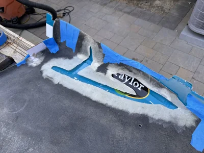

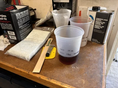

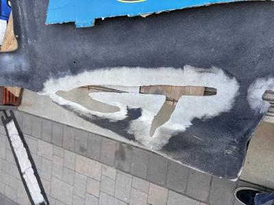

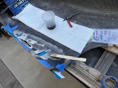

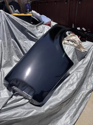

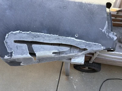

Finally had time this weekend to get the final coat of clear on my fenders. Not proud of the final results but I'm happy that they are all black now. They are far from good but good from afar.
Here's my paint booth setup:
I could have easily spent another 2-4 more days sanding to get my fenders all nice and smooth. But, NAWWWW... Ain't nobody got time for that. I just wanted them black and painted. It's an off road truck, not a show truck. Once the fenders get sandblasted it's all going to look like shit anyways.
I learned a lot about the process and now I know how to do it wrong as well as right. Someday, when I have the time, I'll do it right but that time is not right now.

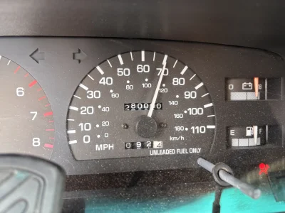

On another note, I hit 280,000 miles.

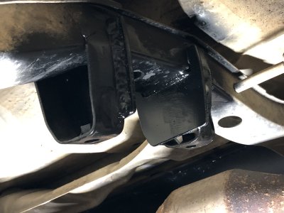

How would you do that? Any visuals of plating it in?
Super late response to this one, but just in case you still need to plate yours in. Here is my Tundra with bent as shit carrier bearing mounts. I had the Bruno Fab billet Carrie bearing, which I think caused the fuckey seen here as the Spicer unit I ran before never caused a problem, despite being on the truck twice as long as this one.
I pounded them straight and plated them in as shown below. I left the gap at the bottom for water drainage.
So far the mount hasn’t bent after plating, but the vibrations from the billet carrier are even worse now. I have an IE Driveline unit that I’m going to put on shortly, but it requires a fully fabbed mount.
Ahhh... Ok, got it. That makes more sense now that I can see it. Looks like something I can pull off without much trouble. Thanks for the tip.
