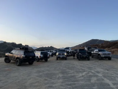

Our go-to staging area off the 15 North on Gopher Canyon

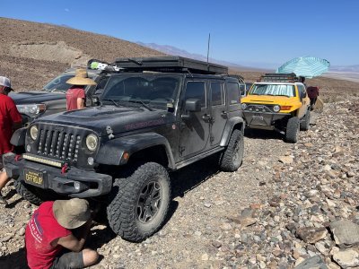

First trail of the trip. Another stop for refreshments and more talk about each other's moms.

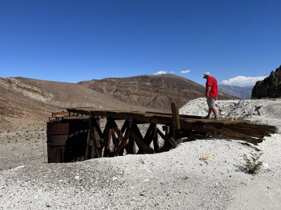

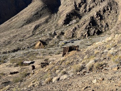

It's amazing how quickly you can gain altitude out there. This particular trail took us up something 3,000-4,000 feet in like 2 miles. Half way up the trail we came across this mining operation. Every time we come across places like this, it blows my mind on how they could have gotten this kind of equipment up such steep and rugged terrain without the help of vehicles.

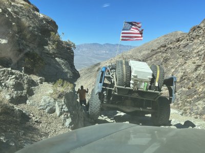

Tight trails make for puckered buttholes.

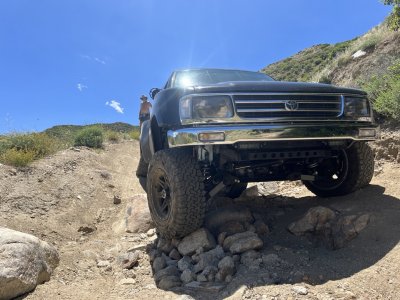

Trail ended a little too soon. Rocks needed to be stacked.

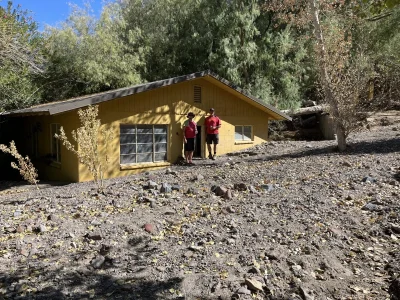

Warm Springs Camp/Resort. This camp is located on Mengel Pass. It's literally out in the middle of nowhere. Multiple structures and would say there are some modern amenities like: drywall, legitimate doors, insulation, electric light fixtures, hot water tanks, thermostats
and pool. Unfortunately, the 1,000 year storm washed a bunch of mud and sand into the main structure burying the floor and ruining some of the walls and doors.

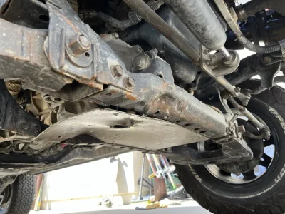

On to the geologist's cabin. This long, straight shot is a blast. Finally had a chance to test out my suspension. Made it all the way to the bottom and G-out at the end. Hit hard on something all the while laughing our asses off.

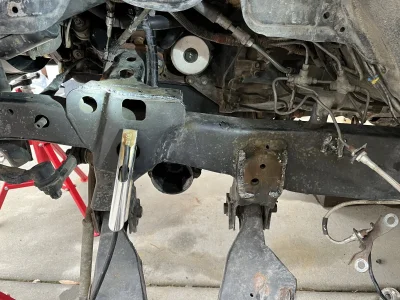

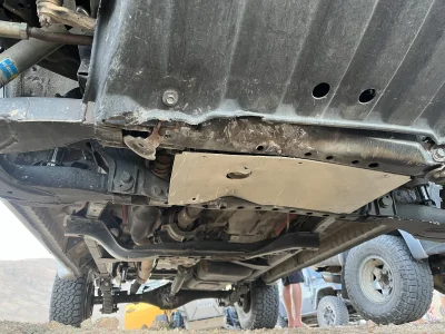

Both crossmembers smashed and tweaked. Little did I know at the time, my front transaxle was leaking because the front crossmember was pulling up on the front mount which broke the gasket seal.

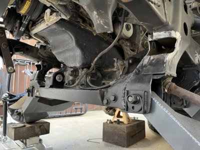

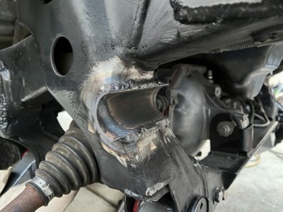

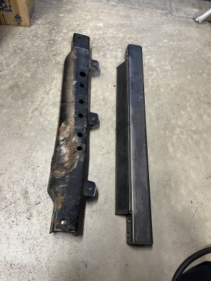

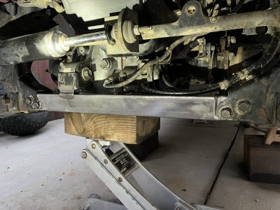

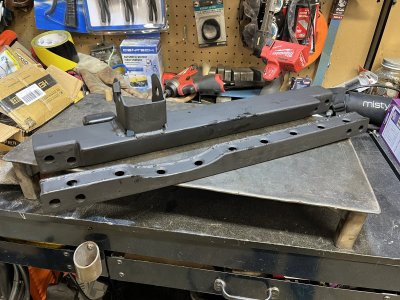

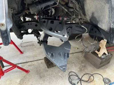

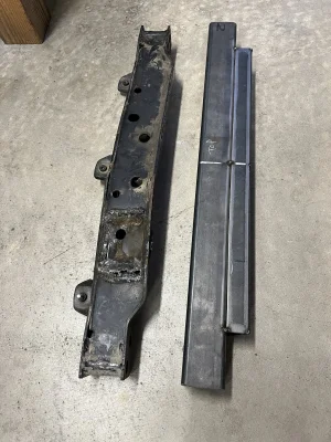

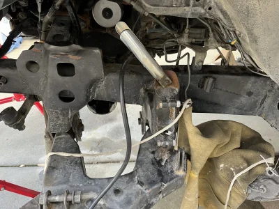

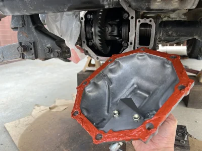

So after last year's Death Valley trip, I smashed my front suspension crossmembers and made the decision to upgrade the control arms and go coilover.

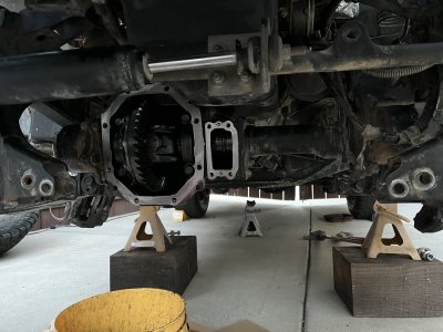

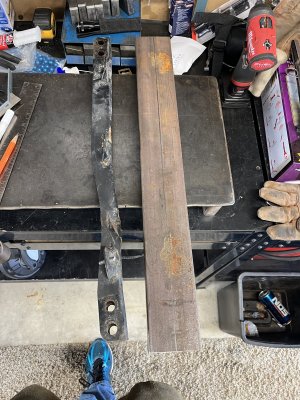

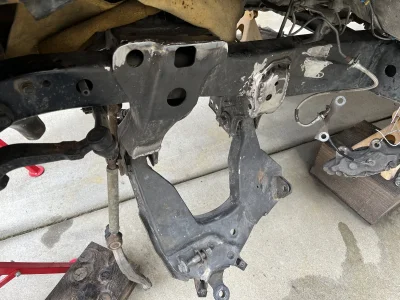

Here's the extent of the damage to front crossmembers. It pushed up and it broke the seal on my front dif which was making it leak. Removed the crossmembers and fixed the gasket:

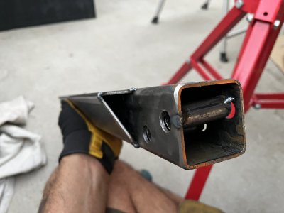

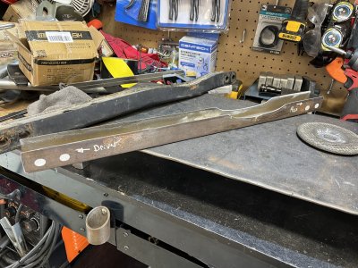

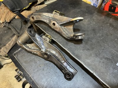

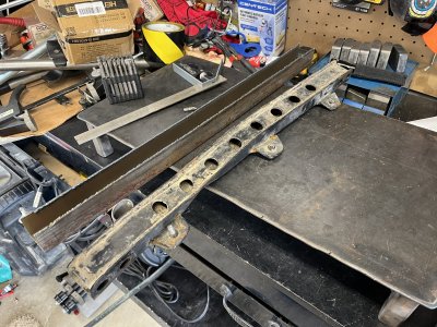

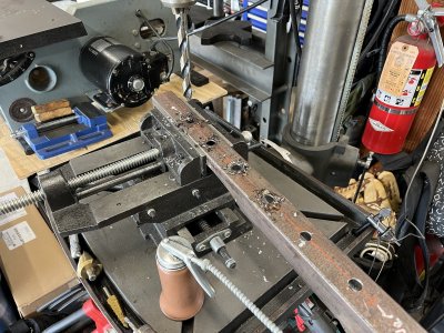

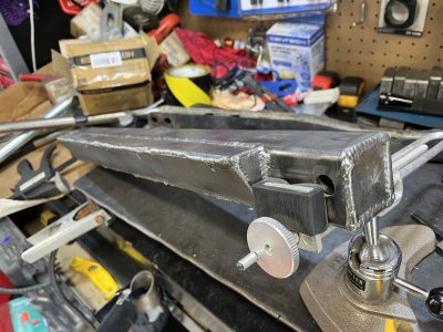

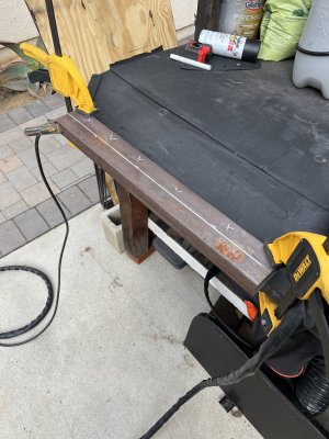

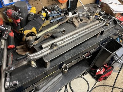

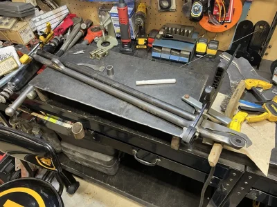

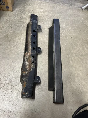

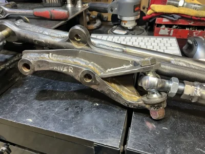

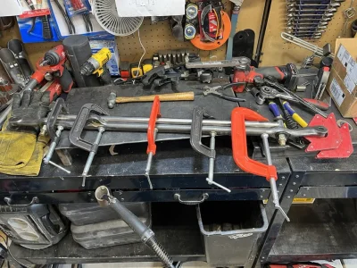

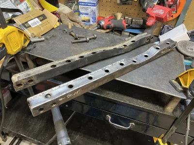

I tried my best to find some junkyard crossmembers but couldn't find any. So I started making my own. Here's the front:

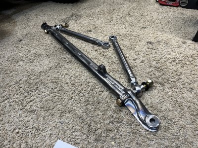

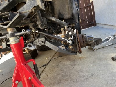

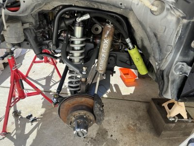

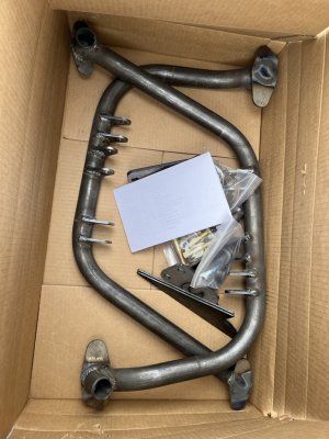

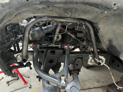

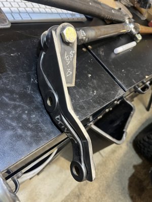

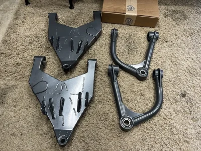

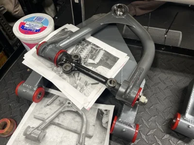

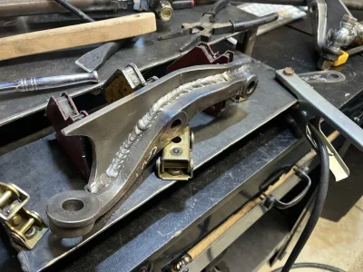

Went with the JD Fab control arms and shock hoop:
Had to wait a few weeks to get new upper control arm mounts. I was able to save a few hundred dollars by getting them from outside the country:

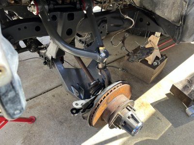

Got them mounted on the truck

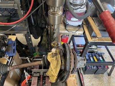

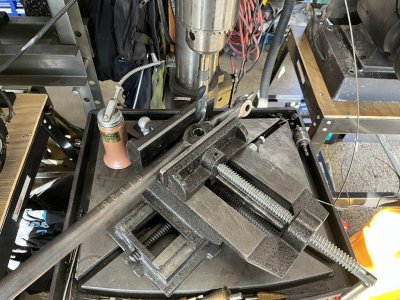

Drilled out the spindels:
The JD Fab shock hoops:
Mocked up:
The hoop got burned in:

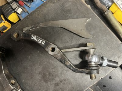

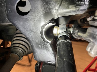

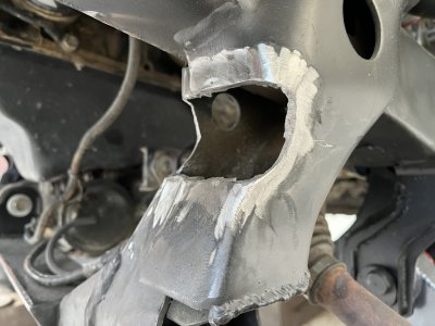

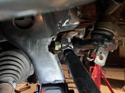

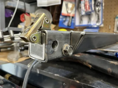

After getting everything put in, I notice that my "new" steering setup was catching on the lower control arm mount. So I had to "Clarence" by cutting out a notch. Used some tubing to box it back in. Could have done a better job making it look better and such but was in a hurry and sent it:
D7CD9E8E-F2E4-4280-89B9-5F4E4B3EFF8F_1_105_c.webp6D28C049-78A4-4F5A-8084-3F5BDBD2C1C0_1_105_c.webp7FF9D647-6E2C-4868-A600-BAD7232584D3_1_105_c.webp6F3B193E-1A0A-41B2-A094-0E7D2EE6BCA1_1_105_c.webp190C3E04-9AA0-487E-886E-1E66047F919E_1_105_c.webpDDC2F32A-4F7B-4B30-945B-70C88509C9D9_1_105_c.webp

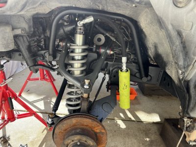

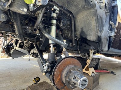

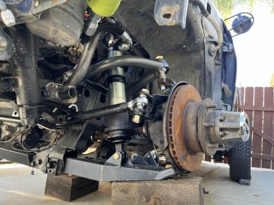

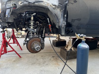

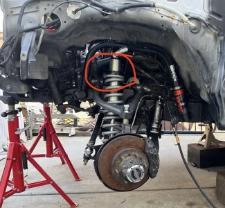

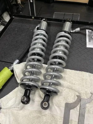

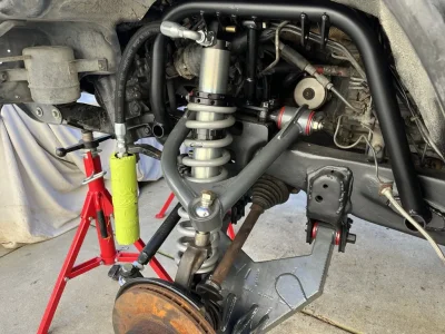

Mounted the coilovers:
A8F0F436-273F-4A46-BE9F-99A1AEBB6552_1_105_c.webpB2AE7AD9-3DD8-4B84-BFAA-1020F7701F44_1_105_c.webp
Burned in the new limiter straps:
Realized that the shock hoops had some gussets that I forgot to put in. So more welding....:
98223E98-07EB-45A9-8891-6A6264CAA0DD_1_105_c.webpC92C380B-A750-4B8D-B8AD-680EDFEC9A7A_1_105_c.webp
The last item was to get the bump stop put back in. My concern was, where or how to orient it properly since I do not currently have a bypass shock. So I made a mock up. I used my old 3" exhaust pipe that was laying around. So siiiicc...
4E419B77-7454-4459-8AD2-649A9EFE8BB9_1_105_c.webpE5FDD49F-410A-49D6-9702-A65B26CC9CAD_1_105_c.webp5A8198BE-BEC5-430C-B14D-19572DEEA7BC_1_105_c.webp
Filled the shocks and the bump stop:

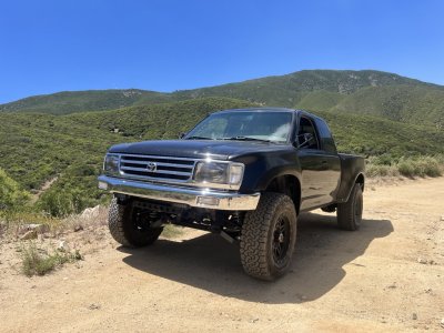

Slap this bitch together and got her back on the road!!!!! 7 months of sitting on the side of my house.

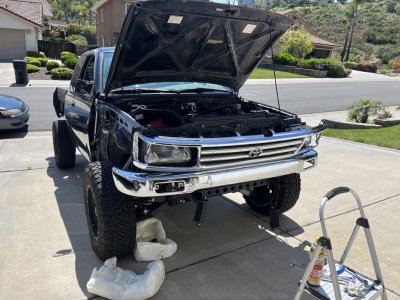

Put a new grill, front headlights, corner markers and bumper:

Got to take her out this last weekend for her first shake down on Oriflamme Trail with my boys. A definite upgrade over the torsion bar setup:
