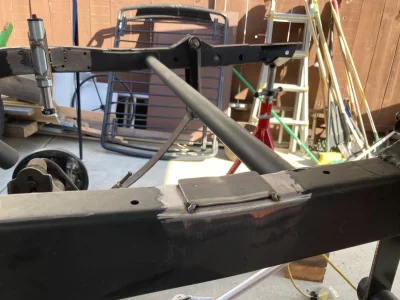

Another update. Getting ready to start building the bed cage.

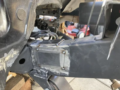

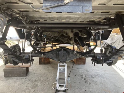

Frame pads/reinforcement:
Lower shock mount:

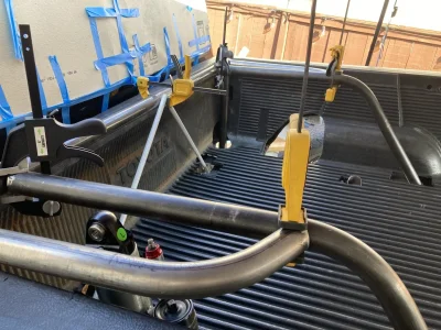

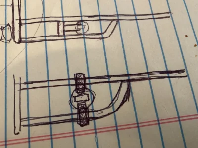

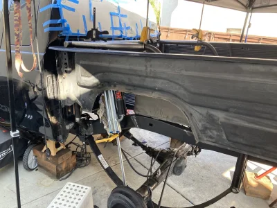

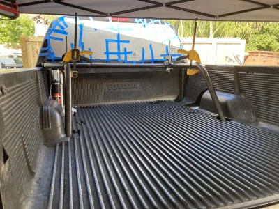

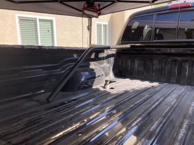

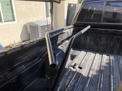

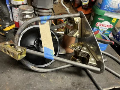

Bent my pipe. Quick and dirty mockup:

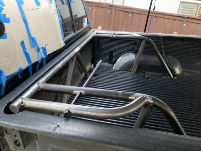

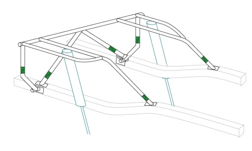

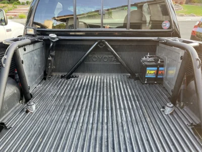

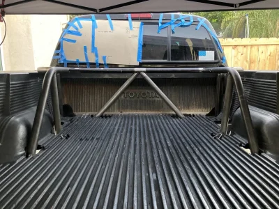

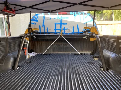

Here's my plan for the bed cage. The green spots are tube connectors. I want to put those in, in case I need to take the bed off. 3/4 view:
Top view down on my upper shock mount (bottom):
You guys see anything funky? Feedback is always appreciated. Thanks!

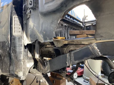

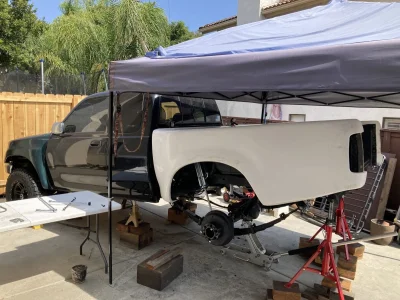

Slow progress but progress nonetheless. Put some heavy 3-days in while juggling, kids' soccer games, practice, work and wifey stuff. Made some pretty good progress though. Got 2 weeks to get this bitch back up and running. Otherwise, I'm sittin shotgun on this year's trip.

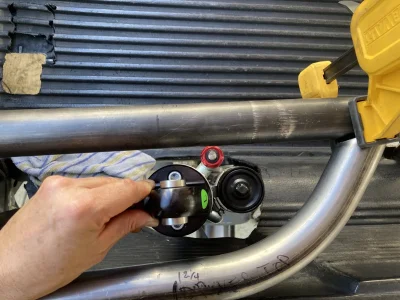

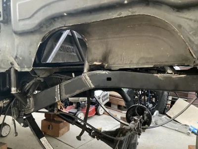

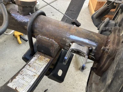

Went full commitment on the mount on the side of the frame, all the plates on the frame, bottom shock mount and the notched frame. Burned it all in. The cage is going to be tacked for upcoming round.
Did a lot of notching and grinding. Most of the tubes are decent enough to tack on. The passenger's side double sheer tube has a sizable gap that I'm going to have to fill in.

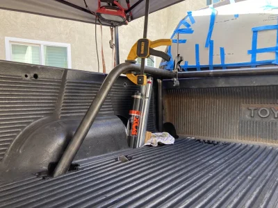

Don't criticize the fitment too hard. I realized that I had to cut out more of the top plastic bed liner to get it to fit right.

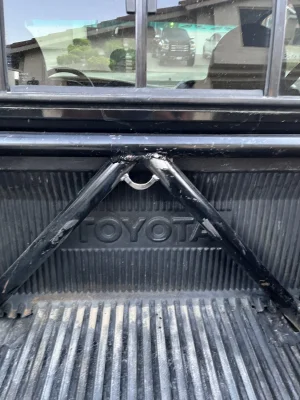

I plan on drilling through the two tubes and welding in a pipe for the upper shock mount.
More mock up for the diagonal support tubes.
As always, any feedback or critique is welcome. Thanks.

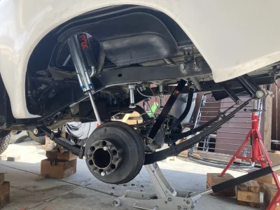

Coming down to the wire (leave for Death Valley on Weds) but more progress... Welded in the cage, put in the leafs, bump stops, limit straps, dropped off the drive shaft to get balanced, got new tires, plugged in all the brake lines, hooked up a couple of little things here and there.

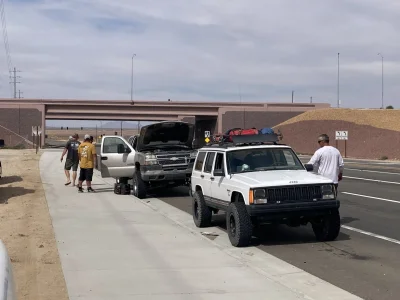

The next morning was our last. Woke up and headed back to Lone Pine to get the tow rigs. And... of course I got a flat on the way out. On top of my check engine light coming on and some new grinding noise that only happens in 4th and 5th and slew of new rattling noises. The truck held together by everyone's surprise as well as my own.
On the way home we called to check on one of our friends and he said he was having alternator problems. Once we caught up with him at Ketner Junction, we learned he also was pissing tranny (gender confused) fluid. So we unloaded the Cher-o-kee and put that pig up on one of the trailers and drove home. Once in SD, was treated to one of the craziest lighting and thunder shows I've ever seen. I would have to say, it was a good day.

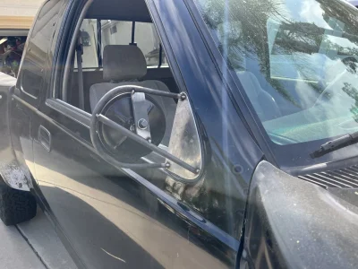

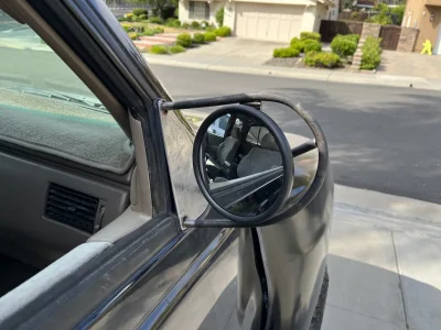

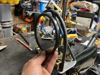

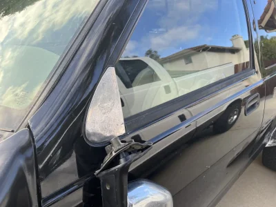

My side mirrors have been buggin' the shit out of me. The mirror vibrates like fuck and it makes everything super blurry. Pretty pointless really. Saw a picture of a LT Toyota for sale and it had some Baja mirrors. Figured that would be a fun project to work on.
IMG_1551_1.webpIMG_1553_1.webpIMG_1554_1.webpIMG_1559_1.webpIMG_1560_1.webpIMG_1561_1.webpIMG_1563_1.webpIMG_1564_1.webp

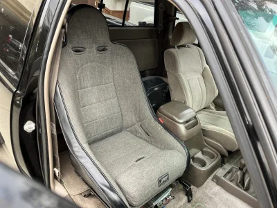

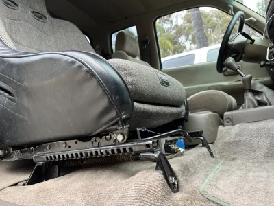

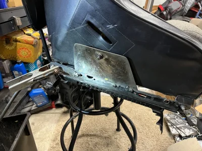

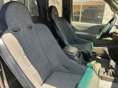

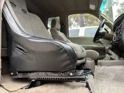

Then I picked up some used PRP seats off of Race Dezert. $350 for the pair. Small rip on the piping on one and a small tear in the back pocket of the other one. No biggie to me.

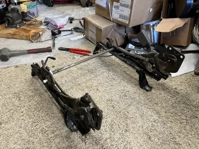

I tore apart my stock seats to retain the slider mechanism. I probably could have saved myself a lot of headache and bought some off of ebay but fuck it. Figured I would go cheap and use what I had. Lots of cutting, grinding, welding and ruined a perfectly good set of stock bucket seats to get these to work.
IMG_1611_1.webpIMG_1612_1.webpIMG_1613_1.webpIMG_1614_1.webpIMG_1584_1.webpIMG_1583_1.webpIMG_1582_1.webpIMG_1615_1.webp
They're a little tight on the door side but overall they fit pretty well. I definitely feel more connected to the truck. The sliders work well and are necessary for me to get in and out of the driver's side. Getting in and out of the extra cab is a lot harder though. Luckily my kids are still small so not much of an issue yet.

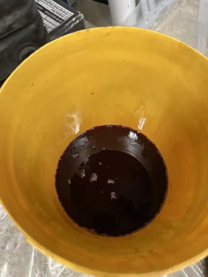

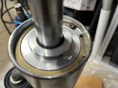

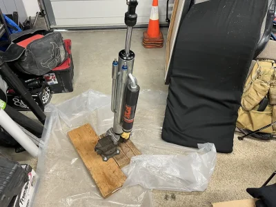

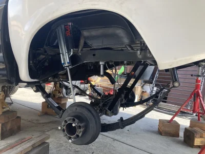

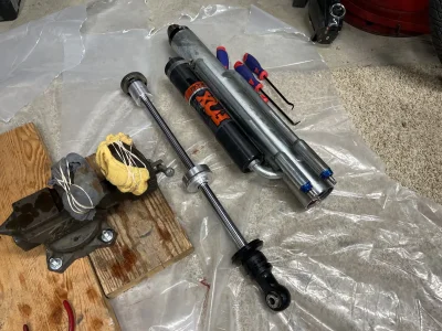

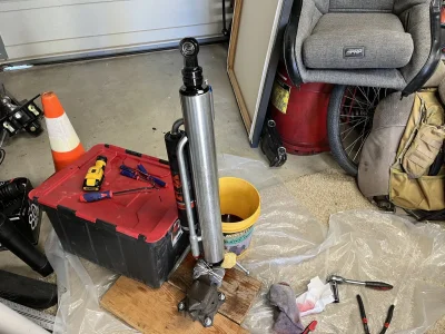

Then I got a wild hair up my butt to start adjusting my rear shocks. Since I've put them in, I've never fucked with them other than dropping the nitrogen pressure. I know now that, that's not the right method. So doing some reading on adjusting the bypass tubes, I figured I would make some adjustments myself. Little did I know that on my Fox bypasses, there's no locking nut on the adjustment screw. I thought the big nut was and I loosened it. Loosened it a little too far and it started puking shock oil all over my driveway. I was able to get the adjustment bolt back in there to stop. $600 in tools, nitrogen tank, regulator, hoses and shock oil, I now have the ability to service my shocks. An unexpected forced shock learning event. Glad I spent the money for the tools opposed to paying someone the same money to do it for me. Learned that from you guys.
What was left of the shock oil.
Back together.
I filled my nitrogen level up to 200psi. Is that correct? What do you guys fill your nitrogen level to?

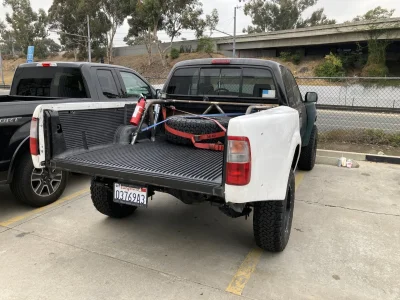

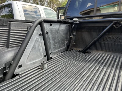

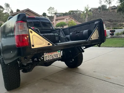

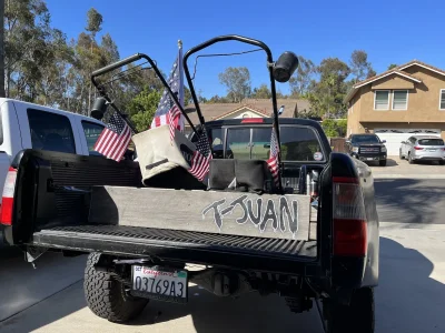

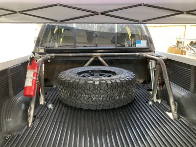

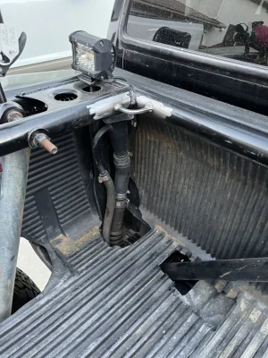

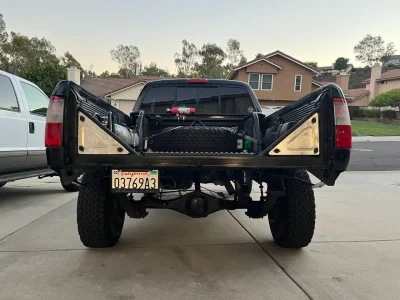

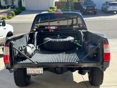

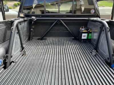

Added some more bed cage hooks. I freehanded these with my plasma cuttle. I know... I know... You would have never guessed. "Precision-like" computer aided design. The one is the middle is my favorite.

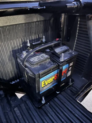

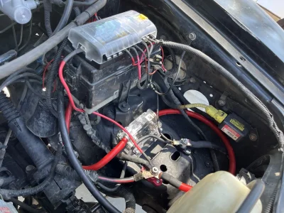

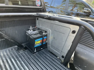

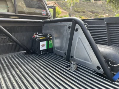

Then I worked on relocating my battery into the bed of the truck.
Then outfitted the truck in it's proper glory (twin lawnmowers in the back) for 4th of July.

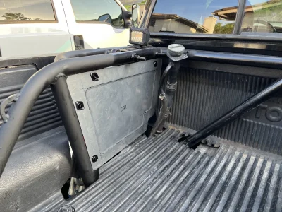

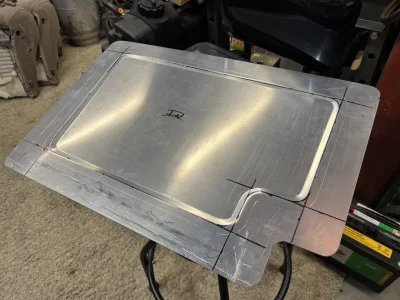

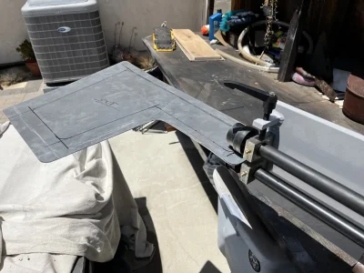

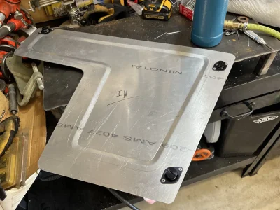

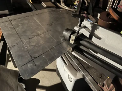

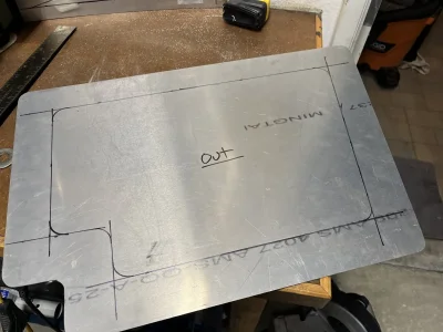

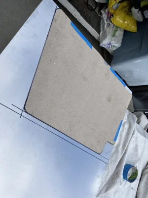

Been working on some more little piddly 1-2 day projects. Bought a bead roller and some aluminum sheet metal so I could fiddle around with making some panels for my bed cage to enclose my back shocks. Hopefully it will keep some of the dust and rocks from flying into my bed as well as keep some of my gear from falling down into the bed holes.
Worked on one test piece before diving into my actual panel. Didn't take long to figure out the right amount of pressure for the dies and just went real slow on the hand cranking while turning the corners.
IMG_2277x.webpIMG_2278x.webpIMG_2286x.webpIMG_2289x.webpIMG_2290x.webpIMG_2308x.webpIMG_2309x.webpIMG_2310x.webp
I plan on doing the remaining triangle areas next.

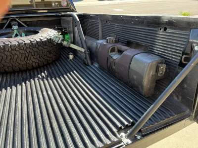

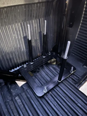

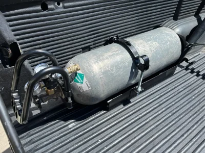

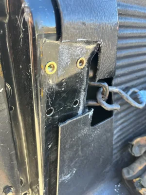

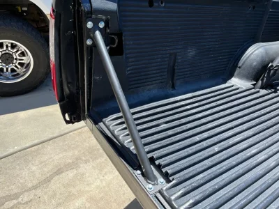

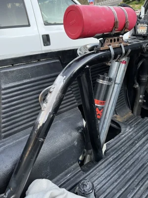

Getting the truck ready for another Death Valley trip this year. Worked on angled bed supports, installed a Co2 tank, pressurized water tank and some panelling on the bed supports. Other maintenance stuff: new front brake pads, upper ball joints, new catalytic converter (smog check: tested gross polluter. Mine was wasted. The can was completely empty. F-ing $1,400 for the cat alone).

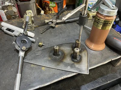

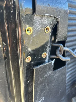

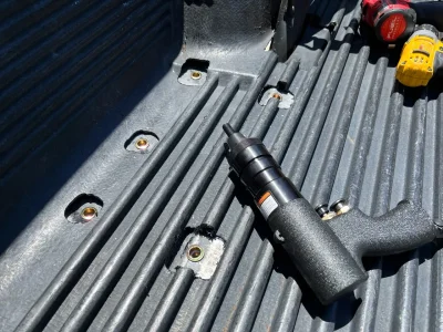

Bought a pneumatic nut insert gun. Pretty cool tool.
Found this empty Co2 tank on CL for $40. Got it filled for like $50. Bought the gauges, handle and mount for $250. Total $350-$400. Power tanks are like ~$900-$1,200.
Mounted pressurized water tank. I've had this tank for like 2-3 years. Never used it. Anytime I've ever taken it with me on a trip it ends up at the bottom of all my gear, so it becomes a hassle to access. I'm hoping to get some use out of it finally.
Panelling installed.
