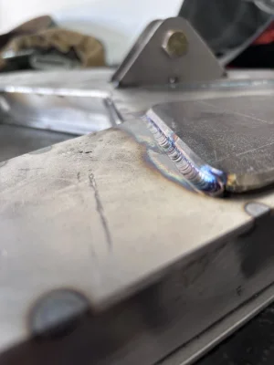

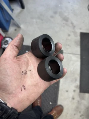

Other than the chamfers looking really clean, is there any other reason you did them? I imagine you will tig weld them so penetration wouldn’t be an issue
I’m am stupid enough to do this much work and still run 33’s, you already knew that though lol

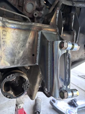

I did the chamfer on them because it’s so thick, and that side will be up. So once it’s welded it will flow better instead of just a sharp edge or a giant weld bead. Only took a couple minutes to do. You’ll see once they get welded on.

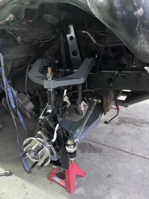

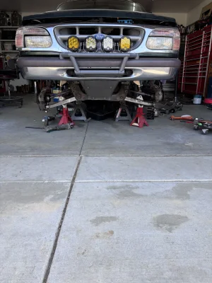

Small update. I got everything mocked up on the driver side, upper, lower, shock mounts, bump stops. Next up is extend axles, limit straps, mount resivors and tie rod then figure out some kind of engine cross member. And then a whole lot of welding!IMG_0734.webpand in regards to my chamfered bump pads once I double pass the weld they will flow nicely. IMG_0729.webp

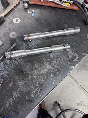

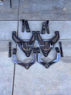

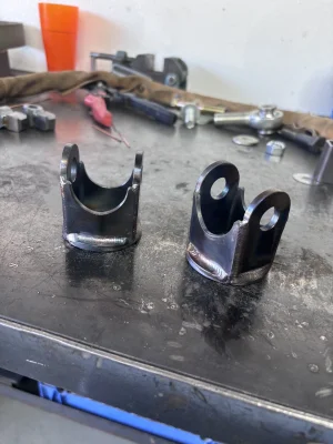

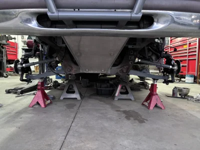

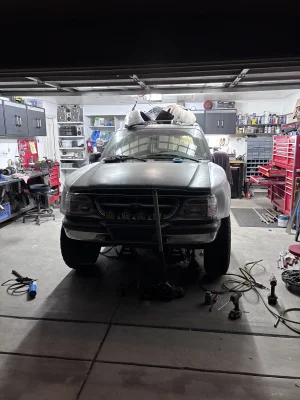

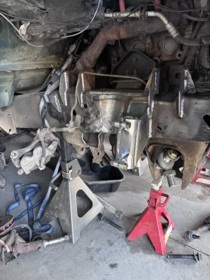

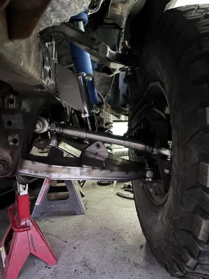

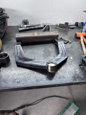

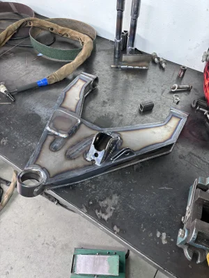

Well finding time to get out to the garage is tuff with a 2 month old but getting as much done as I can. Got the tie rods, upper arms, lower arms, shock mounts and all the frame stuff welded. Still a ways to go but plugging away!IMG_0774.webpIMG_0786.webpIMG_0787.webpIMG_0788.webpIMG_0795.webpalso bought some fiberglass from Hannemann, super cool guy and only two days from order to pick up! Still need to fit them but should work out perfect.IMG_0793.webp
Super clean work! If you don't mind me asking what are you doing for the taper of the lower balljoint. Did you drill that out to 3/4?
Thank you!
Yes I drilled them out for 3/4” bolt however that only took up about half of the tapper, I stated making some very small tapered sleeves to make up the other half of the tapered portion. If I can’t make it work I will drill it over sized and press in a sleeve like I did For the tie rods.

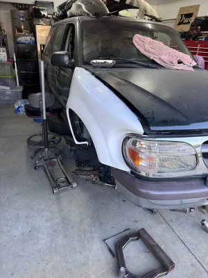

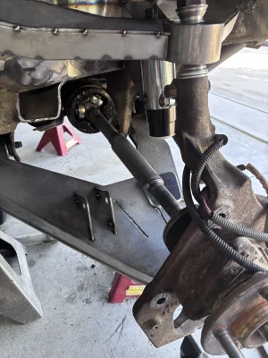

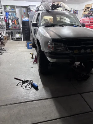

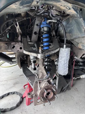

Got a few things done last night, camber was set and so was the toe should be in the ball park but will have to check when the weight is on the tires. Made some steering stops for the rack out of delrin, if I go to aftermarket wheels I’ll be able to get a little more turning radius but it works for now. Also was able to get the fiberglass mounted, really impressed with Hannemann Fiberglass almost no trimming or sanding needed to get the gaps looking good. IMG_0827.webpIMG_0833.webpIMG_0830.webp
If you don’t like the pin you ended up making for the upper arm into the top of the spindle, you can tap the top of the spindle and run a regular bolt. Then tighten the bolt down and mark where the pinch bolt is going with some spray paint, pull the bolt back out and notch the side of the bolt with a grinder and you’ll have a locking bolt that will never back out and you aren’t just relying on the pinch bolt to hold your front end together
