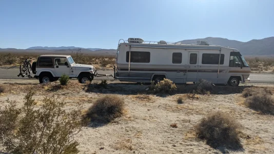

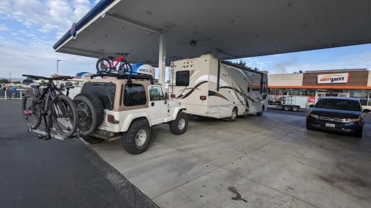

Lets keep the bad ideas flowing. Whatever vehicle I end up with(and it's currently looking like a certain 2012 tacoma), I want to flat tow it in the same manner we currently flat tow our TJ. (you can see why I want a truck)

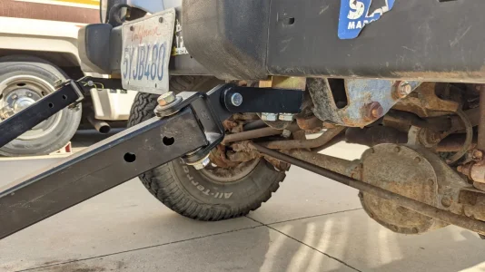

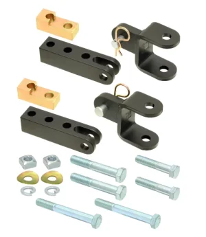

Only problem is- aftermarket tow bars for most trucks hang down waaaaaay to far for my liking. Currie... er I guess Rock Jock now? Makes this trick little setup for jeeps that we're using on my TJ, and it would be cool if I could swap tow bars between the two. These little blocks bolt straight up through the frame rails
I'm considering either somehow welding or drilling/bolting these little jeep specific tabs to the frame horns of whatever I get. Has anyone rigged up anything similar? Pics welcome of whatever you might have. Bonus points if anyone knows of any aftermarket bumpers I could bolt on instead.
