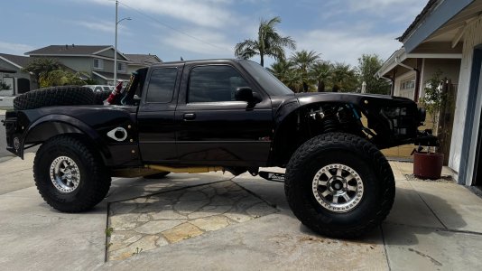

I have decided to go for a new exhaust setup but not sure which route to go? I am thinking now of just keeping the exhaust under the cab and dumping out at the upper link mounts with turndowns.
My headers have 2.5" bolt on flanges on them. My plan was to remove those flanges and install vband clamps at the header collector. Then run 2.5" down to an x pipe, and then to 2 spintech mufflers and then turn them down.
I am still unsure on muffler model. I like the sound of the 6000 series but im worried they will be too loud. Alot of videos i have seen they dont seem terribly loud. I have been considering the sportsman 3000 muffler but worried they will be too quiet lol.
Trying to find the happy medium of having a good deep choppy idle but not overly agressive and obnoxious when cruising.

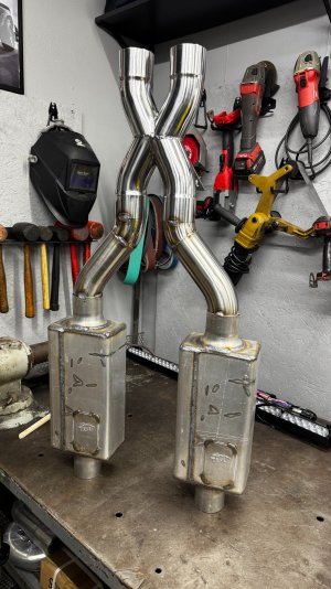

I decided to keep the 3 bolt flanges at the headers, its already welded/setup so minimizes my changes. I hardly ever take them off so its not really a service issue. I am going to run the 2.5" x pipe and 2 mufflers under the truck. Im going to start with putting some 45 degree turn downs on the mufflers they will dump out right at the back of the cab.

Started on the exhaust last night. Probably need to move my fuel pump now as its only about 2" away from the new mufflers. Still have alot of work to do but it should be alot nicer than the old setup. My tig skills are pretty rusty but all of this piping will get covered in header wrap anyways.
Exhaust is finished for now. Dumped it under the fuel cell area. just need to add 2 tabs to secure the mufflers and a heat shield to protect the fuel system.

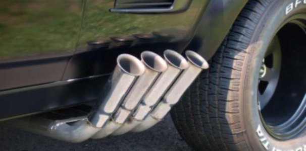

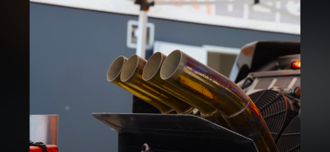

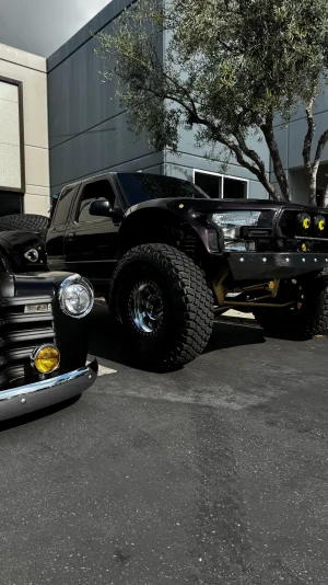

I will plan to revisit this regarding exhaust exit but need to figure out what i want to do. I saw this setup on Loftons TT and think it looks pretty sweet. Would probably do something a bit more subtle though. i had side exit before. I would really like to do something out the top of the backhalf before the spare tires which space wise is kind of my only option.

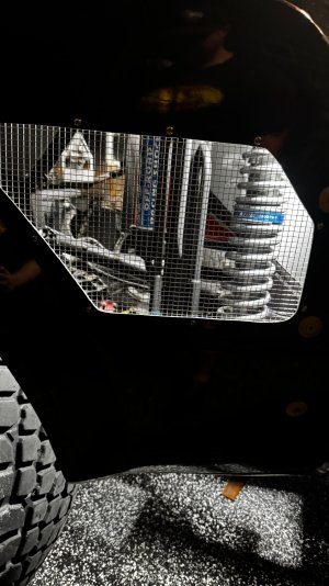

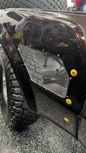

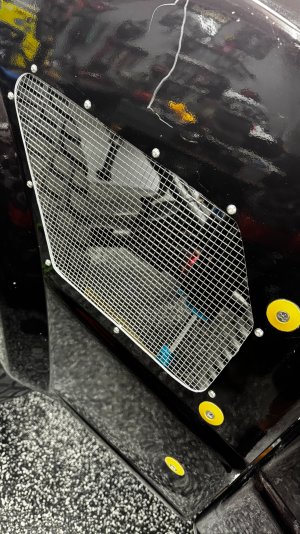

Since i had a huge hole cut in the bedside i did some mesh cutouts with stainless mesh and M4 hardware. Kind of was the only solution aside from buying new bedsides. I did this on both bedsides so they match.

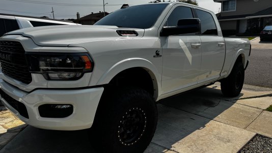

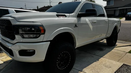

Not a ranger update but I finally got a new tow rig/daily driver. Was set on a newer ford but i was offered a deal on this ram i couldnt pass up. 2022 ram 2500 with the 6.7. Has the carli pintop kit with kings on it and racelines with 37s. Super stoked on it and cant wait to get the ranger behind it and head out for a day trip once it cools down.
Let me know if you want any synergy leveling kits or Fox shocks for that and I'll hook you up. Nice truck for sure
