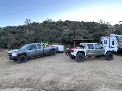

The wife ended up towing the trailer with the 1500 so I could drive the prerunner up. It stayed plenty cool on the highway, but warmed up when in traffic. Got up there without issue, and my wife did great towing for her first time. The trailer worked AWESOME, but I need to figure out why the water heater isn't getting gas and lighting. No issues aside from that. Having a heater and toilet is a game changer lol.

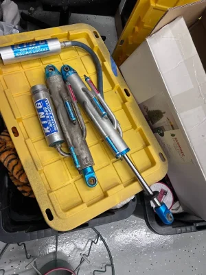

The changes to the rear shocks were so good! I didn't do much cruising around or hit anything huge, but the low speed changes seem to have helped a ton. I'm really excited to see how it does in a real desert. I got to give my niece and nephew rides, and ripped around with my mom, dad, and wife. It was cool getting to use all the seats. The new exhaust has a great sound and is much quieter. Doesn't sound any less aggressive, just less volume. My brother rode in the back and said it wasn't bad at all. Can't wait to throw the new fans in and do a proper coolant bleed with the new vacuum system.

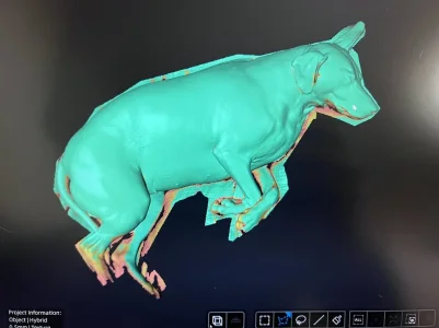

In other news, I grabbed a solid laptop and pulled the trigger on a 3D scanner. I'm excited to get started learning the process and making products.
Decided the first scan would be our fat dalmatian while she was sleeping.

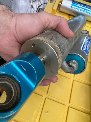

For now, I picked up a single 2.5x10" triple bypass to match the single bypass I got from the swapmeet for $150 a few years ago. Not sure on the history of the swapmeet bypass, but it has a different seal head retainer, which is cool. Gotta pull them both apart and get the valving equal. These will probably be going on the front of the Sonoma to help with bottoming resistance. Going to try mounting it on a bushing to remove the clickity clack.

Im looking forward to see how you mount the front bypass with a poly bushing.
