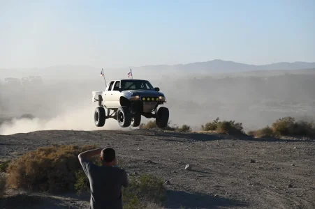

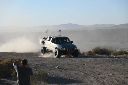

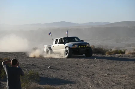

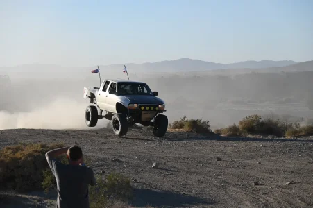

Once everything settled down, mostly everyone was rallied together to do a flag run in honor of Veterans Day. It was just a slow cruise, and I decided to sit it out due to going slow and my cooling issues. Instead, a small group of us went over to the Wash Jump. I got out with my handheld radio to watch my friends jump, and call for when the runway is clear of vehicles and safe to jump. More trucks started to come and participate, including a trophy truck, which was insane to see and hear. He was hauling the mail and sending it. I eventually passed the radio off to a friend and got in my truck to hit it a few times. I was very surprised how well my truck took crossing the bottom, but lining up for the right trail at speed was a challenge, so I didn't leave the takeoff with as much speed as I wanted each time, but a couple of them felt decent

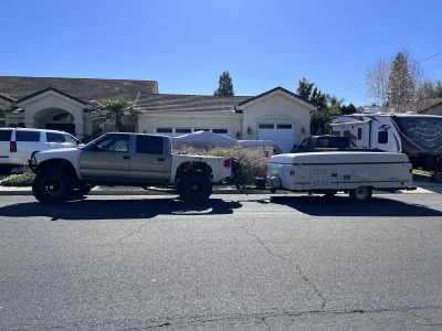

Went back to camp for dinner, hung around the fire, and then knocked out on the lumpy desert floor due to my now fully deflated air mattress. It wasn't as cold as the previous night, but I had a lump under my back so sleeping was rough. After tossing and turning, I decided it's time to finally upgrade my camping game. I got home around 10am, and by 1pm my wife and I were driving away with a new-to-us pop up camper - a 2002 Coleman Santa Fe. We had been looking for a while and trying to decide what route to go in terms of camping upgrades - do we get a cab over for the Silverado? It's only a 1500, so we'd be limited to ultralite models which are expensive and most don't have a bathroom, and I'd need to buy a trailer to haul the prerunner, which is an added expense, spot in the driveway, and would definitely be too much for the 1500 to handle with the camper in the bed. Do we sell the 1500 and get a small class C? I'd still need to get a trailer for towing the prerunner, and that entire setup was largely out of our budget. The small pop up camper can easily be towed by the prerunner, especially with the new drivetrain, or I can tow it with the 1500 if it's not an offroading trip. I'll still add the rooftop tent to the prerunner for point-to-point trips. Overall, we're stoked. We cleaned all the surfaces when we brought it home, and, while it's not perfect, the blemishes it has are not detrimental, and we got it for a great price from a young family who made a ton of memories in it. I'm already planning on extending the tongue to add room for mounting a dirtbike on the front, giving it a bit of a lift and some wider tires.

I was on the radio flagging the jump, your truck looked great hitting it. For a first trip out id say it was a success. I didnt realize it was a ttb, just thought it was beamed.
Hope to see it out in the dirt again soon!
Thanks for taking over! I was flagging initially, but wanted a few turns at it.
Yeah it's TTB, but no front driveshaft yet. I wasn't sure if I wanted to keep the 5.29 gearing in the back, so I'm running it for a bit before I gear the front diff and have a driveshaft made.

My wife came home yesterday and goes “It’s back on jackstands already?!” Lol.

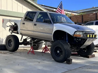

Anyways, pulled the rear shocks to plug a bleed screw and change springs from 16” 350 over 16” 350. Going to 14” 350 over 16” 450. This should be what I need without my roof top tent, but I will probably end up getting a 400# top spring soon. Plugging the bleed should help my low speed a fair bit so I’m not slamming the bumps through rollers. Valving is 15 comp/12 rebound as it came from King. Decided not to mess with the shims at this point to see what effect plugging one screw has, rather than try a bunch of changes at once and not knowing what caused the effect.

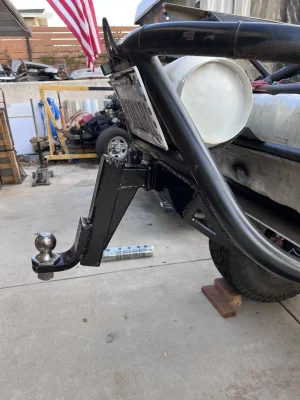

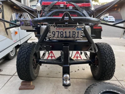

I also added a hitch so I can pull the trailer, added a 7 pin plug, and brake controller.

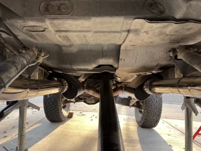

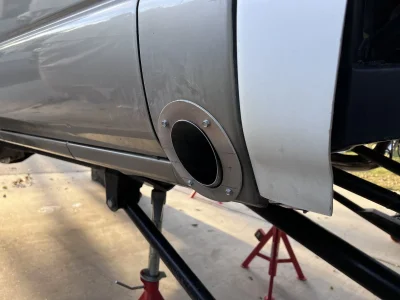

And lastly, I cut out the Borlas I had and replaced them with Flowmaster Delta Flow 50 Series and fixed the tips. I haven’t had a chance to drive it yet to see what difference it made.

Nice!! Where is the triangulation/gusseting/beefing of the upper link mounts on your priority list?
On raptors they run extended bump stop pads. Works just like an airbag. You can jack up the truck and pop it out to put the shorty back in once you disconnect the trailer
It looks worse than it feels.
