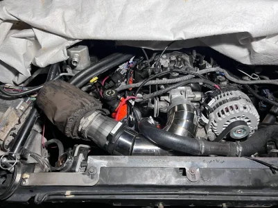

Space is toight like a toiger in there! 4" intake tubing is no joke. I have about 1/4" clearance from the serpentine belt tensioner, and the upper radiator hose is laying on top of it. It's the best I can do, though. Got the hard part tacked up last night. Couple more tacks and I can burn it in.

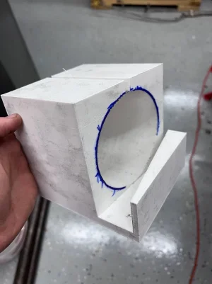

The 3D printed jig I made worked great for marking the cuts. I don't have my horizontal bandsaw at my house, so I hand cut it all and used the disc sander to get it as flat as I could.

yea, 4" intake is bonkers. I remember getting the tube and thinking how the fuck is this gonna fit!!?
mine clears alternator pulley by like 3/16"... and electric fan by like the same. I feel like that is with everything up front though. Stuffing a V8 in mini-truck isn't easy of you want big bypasses, A/C, and all that shit fitting within a 3-piece front end.
