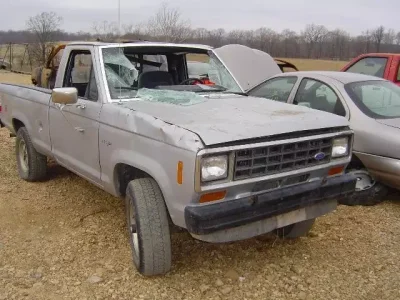

charlie brown 1988 ranger

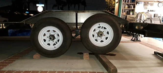

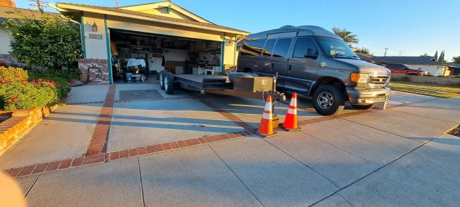

as usual while working on 4 other offroad related projects, i need to start another.

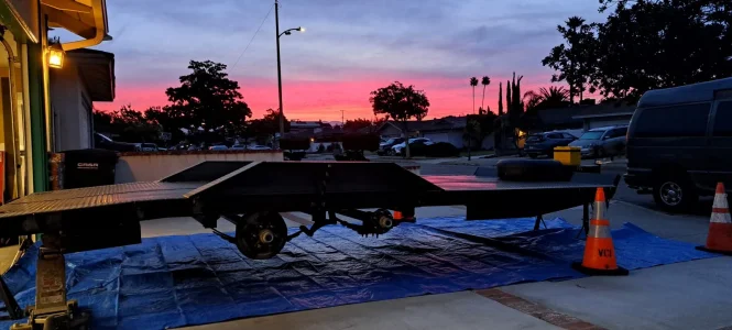

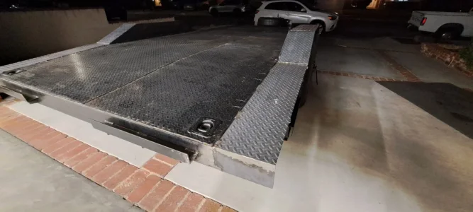

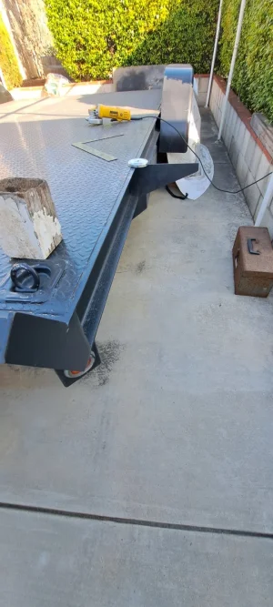

cutting the stock trailer fendees was still to close on the tires when loading up by myself. so started this project. 16 more to cut.
and a truck picture because

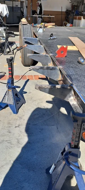

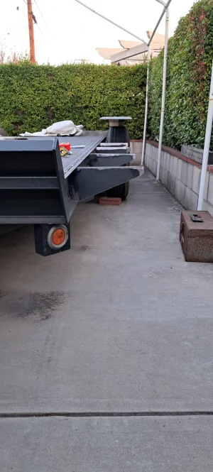

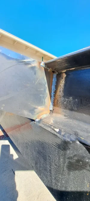

so the holidays are slowing me down some. the trailer project is moving along. got all 16 gusset cut and fitted. sanded for welding.

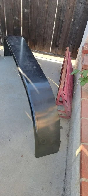

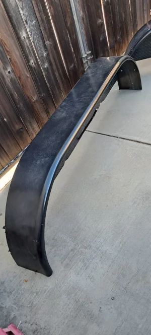

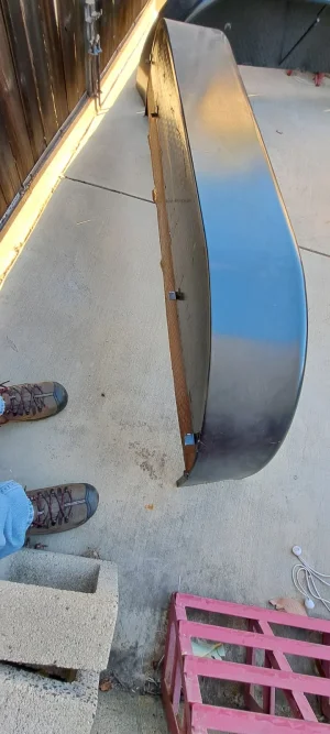

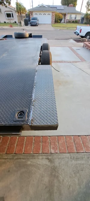

got the old fenders cut off. was careful on cutting them off so i can sell them. if anyone needs them....hit me up. trade??? what you got?.

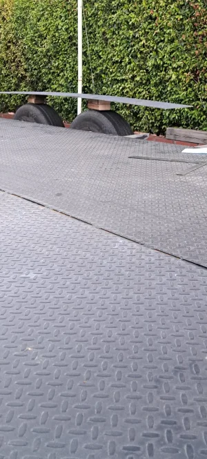

now to start cutting the plate.
question: does anyone know how much travel/room i should give it? the syock set up had about 5". i may cut that down to 3.5" or 4" about the wheels.

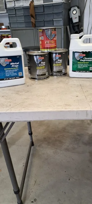

had a buddy silicone bronze weld the sheet metal. used a automotive seem sealer, then sprayed it with the lizard skin ceramic coating. painted everything that could not be poweder coated with the por 15 paint.

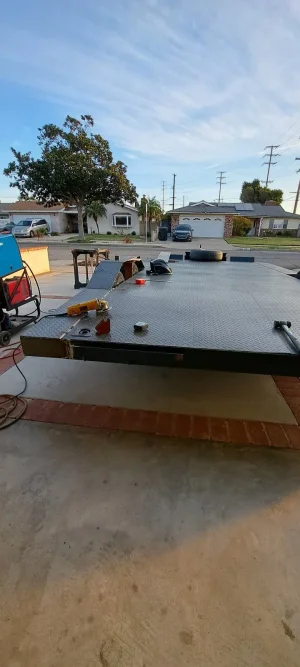

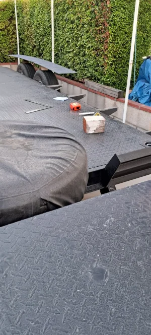

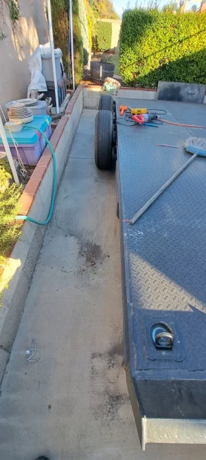

just finishing up my trailer project. waiting on some 2" 4130 strips to wrap around it and the new lights.

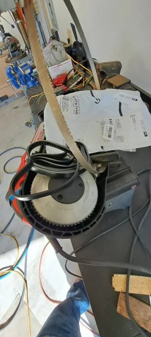

lost the rubber traction deals and a blade on my portaband swag saw cuting all this hot roll stuff. went through a 10 pack of vut off wheels. i dont want to ever use hot roll for anything again.
had to paint it before the rain.
use por15 paint. i used this on my truck and it is the most durable paint out there.
now it is a 101 1/2" wide.
ready for king of the dust.
