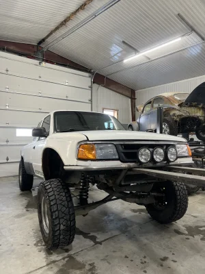

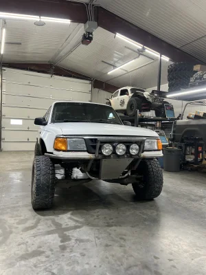

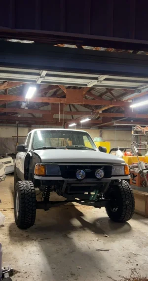

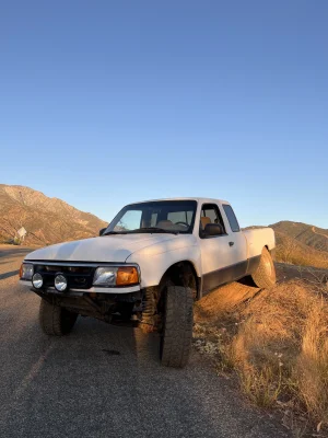

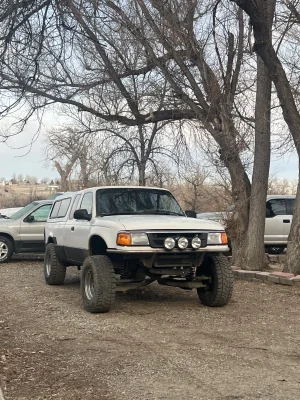

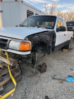

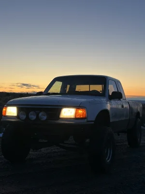

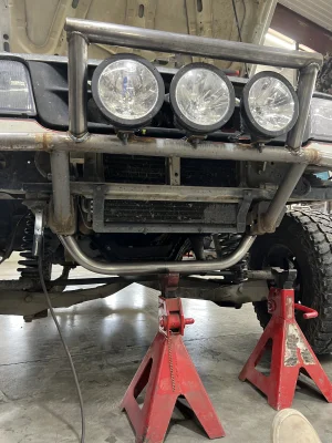

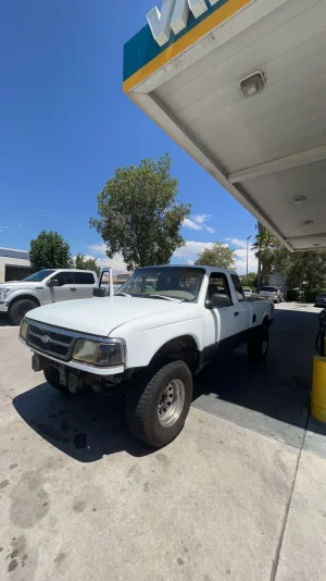

I bought this truck when i was 16 (now 17) always loved prerunner rangers and decided to try building my own. The truck is a 2.3, 4 banger. originally had 31s and a 4inch rough country lift, since buying it i have put 4.5 inch over custom fabricated beams with skyjacker coil springs and bilstein shocks. It was my first time ever doing something like that and i have definitely been learning a lot along the way. I recently put some deaver f31s with a leaf taken out onto the truck. I also just finished building my bumper/skid plate and figured i’d share a post on here! I plan on doing single swingset steering next. Here are some pictures from when i first bought it to now.🤙🏽IMG_5173.jpegIMG_0034.jpegIMG_0356.jpegIMG_0254.jpegIMG_0487.jpegIMG_0878.jpegIMG_1235.jpegIMG_1279.jpegIMG_1291.jpegIMG_1295.jpegIMG_1299.jpeg
