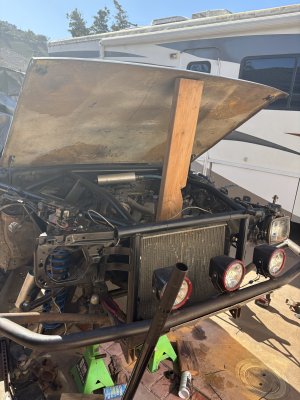

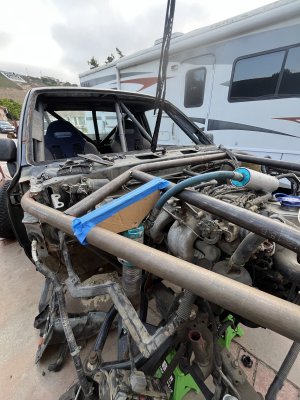

Its engine cage time, I was snapping my core supports damn near every trip so it was time. The shocks towers the truck came with too were about 1.5" different in height and 2 completely different shock angles

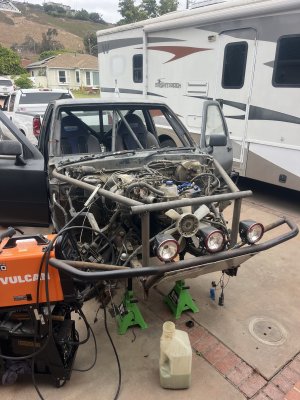

As someone who is learning how to fabricate and weld on this truck this was a terrifying thing to look at

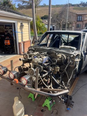

slowly but surely I got tubes tacked in and the ball was rolling
made some cardboard templates for shock mounts and hand cut them with a plasma cutter (they looked like shit)
and here we are present day, cage is in fully welded shock mounts done, primed and painted. Still need to mount PS reservoir, battery, fuse box, coolant tank, and headlights. but I'm just happy ther truck can go back on its own weight. Its not the best or the prettiest but im pretty proud of what I was able to craft up with this engine cage in my driveway. Hopefully she survives in the desert lol.

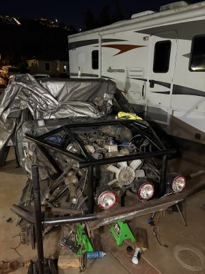

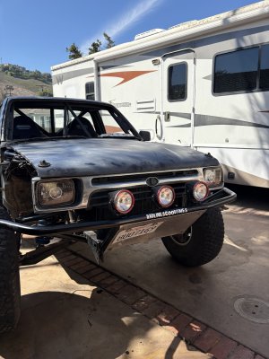

Engine cage is all wrapped up! Took the idea from the mouse and cut the stock headlight bucks out and made some mounts for them. Way easier than trying to make my own buckets. Degreased the whole engine bay (not pictured) and it looks baller, repainted the bumper and got everything all tied together and got the truck started and moving!

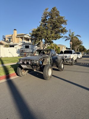

Here she is finally moved out of the driveway (yes I know the grille is upside down I fixed it lol) gonna add some support tubes to the cage so crank that out then I’ll throw a windshield back in it.
One last sticker slap I got from expo and she’s damn near ready for dirt! Gonna do a little weekend trip out to cal city in November so if anyone’s wants to see those clips go follow me on instagram @Wyatt_cato
