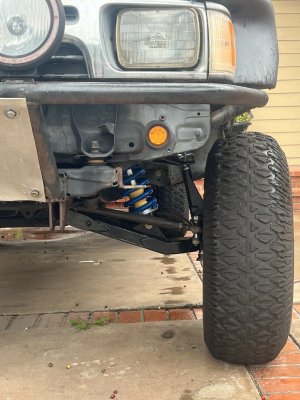

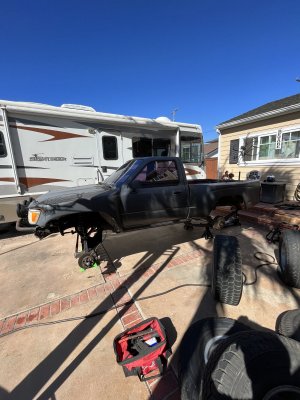

So here’s a progress report and story on that Toyota pickup posted a couple months ago. Bought this 1993 Toyota pickup 2wd manual 5 speed with the 22RE in San Pedro for $3,500, absolutely clapped the fuck out. E5E8F3C1-944D-4E12-A4C1-01DC8793E71C.jpegB535A95E-B01C-4385-9AC0-CC37A56E0C6B.jpeg

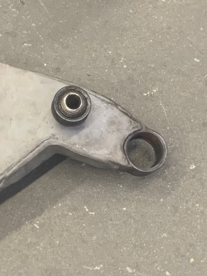

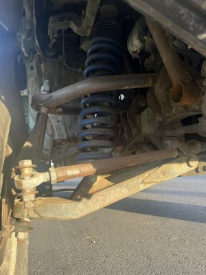

Truck needed all new uniballs, new bolts, new bushings and some new paint on the arms. Driver side LCA uniball was so seized into the arm I damn near had to get a new one as we were stumped nothing was making it budge. Till a friend with a 55 ton press asked to give it a shot.
7B57ABB4-08D7-49D2-8C9D-ABAE5A68EF92.jpeg056169A2-A0ED-4B0B-B92C-ACAF8998935B.jpeg5281AF41-D31B-435E-A2CA-33A4B3D275C9.jpegBDB47C8D-213B-41C5-9C21-70501E8DDC1E.jpeg
Trying to find certain bolts for this truck was no easy task either. For example the spindle bolt came with a stick of all thread that runs about 20 inches long. Trying to find a grade 8 was impossible so went with one of the Kartek upright bolts and it worked perfectly. Drove the truck around the block and front end felt great. Now time to start on the rear.

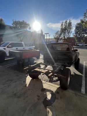

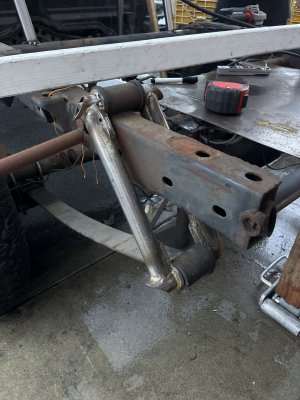

Truck came with what we believe are deavers on giant Motorsport shackles. No rear shocks on the truck. Another weird thing about the truck. One owner in its life decided to cut the existing bedcage out, throw a different bed on and ran the truck with no shocks.

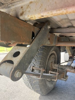

After a little bit closer of an inspection shackles we’re completely racked. They were tweaked and crashing into the frame and we knew we couldn’t run the truck like that.
Made our selves some knockoff TC shackles.
We tacked in our lower shocks mounts and that’s when the snowball hit. Stock gas tank is right where the passenger side shock is going.
Picked up a fuel cell on marketplace for a hundred bucks, my lines, fittings, and a fuel pump.

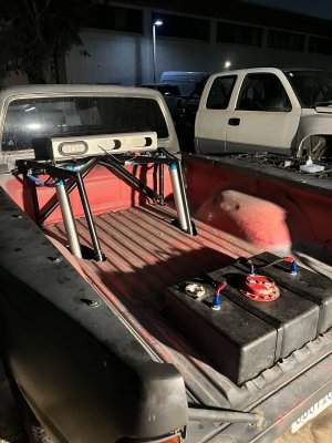

Wrapped up the bedcage and Plumbed the fuel cell, trucks feels amazing. Tomorrow gonna get my new wheels mounted, alignment, and wire up the rear chase bar and the HIDs. Hammers bound!

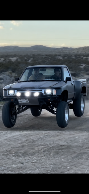

KOH was a blast truck ran great all weekend. Ran out of time to fill the new rear shocks with nitrogen so we ran around all morning out there looking for a camp that had some no dice. So next best thing, fill it up with a bike pump lol. E8A0AA9C-062B-409B-B9D8-3FB613CCA6F9.jpeg19534AFC-6AE0-4E0E-905E-B676083CADCE.jpeg
Front end felt great but rear definitely needs some weight, spares are next and any other additive weight I can think of will be going in hopefully before the MORE race in march. If anyones interested I’ve got a video of the truck hittin a little whoop section on my instagram @Wyatt_cato
Oh ya and smacked on the new wheels #nothelton

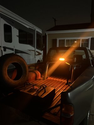

Finished up the chase light today, side lights have live brakes while the ambers runs on a switch 0785391B-5B8B-42B1-AD31-258443B34BE1.jpeg665DE84E-C437-48D5-A9C9-709A095B019F.jpeg

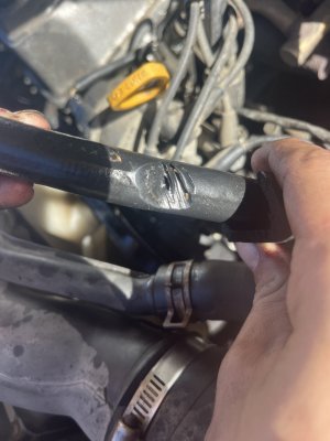

Forgot to throw this in my KOH recap post, the truck ran flawless expect for one issue, the previous owner installed the power steering just completely wrong. One of the things on my list was to fix a couple of the hard lines that were mounted and it just slipped my mind and ran it as is, after a couple runs the line moved, causing a soft line to be touching a pulley and slowly slicing the line until a there was a little pin hole and fluid was everywhere. Cut the line at the hole and shortened it and zip tied it away. Didn’t give us anymore issues. 0DF4DA19-205C-49B9-BFE2-19E27C434FEA.jpeg

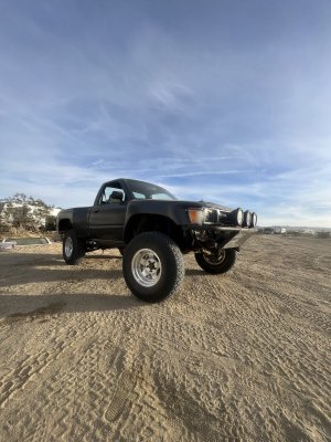

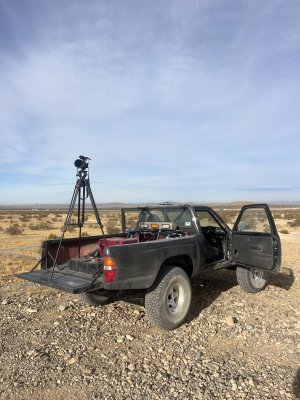

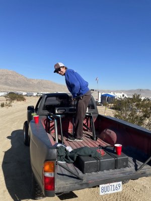

Brought that truck out to the MORE race in Barstow as my media get around, had so much fun finally being able to open up a bit in the truck. Hopefully going to revalve the rear shocks and she’ll be money! 70482B91-E27A-4CF7-BD96-1839454DCF47.png

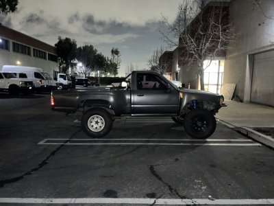

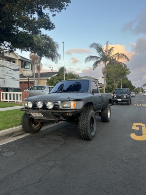

Was finally time for the truck to get some 35s, cole over at ERD offroad hooked it up with this set! 1CB09487-8FAD-4B28-B54F-828A9888815F.jpeg

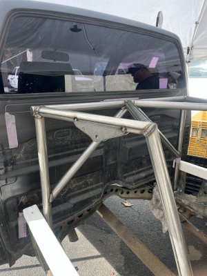

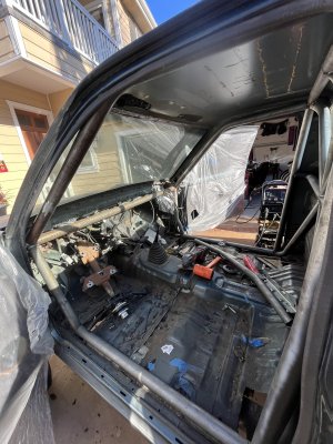

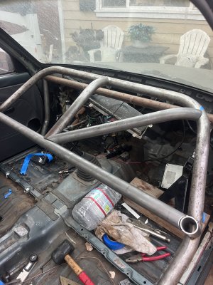

New update I caged the truck!! From a previous post I made I bit the bullet and ordered a dye from JD2. Chopped the cab off and started bending tubes. CA weld and fab helped me and taught me how to use a bender and helped me through the b hoop then let me do the rest in my own. Craig at CA weld and fab is a good friend of mine is an OG MDR racer and used to prep a class 1 car my dad raced on so he’s old school! IMG_8831.jpeg
Also thanks to Cole at ERD offroad for helping me get good pricing on material so I didn’t have to spend an extra 100 bucks per stick at our local metal store. IMG_8881.jpeg
Once I had the b hoop done I knew it was really coming together and my confidence is getting this truck done skyrocketed (prior the truck sat in the driveway for months,gutted with nothing started) IMG_8888.jpeg
Bent the A pillars and got a dash tube in
This photo was taken Wednesday night, all tubes completely welded and ready to start mounting seats, steering, paint, and welding the roof on. We planned to leave Friday night to go chase around the MORE Barstow raceIMG_8959.jpeg
We scabbed the roof on at 4pm, got a windshield mounted at 5, and mounted seats till 8pm then we were off! Truck mobbed through Barstow all day without a hiccup (except for almost catching fire within 20 seconds because I forgot to put a cap on a power cable, it was a stressful week😂) got the rear shocks revalved by Kevin at Dialed shock prep and the truck felt amazing. Shackle bushings and leaf bushing definitely need some love but other than that I’m gonna crank some down tubes and a spare carrier and she’s ready for KOH!
