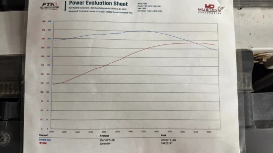

The new motor has been flawless and so has the Sniper2 EFI. I had the truck tuned by a local shop and it picked up a little power and got way smoother.
281TQ
244HP
Dyno numbers are with 4.56 gears and 37” BFG tires.

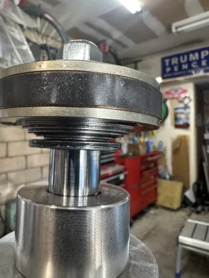

I re valved the rear shocks before KOH and holy smokes the truck finally works decent. More cowbell. More shims. Big shims, so I could finally open up some tubes and let the bump zone do her job. That was an amazing feeling.
Also added some 2.0 air bumps to the front. I had never had any kind of bumps in the front till this year.

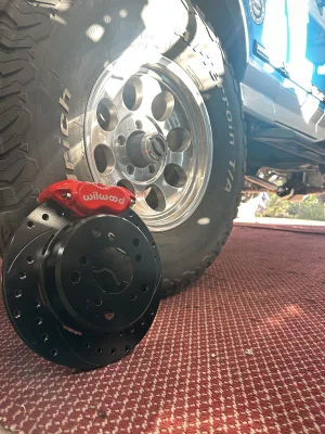

New wilwood brakes in the rear. They still don’t work like they should. I’m blaming it on way too much flex line in the rear. About 15’ total -3 SS braided with the handbrake piping. I need to build it all new in hard lines. IMG_5878.jpeg

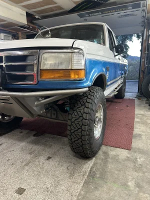

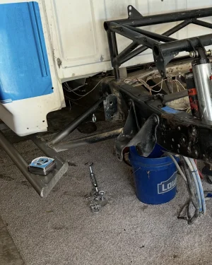

Do you have any pics of your sliders from the bottom?
No, but there is no magic. It’s a ruff stuff kit and I just welded the 1-1/2” outriggers to the frame. Pretty sloppy really, no plating or anything just 1-1:2 straight to the frame. The kicker at the rear has a tiny bit of triangulation to the spring hanger.

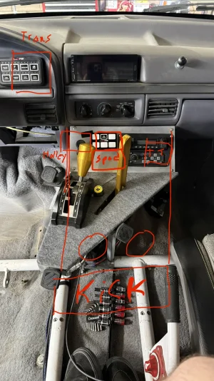

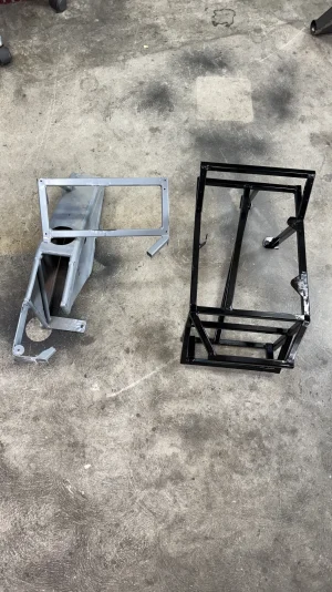

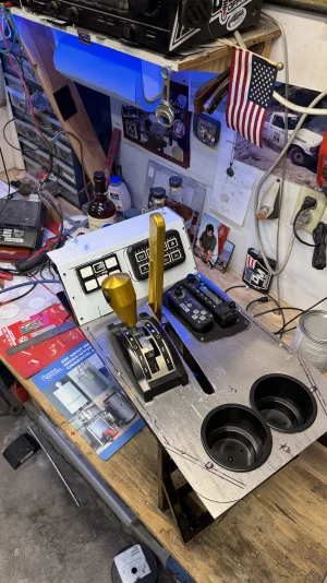

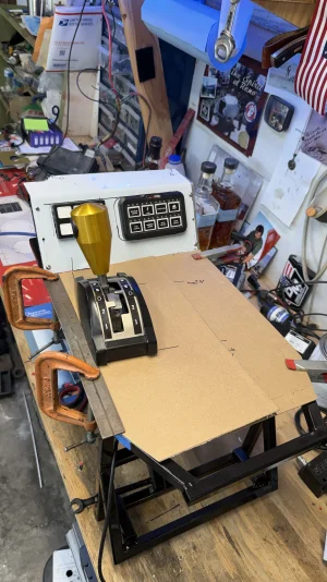

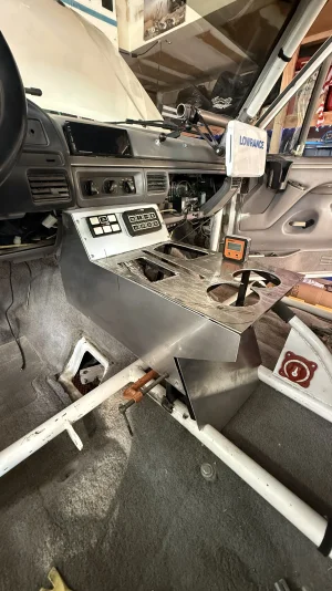

I’m rebuilding the console for the 3 or 4th time. Re plumbing the rear brakes as I go too to eliminate-3 flex line.
