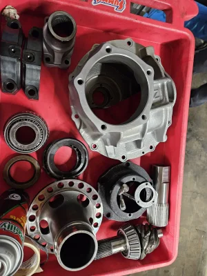

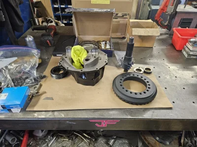

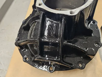

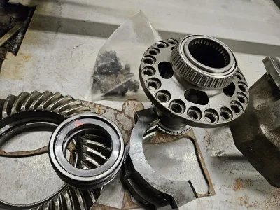

After the race and getting the truck back into the shop I kinda went on a hiatus with the f150 and was focusing on the builds we have going. It was partly due to funds for the race truck not really being there and just needing to take break after the last 4 to 5 month push on the new motor. A few weeks ago I started to pull the 3rd apart and decided to rebuild it myself. I have done them in the past and had Kevin Lawarance build my last one and never had an issues with it. I wanted him to do it again but since he move to AZ I didn't feel like dealing with shipping it. After tearing the 3rd down I took it to my buddies shop and mag checked all the parts and bead blased the case and painted it the next day. All parts got a clean bill of health. We order a set of motive pro 10 inch 543 gears. We were going to switch to 529 but I screwed up in my text and ordered 543 which was in it before and never had an issue, just wanted to try something new. For the next 3 weeks I would try and find bearings with no luck. Called and emailed gearworks multiple time with no avail. Called a few bearing houses who never sent me quotes. Finally reached out to AJ with evenweller who had the parts in stock and got me everything I needed within a few days.
Last Sunday I started assembling everything. I switched the pinion to a true sid space as well. Should have the truck going this week and hoping to go out for a run this Saturday if everything goes to plan as I have to smog the deselect after I change out the throttle body. Gotta love fly by wire.

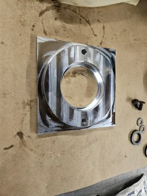

After finishing the preload on the pinion I was getting ready to finish the final assembly and forgot I had to paint the yoke. Also figured I would machine a seal saver cuz why not. Lol. Should finish it up tonight and plant to have the 3rd back in the truck tomorrow if all works out. Excited to drive this beast again!20240228_193044.jpg20240228_193101.jpg

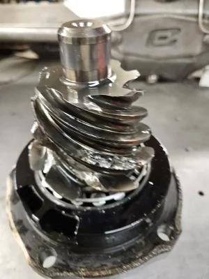

Story time.lol motor was doomed from the get go unfortunately. Ring gap was no correct and pistons were wrong. From inspection after the fact ring gap was more towards NA motor and had 4.6 pistons which are 1/2 inch shorter than 5.4. I also believe we had a fueling issue on the pass side of the motor. UT can be 100% sure as all the pistons and ring were messed up on that bank. I have some fault in the piston side as I ordered them. I would assume as a builder you would check to make sure they were right but we all know what assuming g get you. Lol
