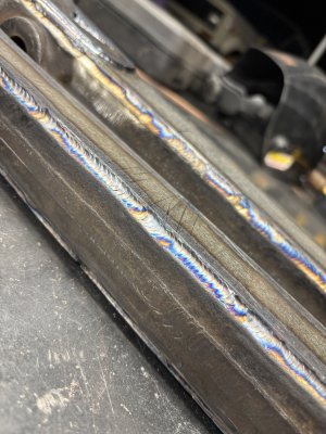

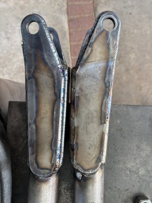

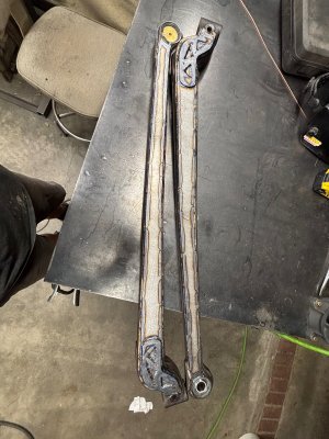

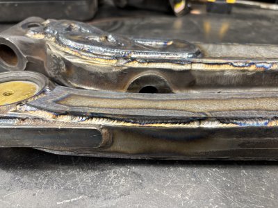

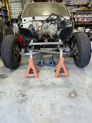

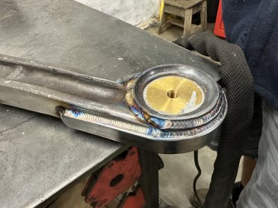

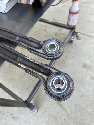

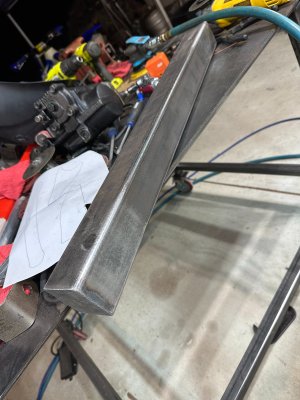

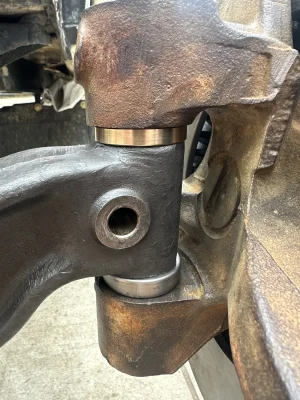

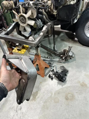

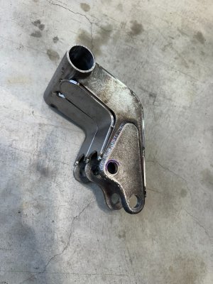

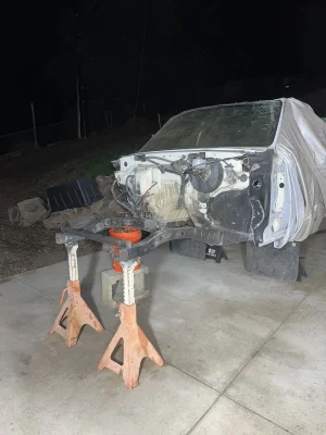

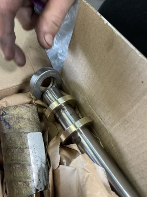

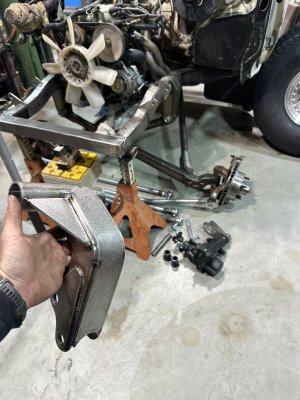

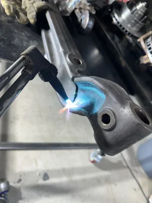

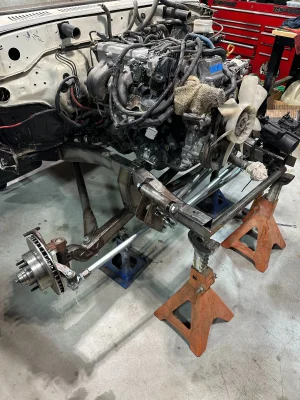

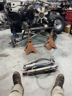

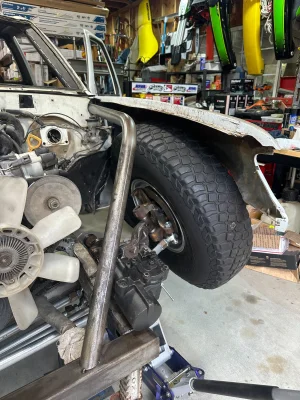

Slowly been chipping away on the king pins. Got beams cut and turned and had Jesse and Mikey at the @the_fablab_ machine these sweet bronze bushings for my spindles
Slowly been chipping away on the king pins. Got beams cut and turned and had Jesse and Mikey at the @the_fablab_ machine these sweet bronze bushings for my spindles View attachment 37897
Very cool! Everything‘s looking good. When I cut the beam to get more right height out of the kingpin beams, I would cut them inside of the radius arm mounting hole to straighten out the discrepancy of the beam shape but outside works just make sure you keep a 1/2-3/8 gap so you can fill it from the center out doing multiple passes so you have full penetration from the center all the way out and not just weld it on the outside or it will break off.
