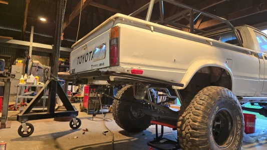

20250112_152215.jpg82 longbed pickup

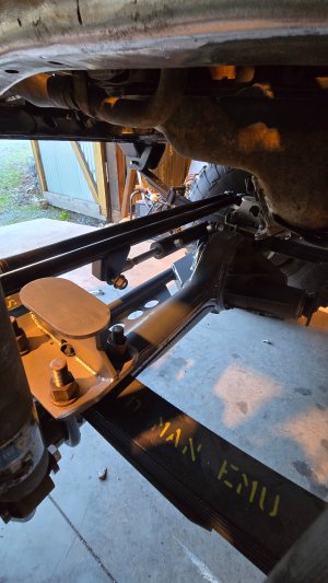

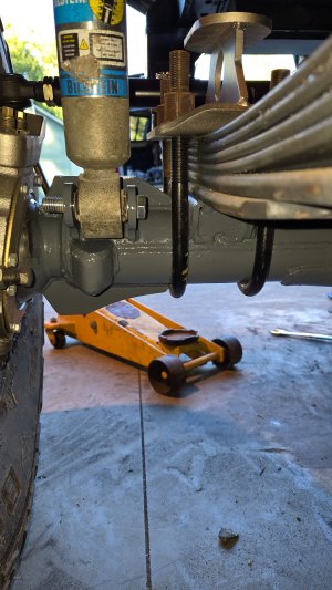

suspension

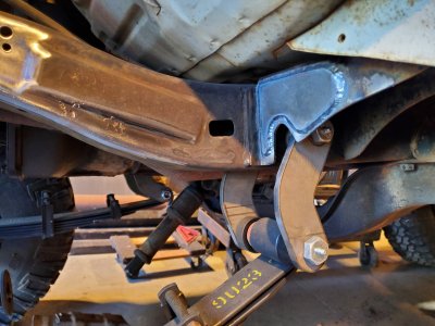

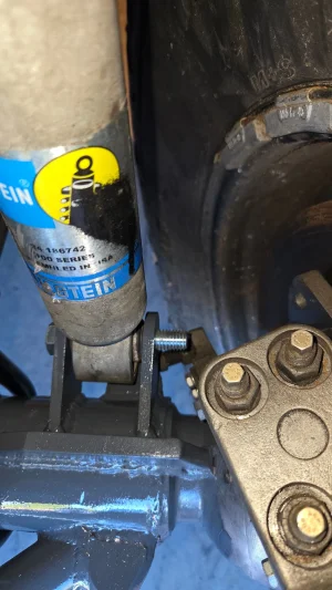

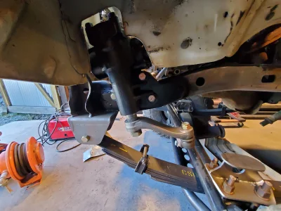

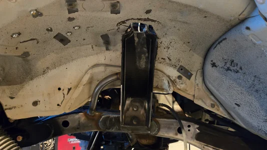

- oldman emu toyota pickup rear springs up front
-sky's offroad ultra clearance hanger
-ford f150 rear leaf springs

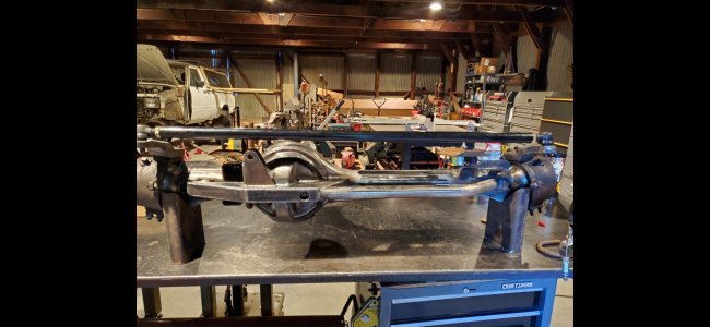

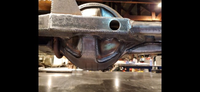

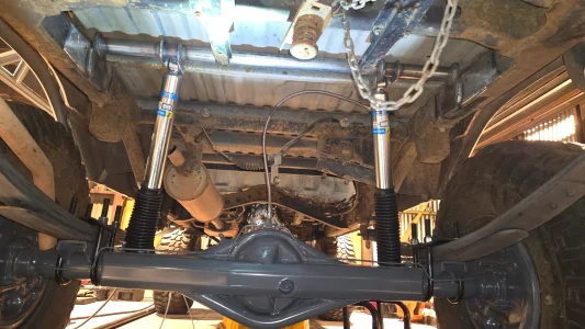

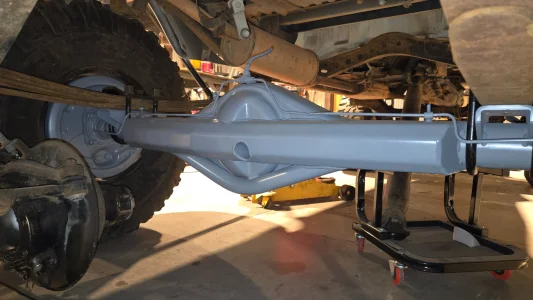

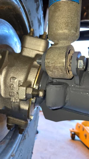

axles

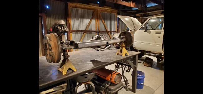

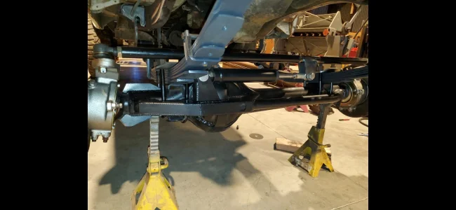

-front trussed and gusseted toyota housing
-ram assist centered between springs
-90s v6 4runner rear housing back trussed using modfied ruffstuff truss

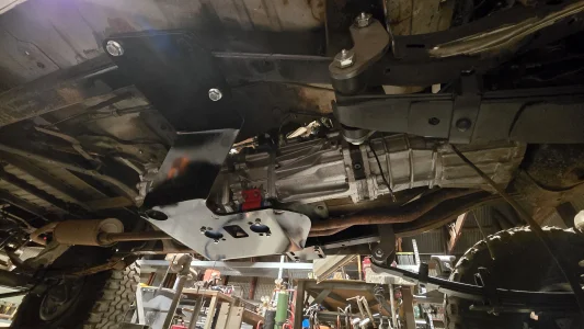

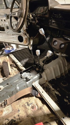

drivetrain
-22r
-w56
-dual case.

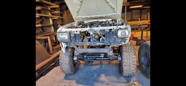

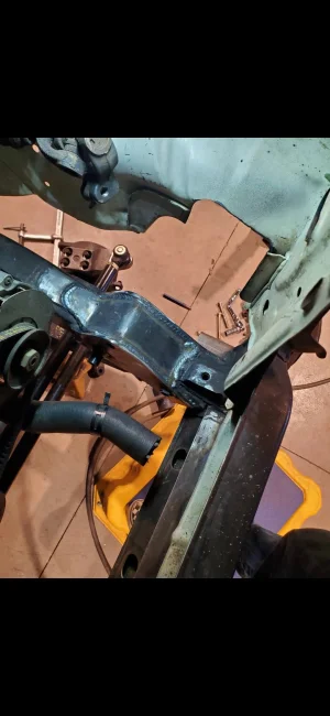

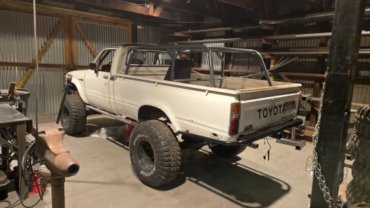

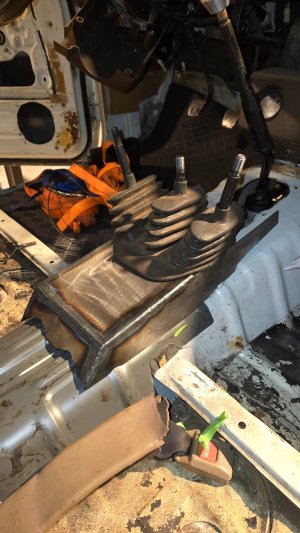

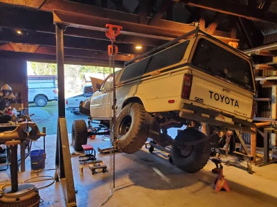

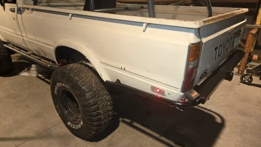

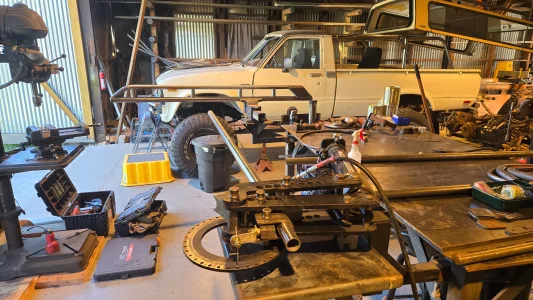

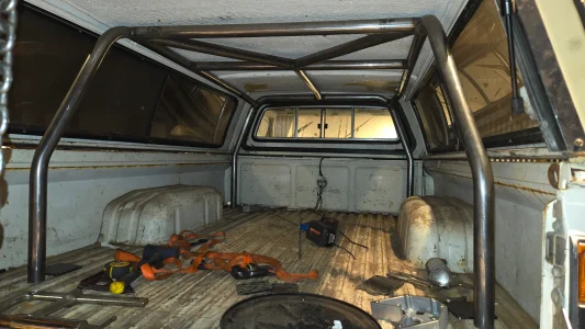

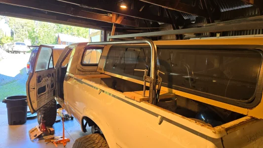

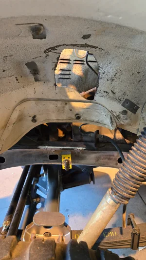

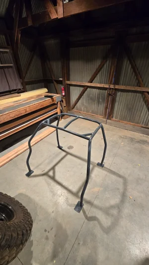

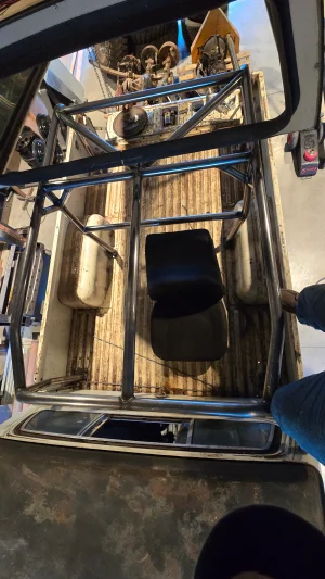

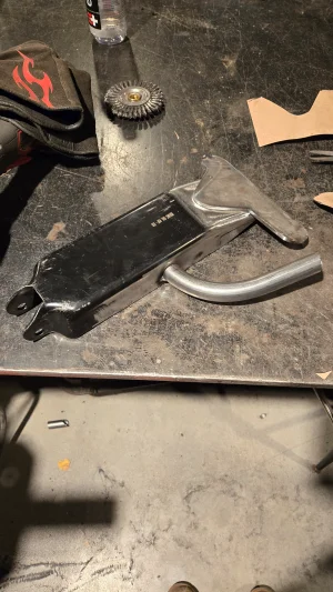

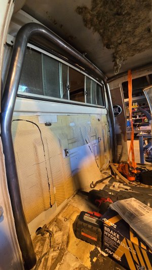

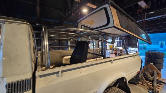

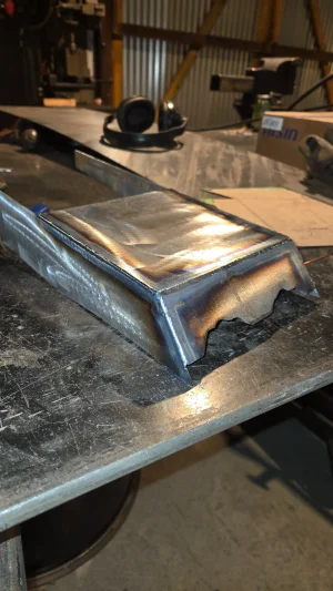

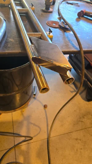

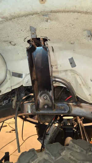

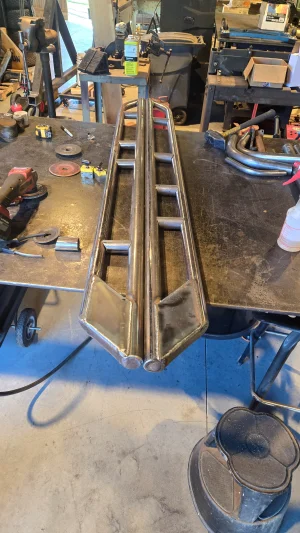

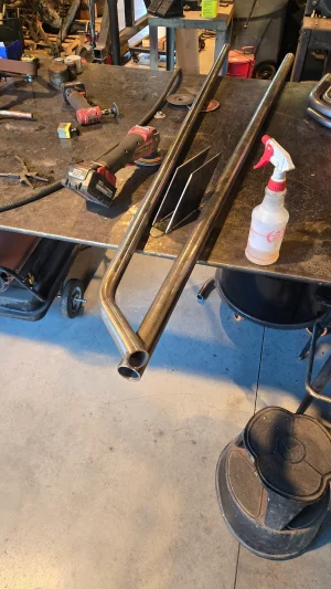

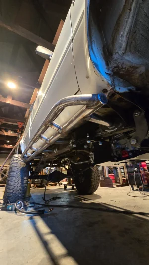

Ultimately the plan here is to put together a classic, clean simple toyota, set up to drive to the trail and drive home, mostly frequenting the Rubicon. I am committed to cutting the back of the cab and front of the bed and mating them together. Starting with building a pan and cutting out a section of the bed floor behind the driver seat, low enough to match the cab floor height. I will only be adding one seat on the driver side, hoping this can keep me in the clear from moving the fuel tank. I am also planning on integrating a first gen 4runner roll cage from 4x innovations. a removable gemtop camper shell will also be cut to match the pass through and set up to be removable. Suggestions, criticism, ideas ect. welcomed i will try to keep upated as much as possible.
