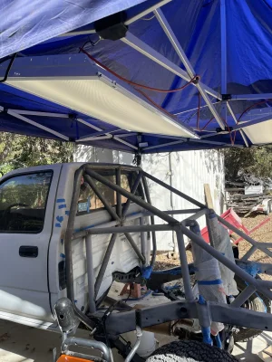

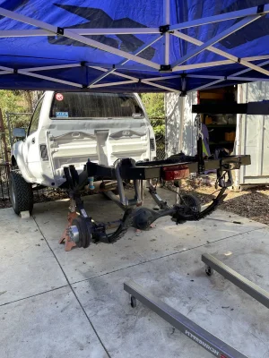

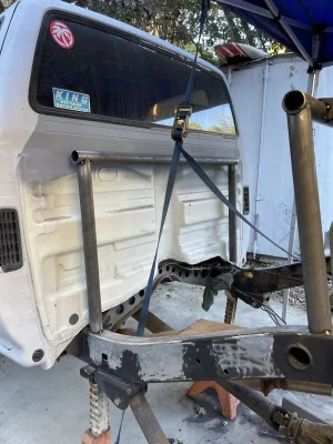

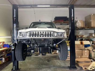

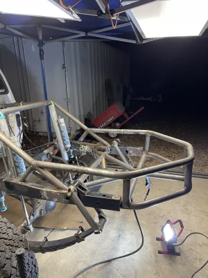

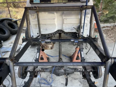

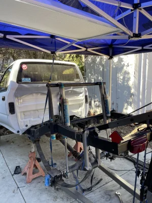

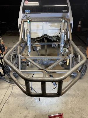

Plan:

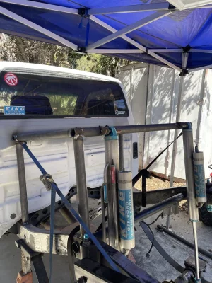

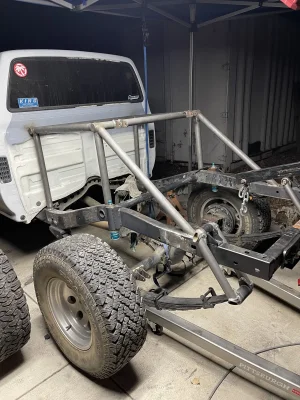

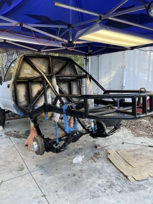

-build bed cage to fit the 18in triple tube bypasses that came with the truck
-2 spare tires in the back
-some sort of roll bar or roll cage

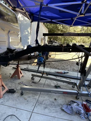

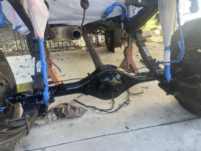

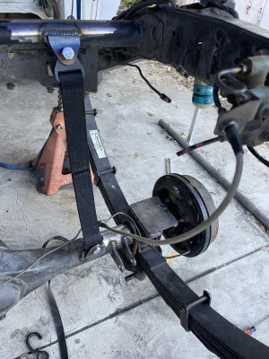

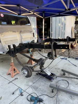

Took the leaf pack apart

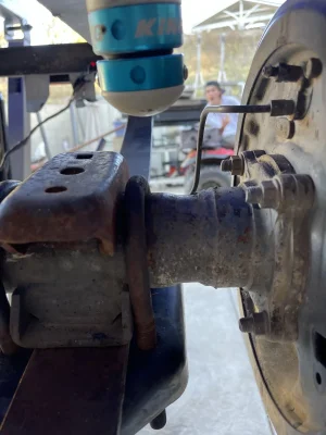

Whoever originally installed the bump stops decided it was a good idea to have it bump off of the u bolt lol.

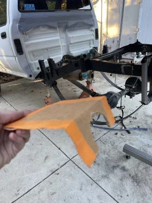

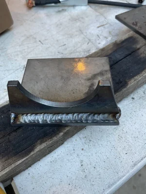

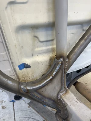

Cardboard template for bump plate

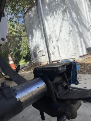

Thanks to Mike at fablab for cutting the plates out, First time welding and I'm stoked with the results
Bump plates are installed and welded to the axle

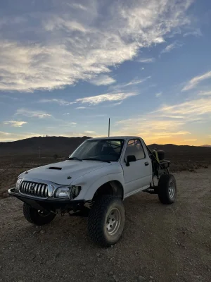

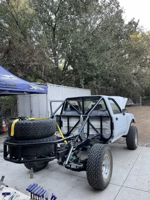

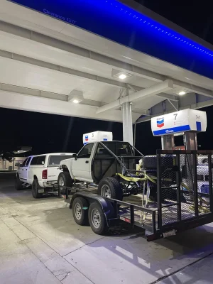

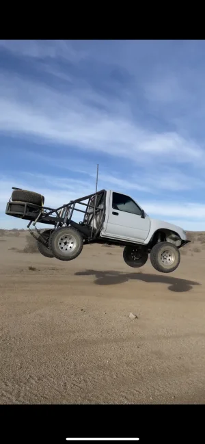

First trip out was definitely a success!

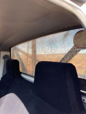

The rear window decided to shatter from a rock getting thrown in the rear window
Few pictures of the truck over the weekend
The truck worked great and I'm beyond stoked with how it came out!
Next:
-The rear end is way too stiff and shocks need to be revalved and rebuilt.
-Need a new rear window, thinking lexan
-Bedsides need to be mounted and tail lights wired up/mounted
-Front lightbar
View attachment 4504View attachment 4505
