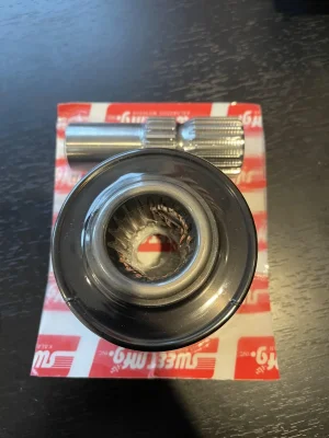

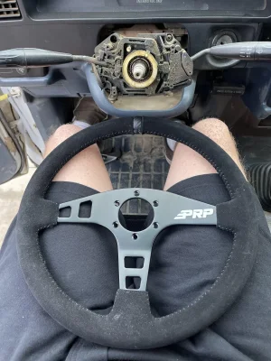

Im running a sweet mfg QR in my 4runner. Ended up "making" the adapter to mount it to the stock steering column without having to weld it on. IIRC we used a short piece of tube welded to the splined piece, then turned down on the lathe for bling factor. Bolted it to the stock steering shaft using a honda/ricer lugnut that was also turned down so it would fit INSIDE the spline piece/tube.New steering wheel for the Toyota!

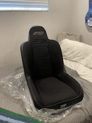

Doe anyone know what quick release system I need? I'd prefer one to weld to the steering column. Also looking for bucket seats so if anyone has any recommendations for what to get or has some for same lmk! Slowly piecing parts together to get ready for the cab cage!
Does that work on the early Pickups? I guess I've never tried to swap a Tacoma wheel on but this would make it real easy
I do not have an answer. Sorry.Does that work on the early Pickups? I guess I've never tried to swap a Tacoma wheel on but this would make it real easy
I think I'm going to buy the sweet mfg weld on spline quick release. Solo adaptor is overpriced imo.Does that work on the early Pickups? I guess I've never tried to swap a Tacoma wheel on but this would make it real easy
I know that we're all working with some type of budget but $150 for sometime that bolts on is a super fair price. They did the engineering and took all of the guess work out of it.I think I'm going to buy the sweet mfg weld on spline quick release. Solo adaptor is overpriced imo.
I ended up getting the one you weld to your steering shaft to save some money and I'm unsure if the solo adaptor works on the old pickups. I will take my time and make sure my steering wheel is not crooked lol. I also have some prp seats on the way that I'm super excited about!I know that we're all working with some type of budget but $150 for sometime that bolts on is a super fair price. They did the engineering and took all of the guess work out of it.
Basically comes out to what is your time worth. I've seen a bunch of crooked steering wheels out there from guys who welded them on![]()
